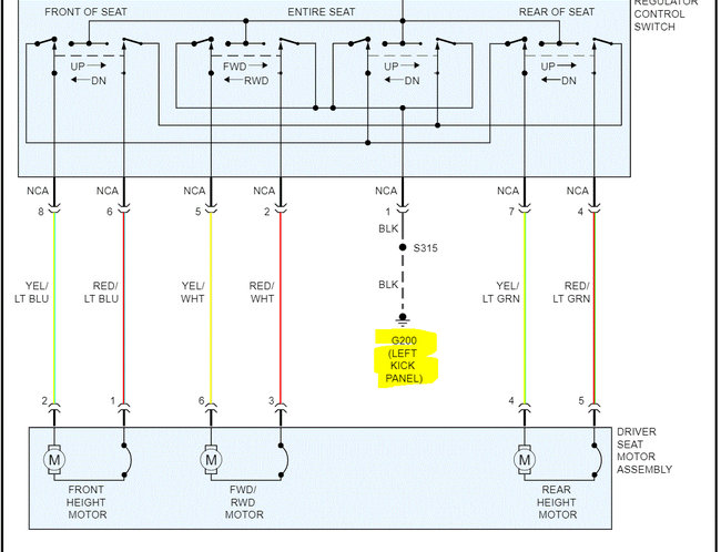

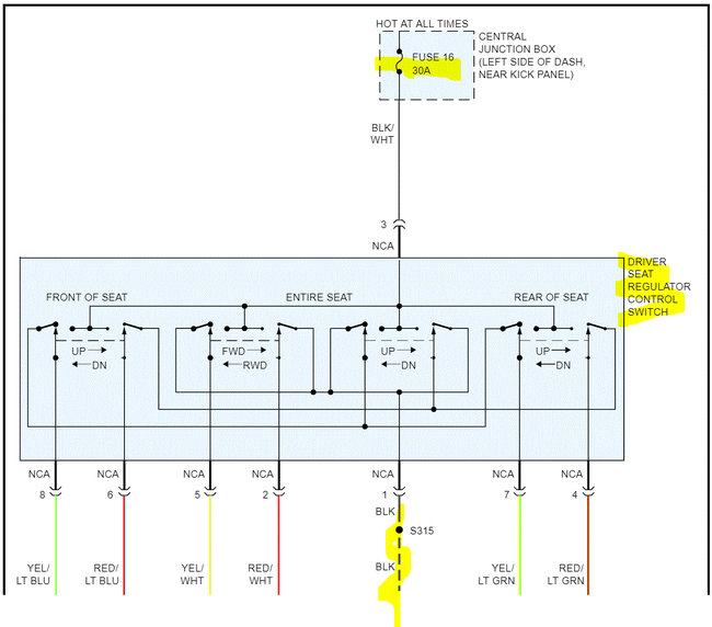

I have the E150 cargo van listed above. Very much a base model. I got seats out of another 1999 E150, but the driver seat is a power seat. I need a wiring diagram to be able to get the seat working to be able to adjust it!
Nov 9, 2021 at 10:23 PM
  • 110,240 POSTS

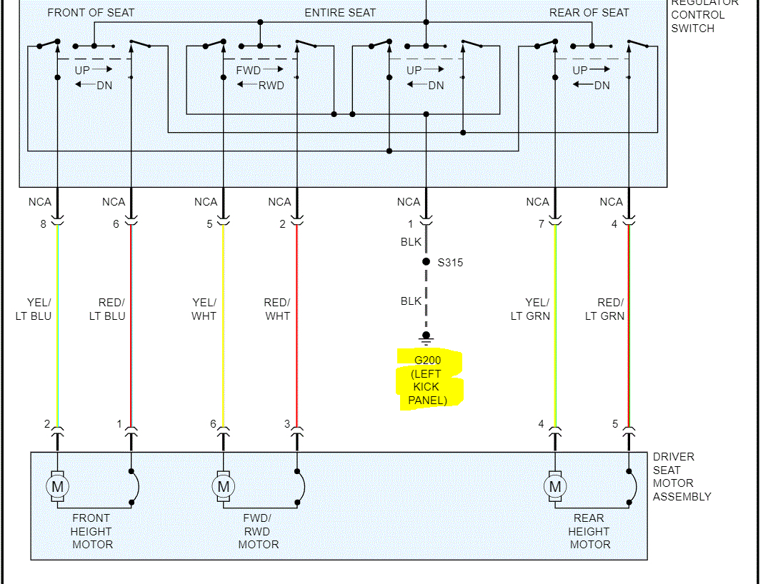

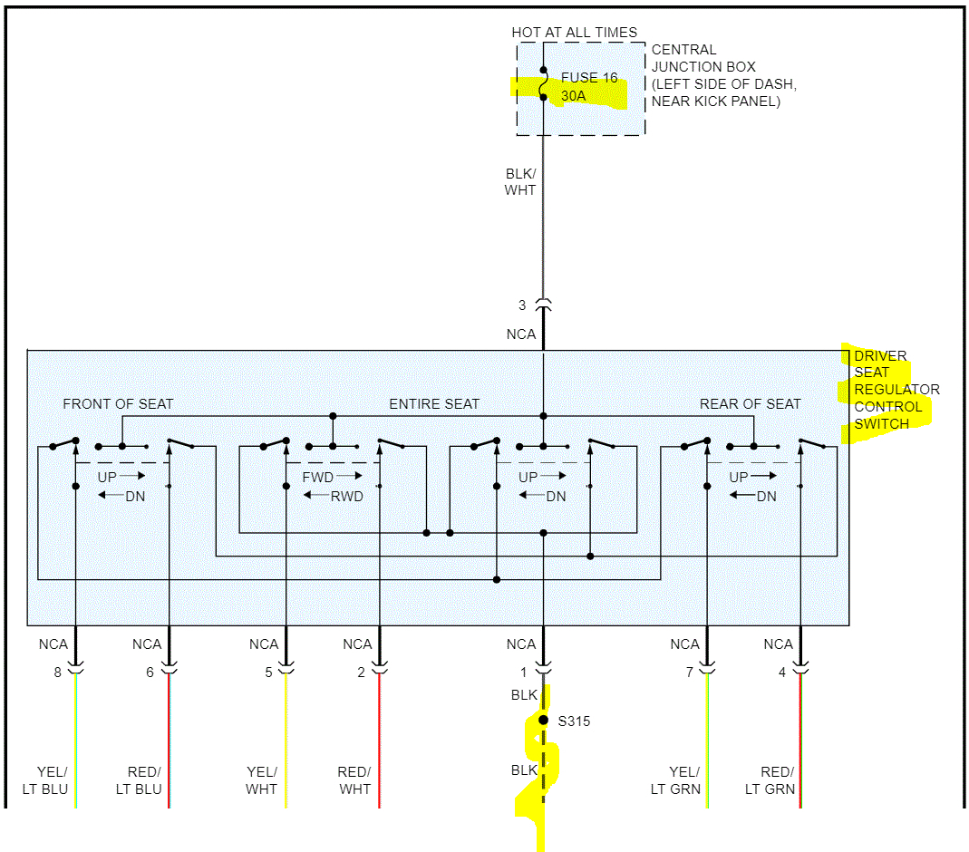

According to the schematics, there is a 30amp fuse that simply supplies power to the switch assembly. There is a ground that will need to be attached as well.
I attached the schematic below. Note: The schematic was only a page long. However, I had to cut it in half to make it readable. I did overlap them so you can follow from one to the next.
If you decided to get power from a different source, don't exceed 30 amps.
Let me know if this helps or if you have other questions. I did highlight the ground and power supply.
See pic below.
