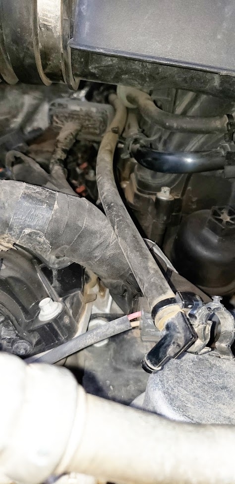

Found a vacuum line not connected, can't find a place to where it goes. It is routed from the back of the engine. Number on that line is 0462785 AA.
Truck listed above is a V6 Tradesman.

If you can follow that back, you should see it's a vent hose for the transmission.

Was this vent line ever connected somewhere? Or is it just dangled to another line?

Other people have had the same question, so I assume it was never connected to anything. I have a 2014 with the 5.7L engine and 8-speed transmission. If I can fit under it, I'll try to look for that hose. Also have a friend with a body shop who specializes in rebuilding smashed one and two-year-old Dodge trucks. He's in the hospital today for surgery, but in a few days I should be able to ask him. He knows these trucks inside out.
