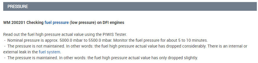

I've attached a picture below with the fuel pressure specification. You should verify this first. Does your Foxwell have the same capabilities as the PIWIS tester? Let us know and we'll go from there. I've attached the specification below. Hope this helps and thanks for using 2CarPros.

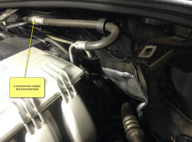

Your vehicle has 2 fuel systems, a pre-supply system from 2 in tank fuel pumps which will supply a low pressure of around 5-5.5 bar. These are the values my colleague gave earlier.
The high pressure part of the fuel system is regulated by the high pressure fuel pump mounted at the right rear of the cylinder head. For the DFI system the fuel pressure ranges from around 40 bar at idle to around 120 bar under full load.
I would suggest to start by checking the actual supply pressure from the in tank fuel pumps. Connect a manual fuel gauge to the supply line and start the engine. Check that the pressure is at around 5-5.5 bar or 50-55 PSI. Please see attached picture below for the supply line location.
