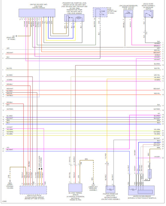

i need to find the fuel pump relay - which fuse box and which relay?

Here is the information you requested. It looks like the fuel pump control module is on the fuel delivery unit which is located on the top right hand side of the fuel tank.

Alex, Thanks for the quick response. I made more progress with 2CarPros in five minutes than I did from days reaching out to VW. I want to be able to disable my car when I long-term park. So I want to either unplug the fuel pump relay or fuse from the appropriate fuse box, or put a cut off switch on the accident inertia switch. So I need to find either the fuel pump relay/fuse, or find the inertia switch. Most fuel injected cars with electric fuel pumps have an inertia switch. It looks as if you have access to a 2014 3.6L Passat repair manual....this info should be in there. Thanks again.

Hi again Georgiec, and thank you for the vote of confidence and allowing 2CarPros to help you with your problem. It looks like if you pull fuse 1(7.5A) from fuse panel c, at the left end of the dash, it should disable the system. I am including a couple of helpful links also to help make doing this as painless as possible. Thanks again, Alex. https://www.2carpros.com/articles/how-a-car-fuse-works
