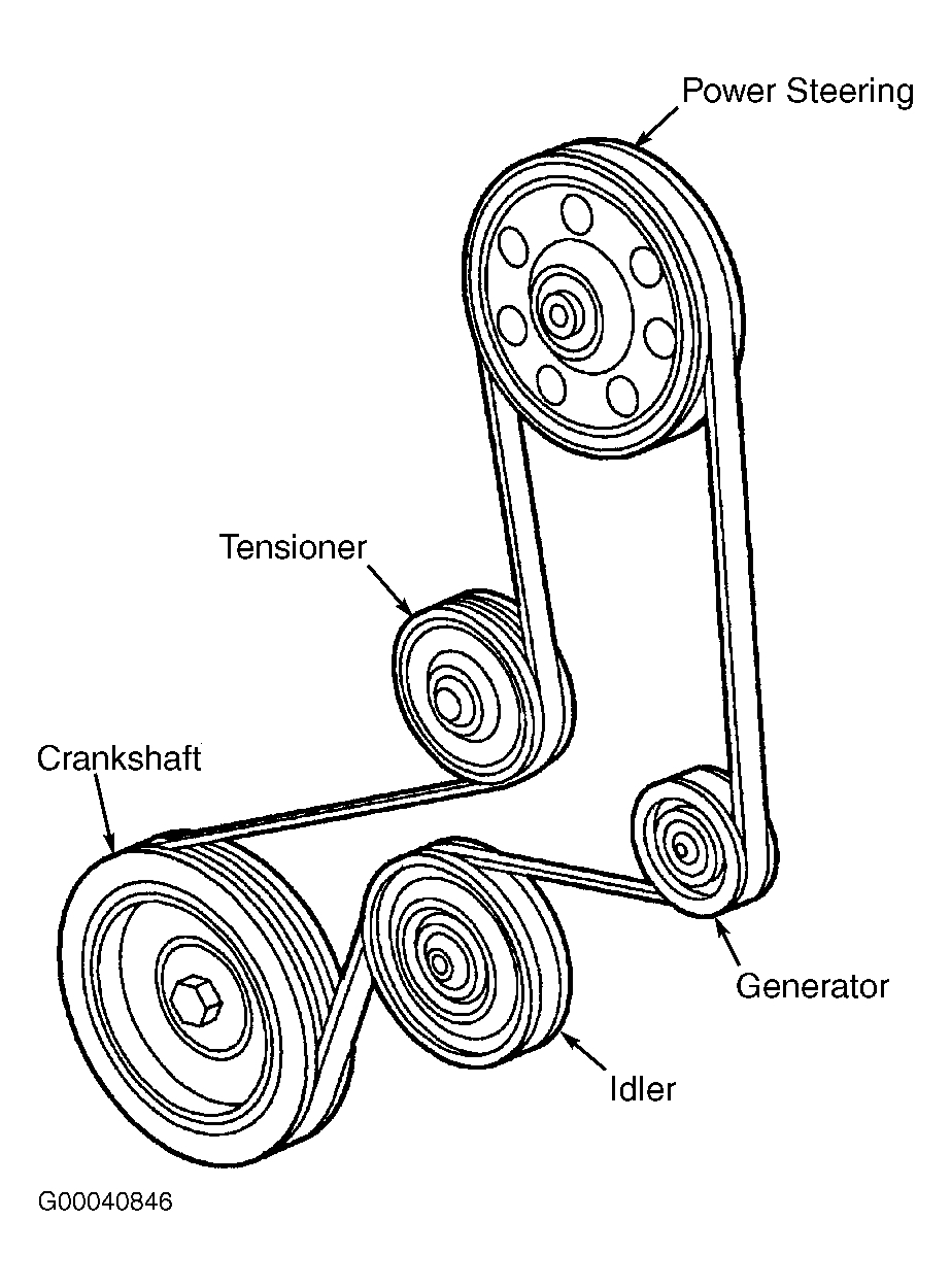

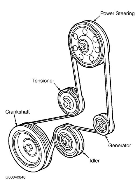

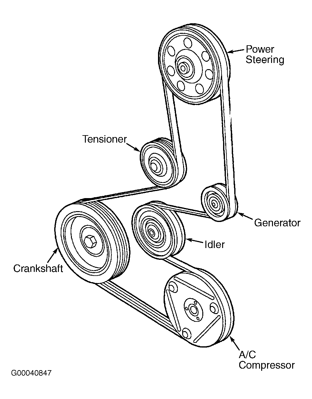

I need a diagram of the alternator belt and how it goes on. my eight VIN number is a P.
Apr 10, 2017 at 5:37 PM
STEVE W.
Experienced Mechanic
15,419 POSTS
These should be the ones. One is with AC the other without.
