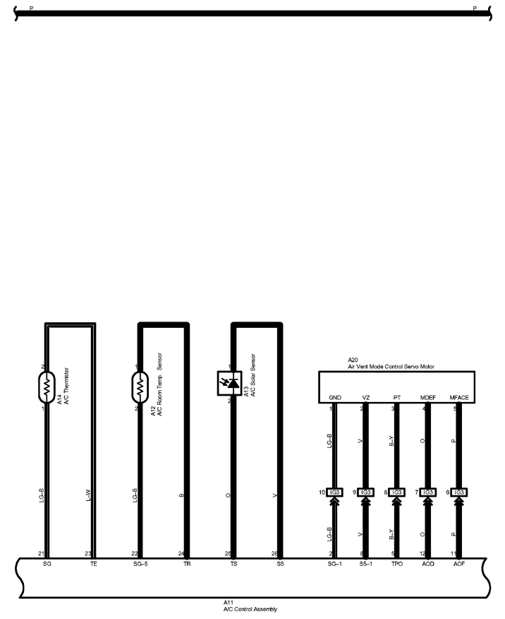

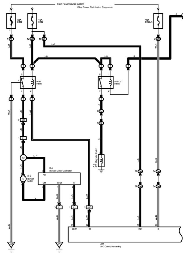

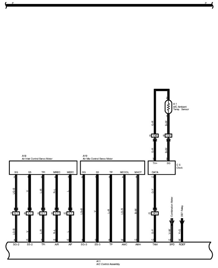

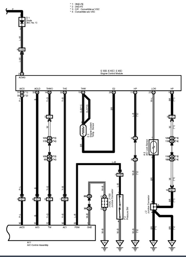

My brother recently bought a 2005 Toyota Noah (not in the list of vehicles in the drop-down list of 2CarPros) with a 1AZ-FSE engine. The vehicle has no A/C. On inspection, the previous owner had A/C amplifier and connector pulled out.
We now have the amplifier and want to rewire it again but are stuck at the wiring. Where can I get the A/C system wiring diagram?

Hi and welcome to 2CarPros. Lets see if we can help you out here.
I don't have a listing for that specific car, but here are the wiring diagrams for the Auto AC system for that year Toyota. Let me know if these help.
Rich.
