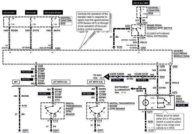

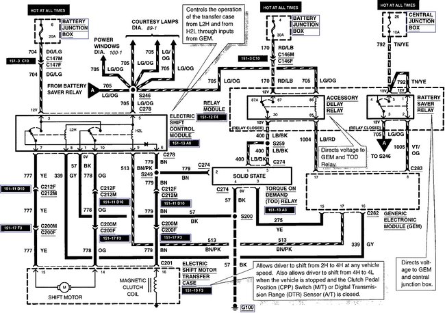

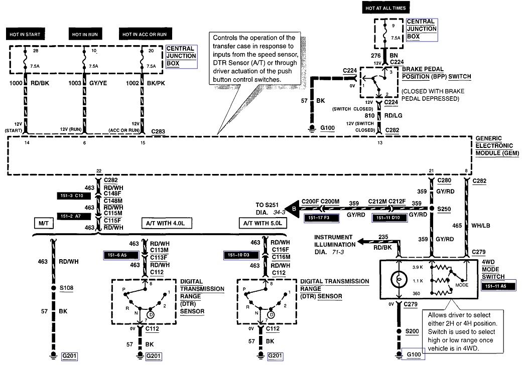

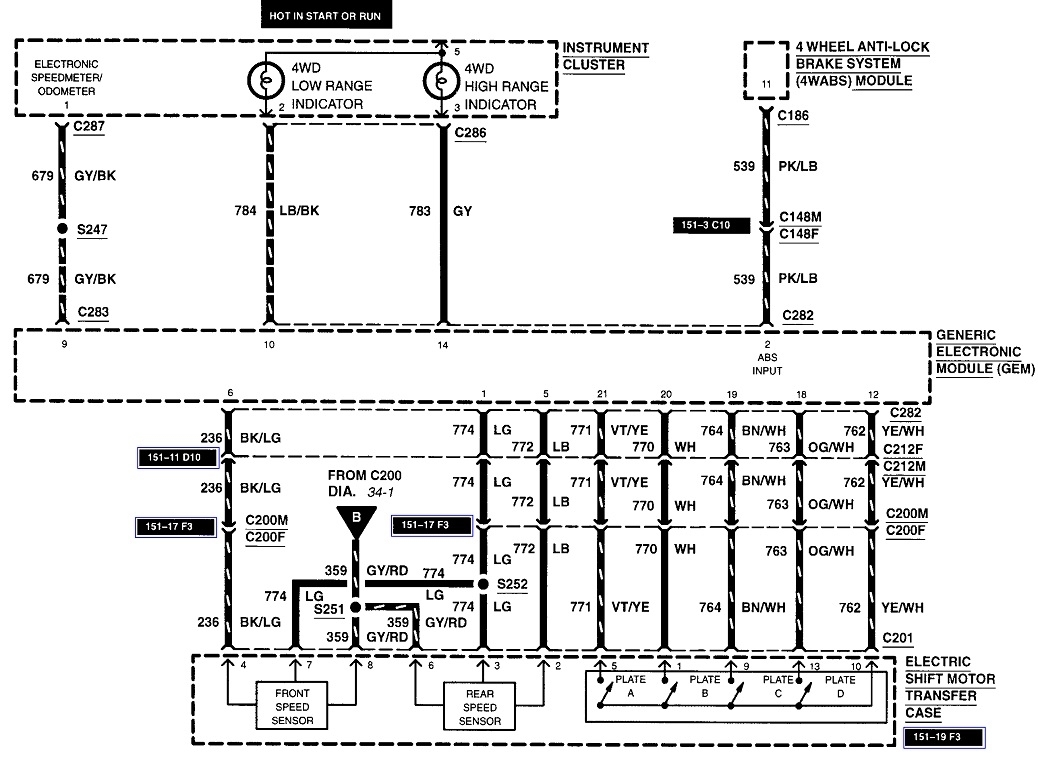

Can I get the Transfer Case Electrical Diagram?
2000 FORD EXPLORER
160,000 MILES • 4.0L • 6 CYL • 4WD • AUTOMATIC
JOHNG1771
  • 7 POSTS
I have the vehicle listed above with a 4.0L SOHC with a Borg 4405-15 Transfer Case with Traction on Demand. It contains two speed sensors. One for the output shaft located by the fill plug with three wires (gray/red, blue, and green). The second sensor is located by the shift motor and also has three wires (gray/red, black/green, and green). I am looking for the full electrical diagram that includes the GEM, TOD Relay, shift relay, etc. Any help would be greatly appreciated.
Thanks

Here's what I found for the transfer case. The two speed sensors are at the bottom left of the third diagram.
