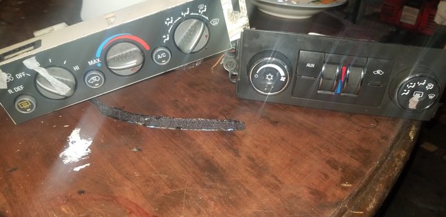

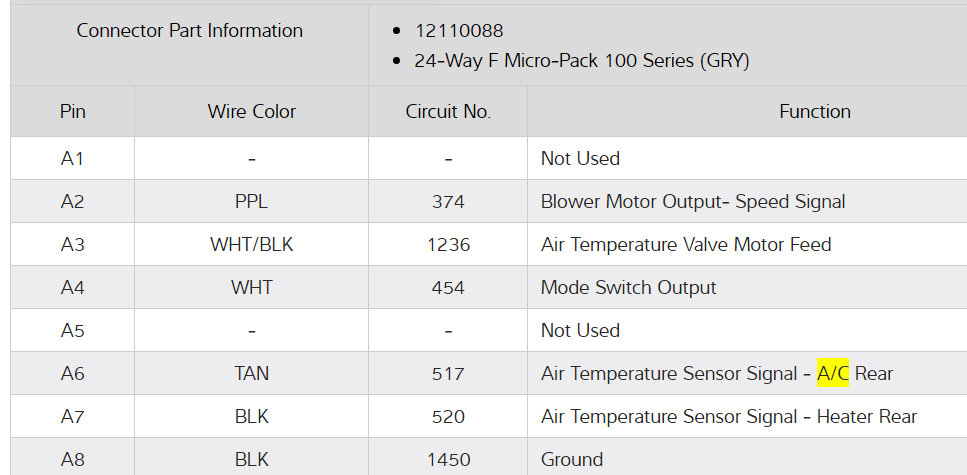

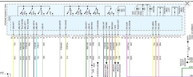

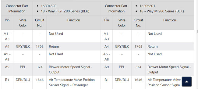

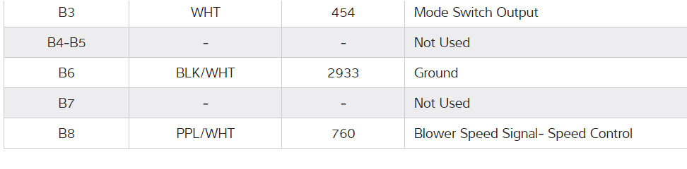

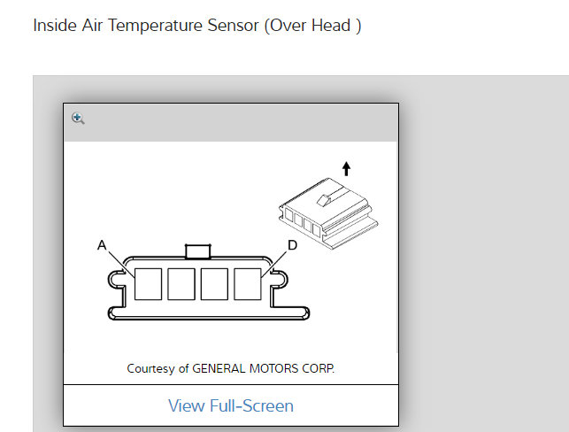

Need climate control color pinout diagram for my SUV listed above. Please and thank you. Also need to know what colors are what.
Apr 12, 2019 at 12:29 AM
Good morning,
I attached the diagram for you to view.

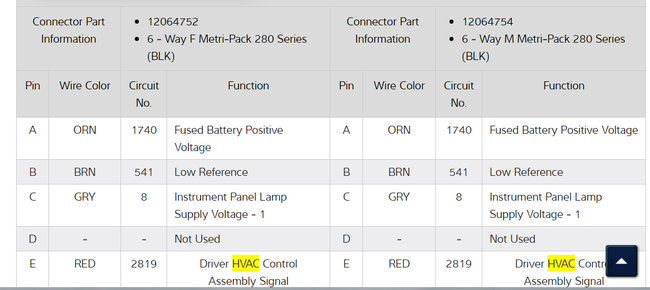

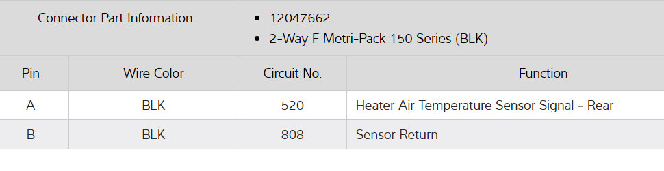

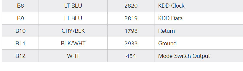

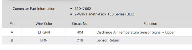

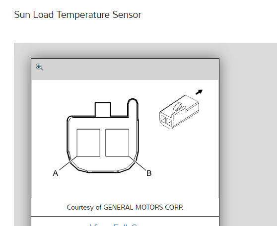

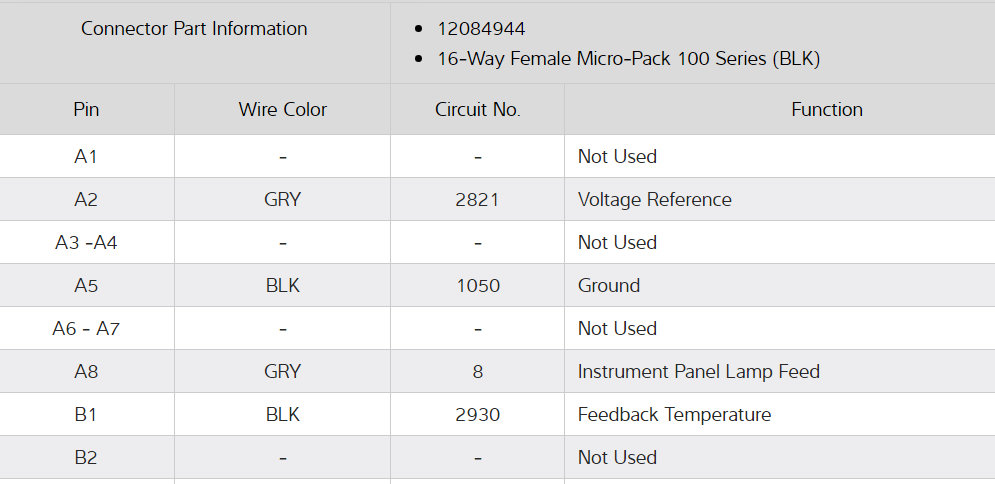

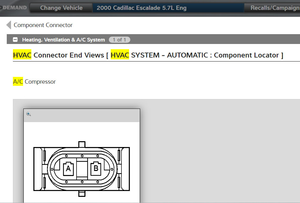

I'm trying to put 2007 Chevrolet Tahoe front A/C module to a 2000 Cadillac Escalate. need both pin out diagrams. please and thank you.
May 5, 2019 at 12:23 PM (Merged)

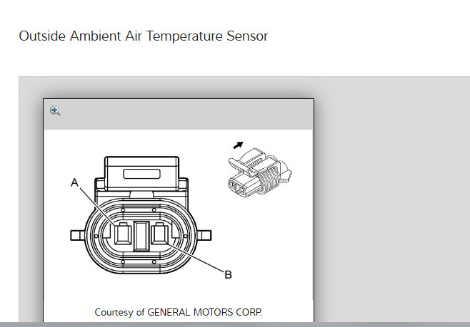

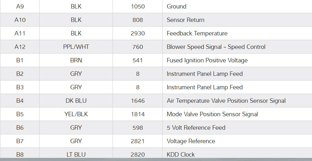

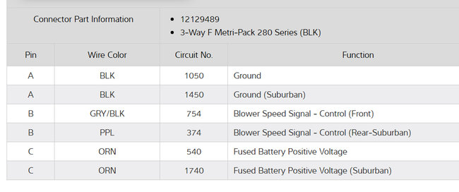

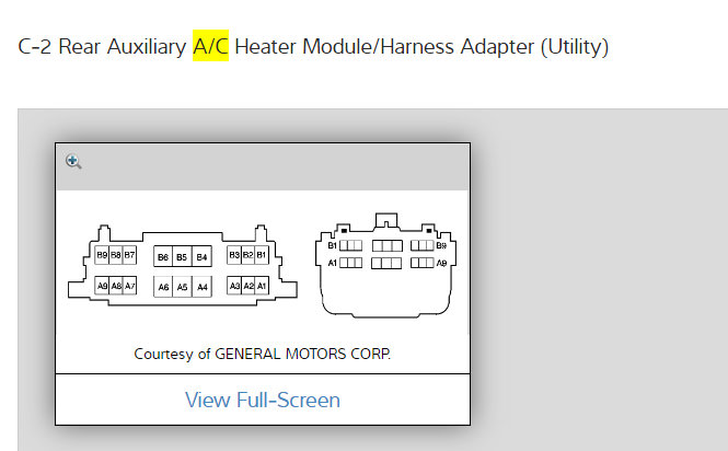

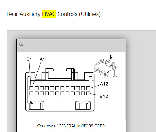

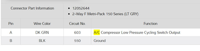

SCGRANTURISMO
  • 4,897 POSTS

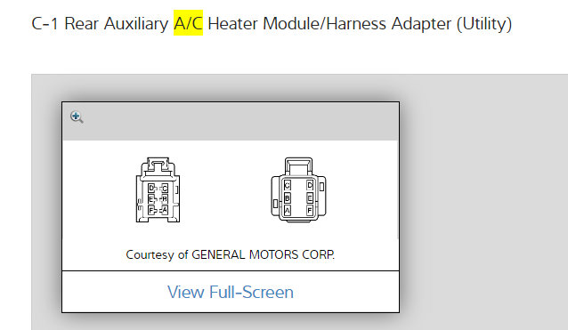

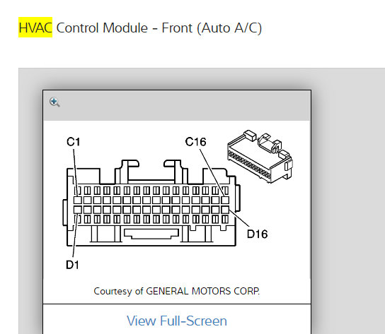

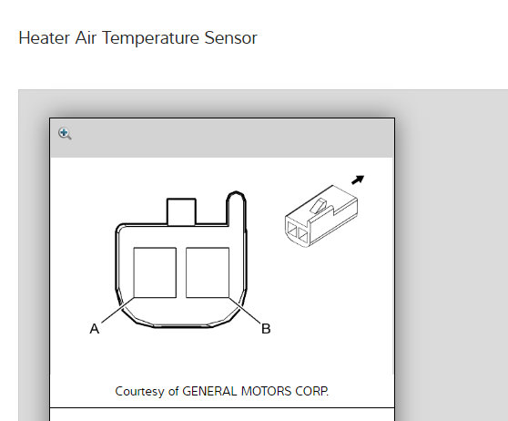

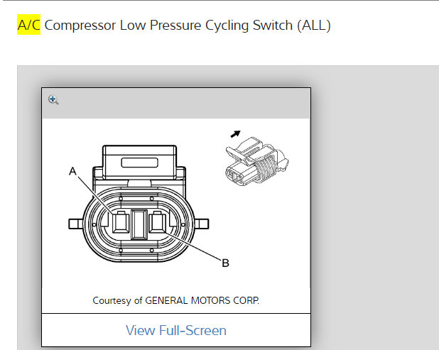

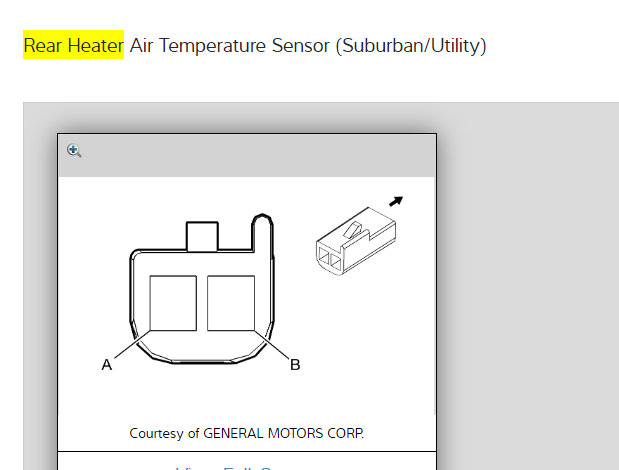

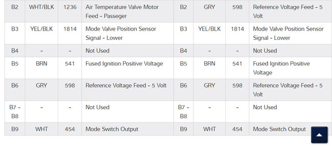

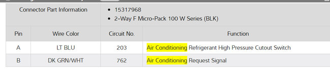

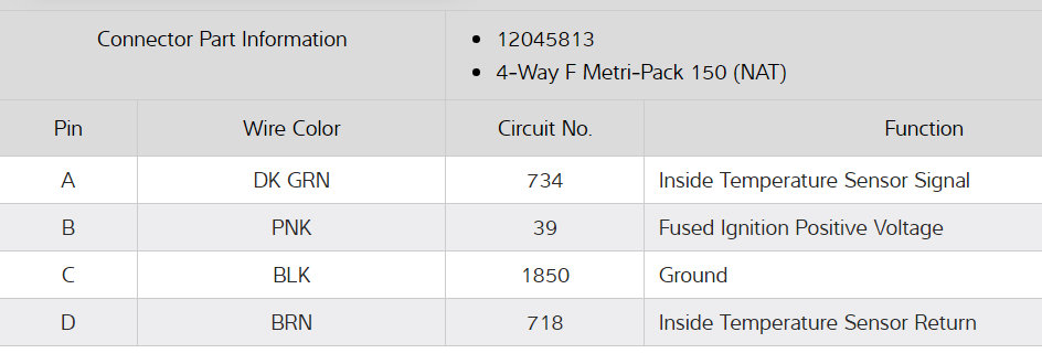

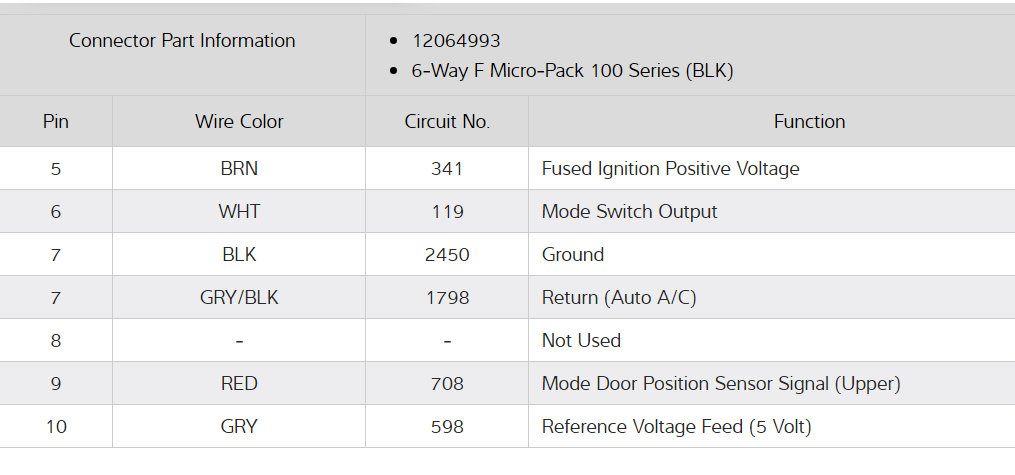

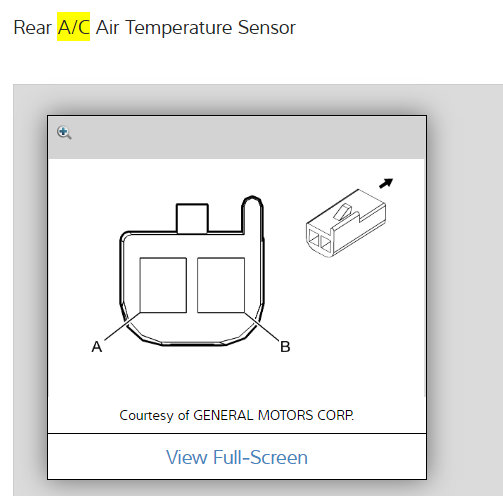

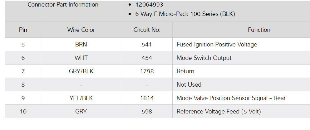

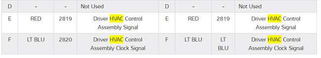

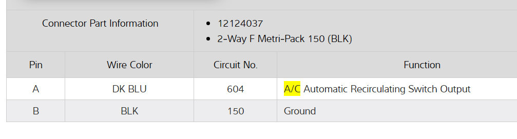

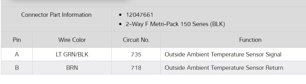

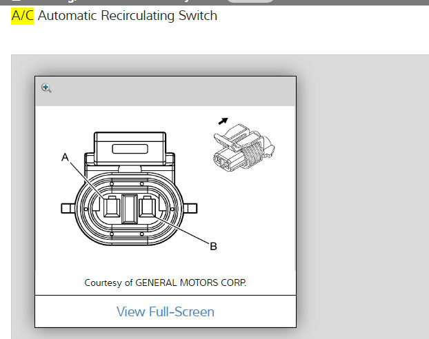

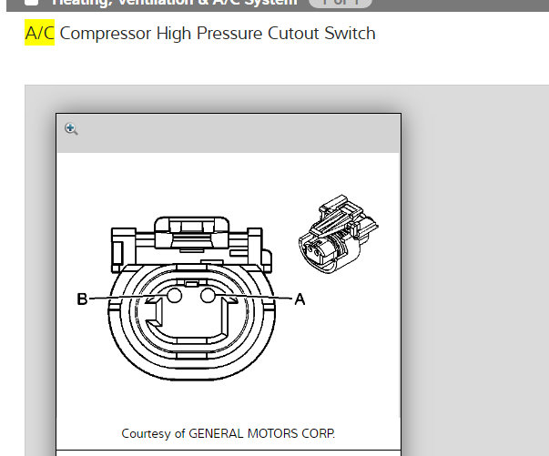

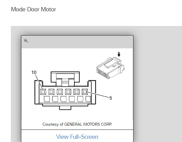

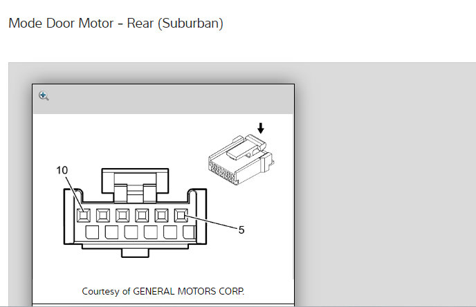

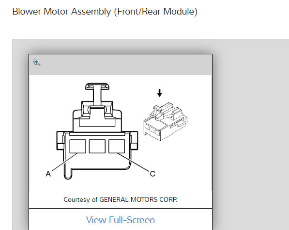

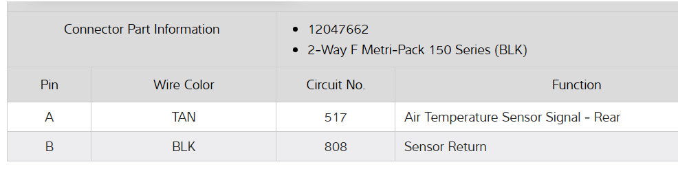

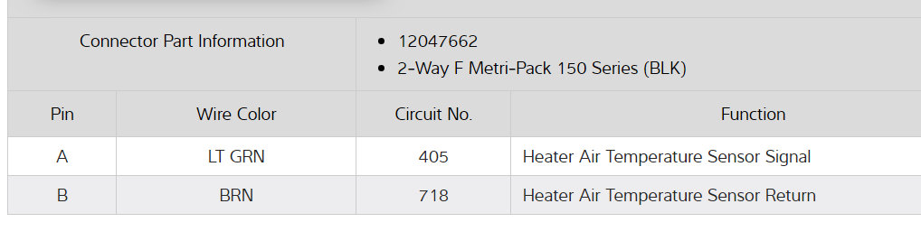

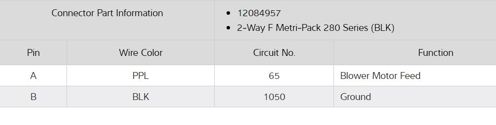

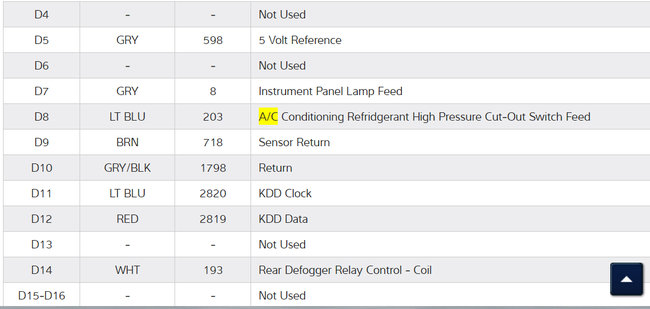

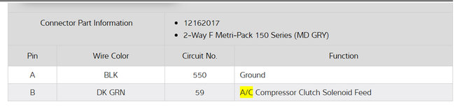

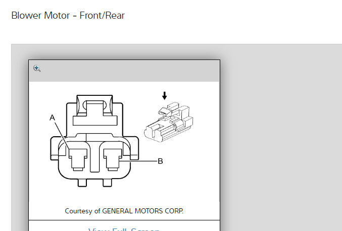

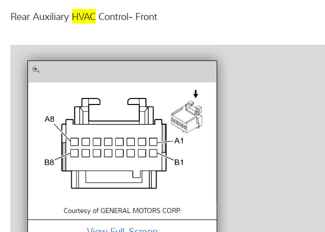

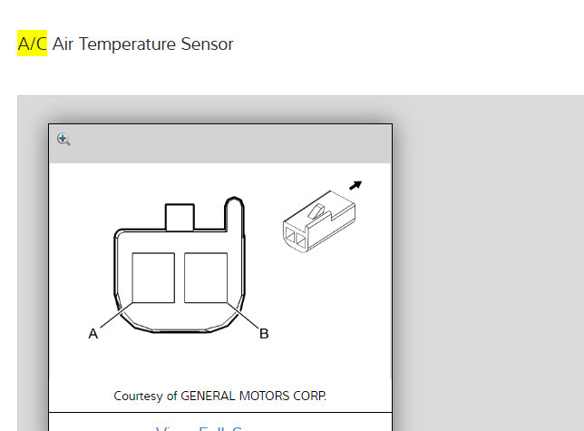

Okay. We can do this but there are a ton of connectors going to the HVAC system for the Escalade alone. I haven't even gotten to the Tahoe yet. So here is the first batch of connector pinout charts for you. I will send more in bunches until we get them all. Have fun and enjoy.
Thanks,
Alex

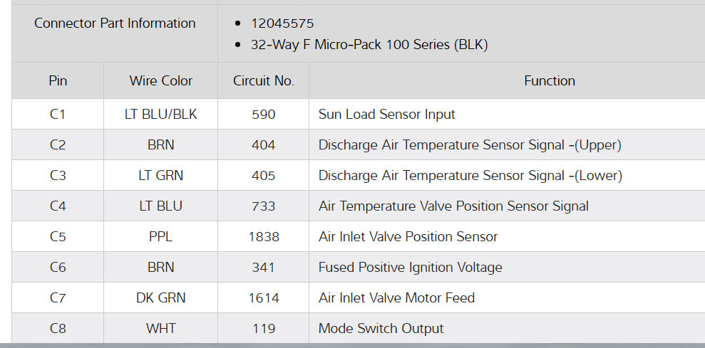

So how would I know how to connect 2007 Chevrolet Tahoe wires to 2000 Cadillac Escalade wires?
SCGRANTURISMO
  • 4,897 POSTS
Hello again,

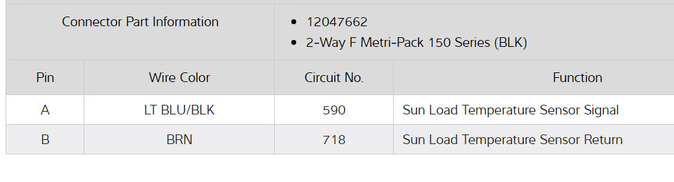

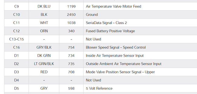

well you are are going to have to compare the connector end views and see if they match up. In the callout for each connector there is a pinout wire description. You can either cut the pigtails and reattach to the Cadillac wires or you can switch out the pins and put them into the connector pin locations. If you do not know how to do this get back to us and we will give you the directions on how to do this.
Thjanks,
Alex
2CarPros
LOCO223
  • 17 POSTS
I do not now how to do it.
SCGRANTURISMO
  • 4,897 POSTS
Hello again,
First off, print out all of the connector diagrams. Get a set of colored pens. Separate the connectors into matching sets (same connectors 1 Cadillac, 1 Tahoe). Now take first set of connectors. Match the wires that are in the Cadillac connectors to the corresponding connector from the Tahoe. That's all I can tell you. You have to either transfer the whole system to the Cadillac or move what you want from the Tahoe and hook it up to the existing connectors in the Cadillac.
