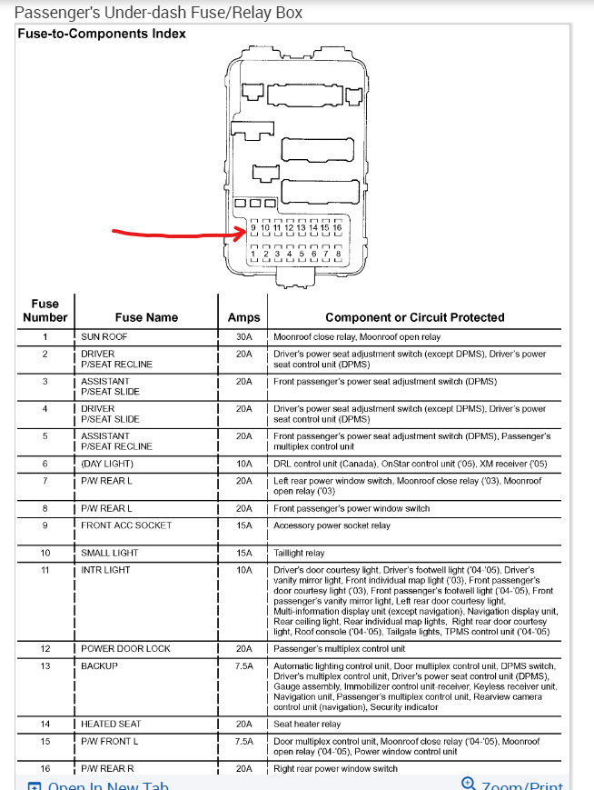

My Navigation Screen doesn't light up at all, my AC or Heat don't work at all. please help me figure this out. any ideas are very thankful I'm lost on this issue.

It sounds like you're having some electrical issues with your 2004 Acura MDX. Here are a few steps you can try to troubleshoot the problem:

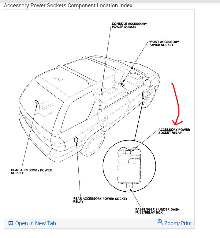

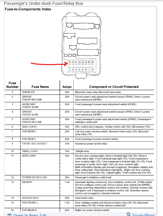

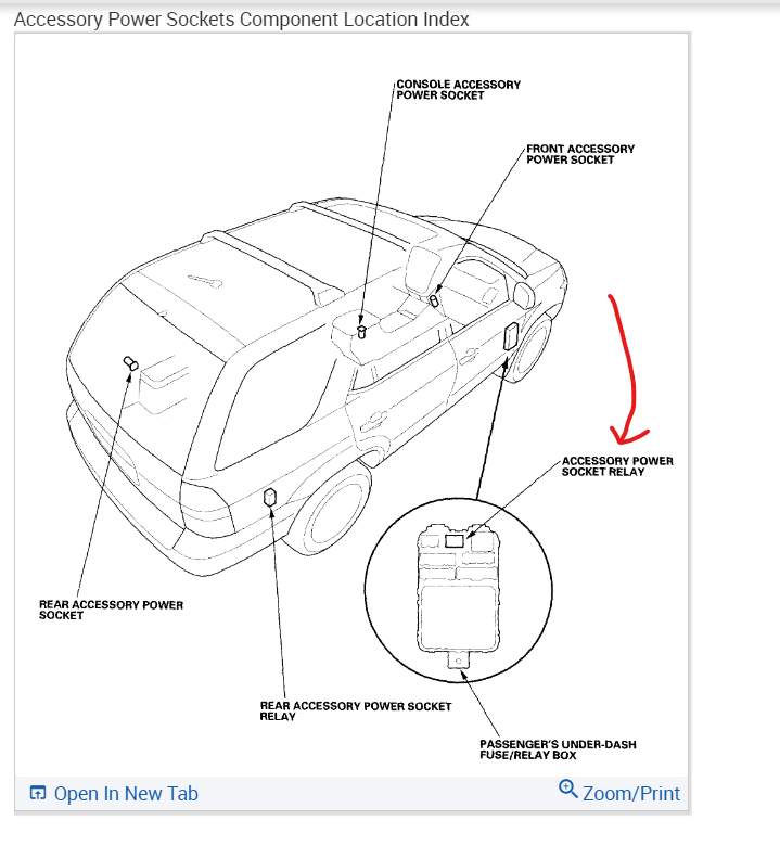

The first thing we need to do is check the fuse #9 and the accessory power relay here is a guide to help with the test please use it when the key is in the on position with the engine off. Also, I have included the fuse location in the images below.
Please let me know what you find. Please check the images below and get back to me.
