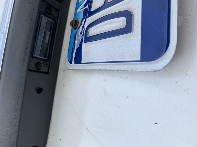

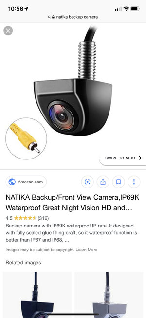

I am trying to install a natika backup camera but I can’t figure out where to mount it. I already drilled a whole to the left of the license plate light but i don’t see it going through to anywhere. Do you have any ideas? Thank you.

Okay, I will definitely send a picture and yes I have removed the interior trim panel. I drilled a hole right next to the license plate light which is right under the Chrysler logo on that plastic piece.

It’s that hole right next to the light.

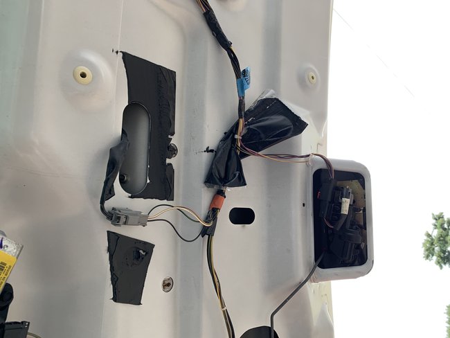

The interior panel.

Okay. That makes sense. That black plastic that you drilled into will actually come off, so you drilled into it but that did not go through the sheet metal. I would suggest just removing the tag light that is right next to it and see if you can feed the wires through it and see them on the other side. If not, you may need to get a longer drill bit and run it further up through to get through the metal.
If you can picture what is happening, you drilled vertical and are running parallel with the sheet metal. This is not a bad thing, just need to get access to the cavity that you drilled into.
Let me know if this doesn't make sense.
