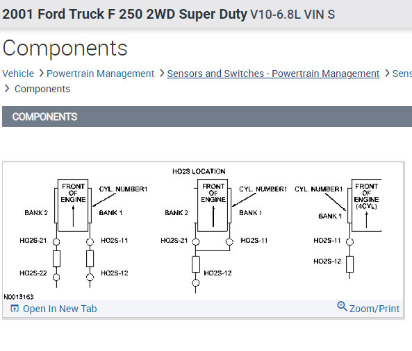

So is there any ideas on why my truck would only have two O2 sensors that I can find? I can't even find the place for the other two (the down stream) that should be in the area between the two doors.
Only thing back there is the fuel tank and the lights that I put in for my bed and all that is on the other side. TIA for all the help again guys!! Oh, and FYI, my mom ended up getting new van so the other question of mine from before is on the back burner for now, not so much a pressing matter.

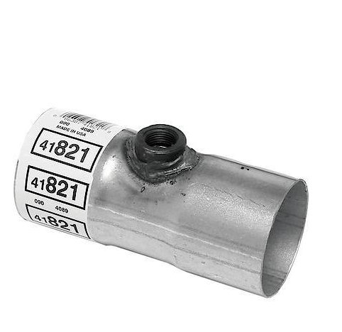

You can install O2 sensor adapter in to the exhaust if you wanted to have the sensors. However you first have to make sure that the wiring connector still exists on the truck that you are able to just plug in when you get the adapter.
