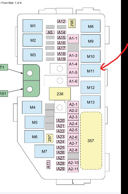

Can you please take a video of what the car is doing again, the first video you uploaded is too short. Thanks for the video of the scanner, the readings looked normal. I am thinking you may have a battery draw; let's try removing the A/C compressor control relay to see if that makes a difference. Here is a guide and the location of the relay:
https://www.2carpros.com/articles/car-battery-dead-overnight
