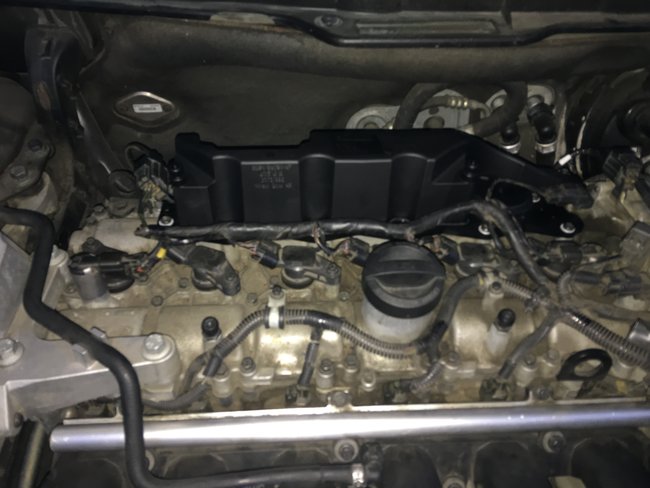

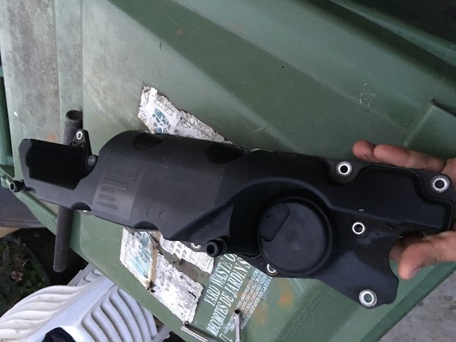

I solved my loud high pitched sound. My problem was I had a bad breather box or what other mechanic call a oil trap I believe. it sits on top of the engine block and it is very easy to remove and exchange. The part it self cost me about $230.00 but that stopped the high pitch sound on my car.

Here is a second picture.

Thanks for the feed back. this may help other members with a similar problem.
