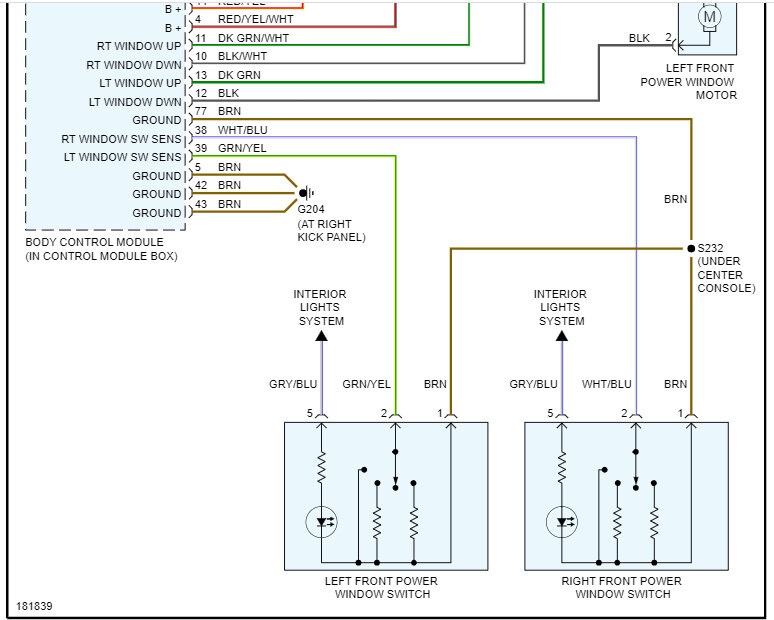

my windows will not go down?
2004 CHRYSLER CROSSFIRE
200,000 MILES • 4.6L • 6 CYL • 2WD • AUTOMATIC
BMAN1G
  • 48 POSTS
Does a fuse control them and power seats won't move.
Sep 9, 2023 at 4:55 AM
  • 110,241 POSTS

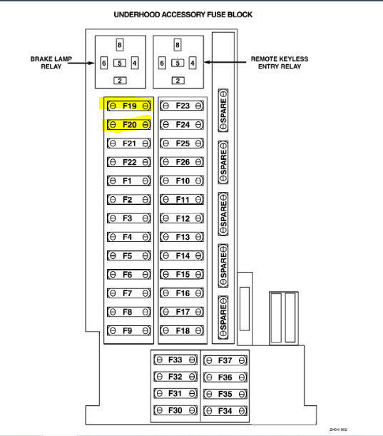

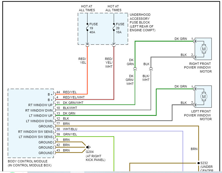

As far as the windows are concerned, power and ground are supplied by the body control module. There are two fuses, (19 and 20) in the under-hood fuse box that power the module.
I attached the wiring schematic below of the window circuit. First, confirm the two fuses are good. In addition to checking the fuses, confirm there is power to and from them.

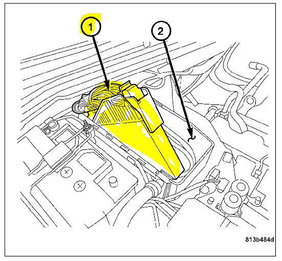

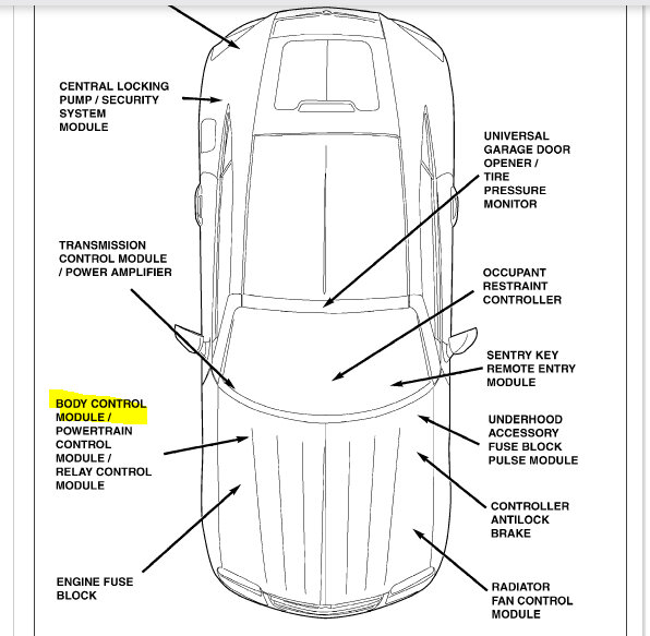

If they are good, I need you to locate the BCM. There are three brown wires that provide ground. I need you to confirm there is continuity to ground at those wires. Pics 3 and 4 will help locate the BCM. Pic 5 shows the fuse to check.

It works now was a wrong fuse in slot 19. Thank you so much 2CarPros is the best.
