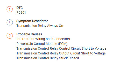

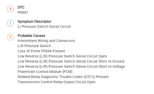

My vehicle started shifting problem by not shifting into 3rd and 4th gear but 1st,2nd and reverse gear. Then I diagnosed it using Bluedriver scan tool and It recorded P0891(transmission relay always on),P0841(low/Reverse pressure switch rationality),P0731(gear 1 error ratio), P1775 (Torque converter clutch latched in Lu position),P0846(2-4 pressure switch rationality), P0732 (gear 2 error ratio). Then I used the factory diagram from all data to trace and noticed that low/Reverse pressure switch circuit and 2-4 pressure switch circuit melted together at the pressure switch/solenoid pack assembly connector. I separated the two circuit and P0891,P0846 and P0732 gone and the vehicle began to shift into 3rd and 4th gear. Later I noticed that the vehicle was too sluggish on 1st gear and hardly climb bump and little hilly slope. Then I diagnosed again and recorded P0841,P1775 and P0731. I decided to change the solenoid pack/pressure switch assembly and replaced it with used one and the vehicle stopped going reverse,2nd,3rd and 4th gear. Above all it retrieve back P0846 and P0732 and deleted P1775,P0841 and P0731. I have changed 3 different pressure switch/solenoid pack but it was still doing the same, I interchanged the low/reverse circuit from its original terminal 2 to terminal 1 and 2-4 pressure switch circuit from 1 to terminal 2 to see whether the basis of the fault code will change from P0846 to p0841 and its still showing P0846 and P0732 . At this point I don't know whether its the PCM or the transmission itself is now the problem. I have done all the troubleshooting step according to fault code description on all data but still I am not getting what I wanted, please anyone with direct solution please tell me, let me solve this and started using my vehicle.
Jul 23, 2021 at 6:46 AM
Good afternoon,

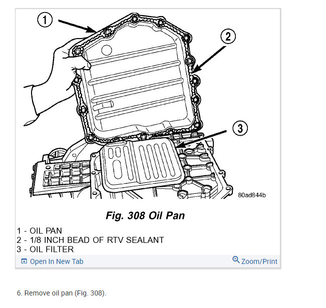

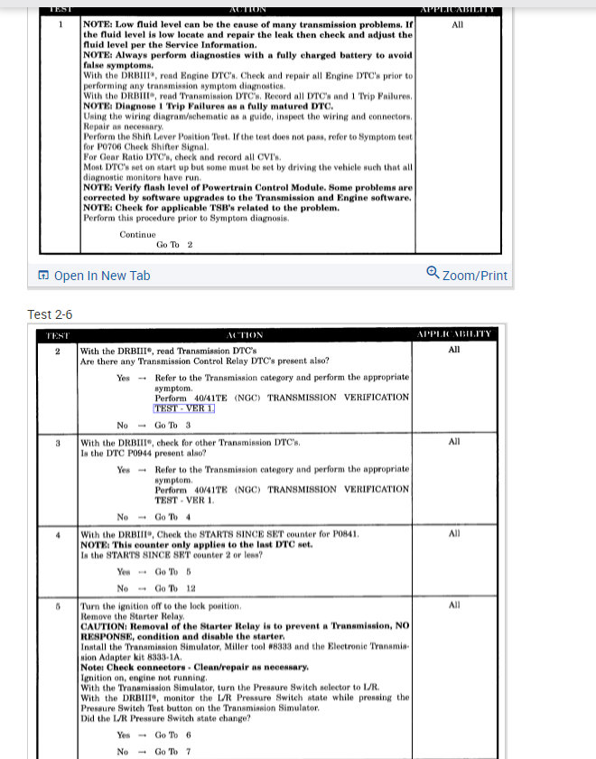

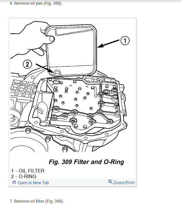

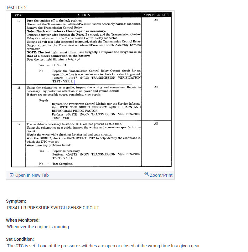

The first thing I would do is change the fluid and filter. Check the bottom of the pan for any debris.

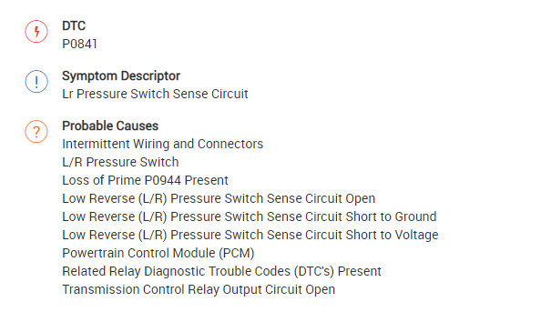

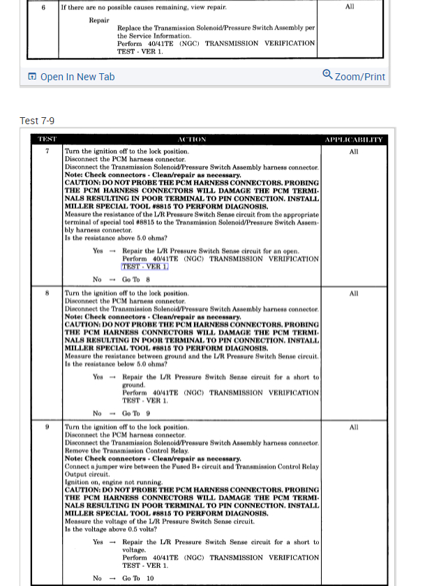

The 841 is the key. It could be a stuck pressure switch not allowing the clutches to apply. A pressure test will confirm this. I would follow this chart.
The other concern is the gear ratio code. That indicates slipping clutches that may mean the transmission needs to be rebuilt or replaced.
Jul 23, 2021 at 8:26 AM
MALLYBOY
  • 329 POSTS

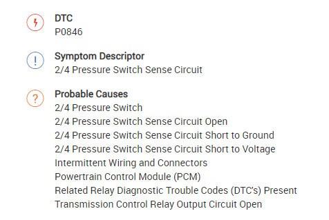

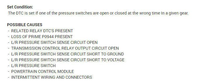

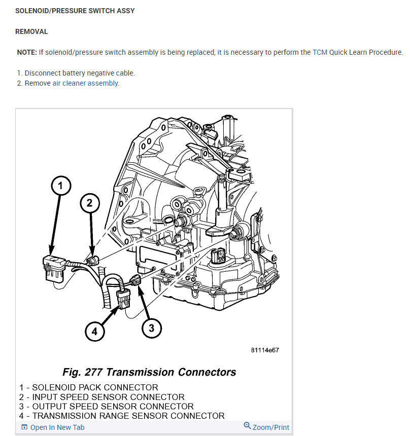

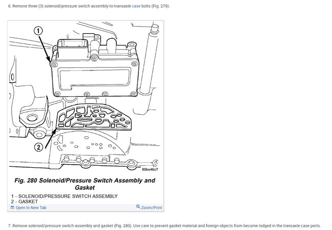

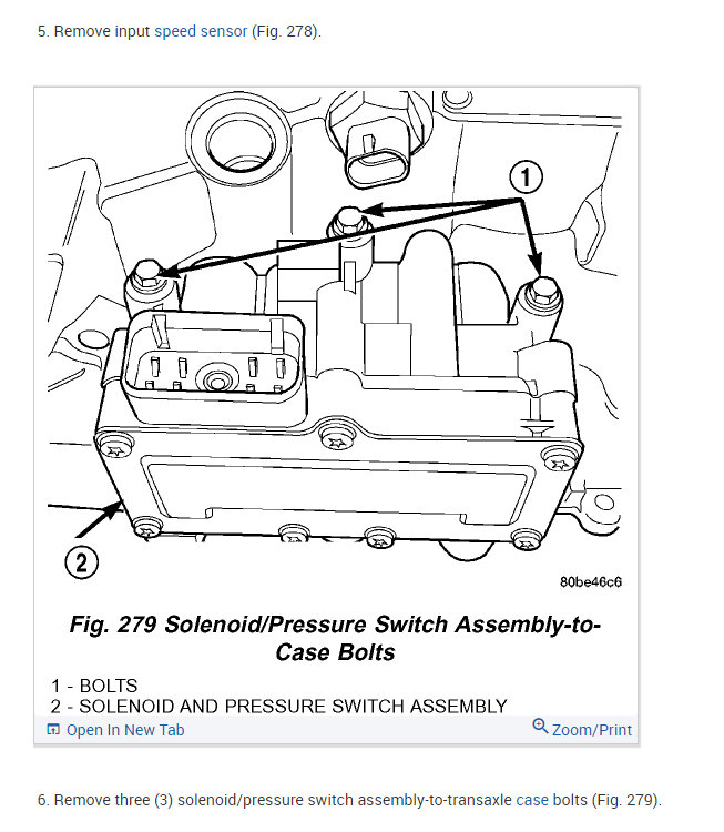

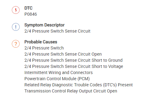

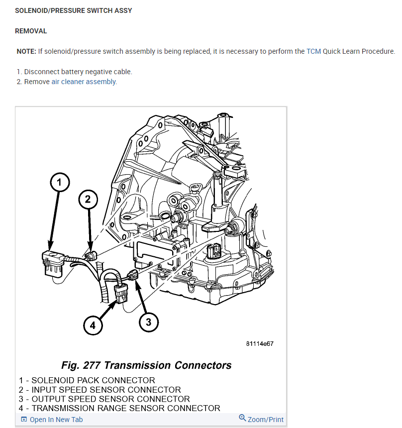

Good morning, thank you so far for your response. Although I haven't check the transmission filter and pan. But my greatest concern is this fault code P0846 and P0732 that's permanent. When I engage reverse, you will notice that the engine sound will drop showing it has engaged but to lock up with pressure. I also feels that it was because of this code:846 that makes clutch to slip. You mentioned of pressure test, I don't have the transmission simulator kit for test. But please if you can help me to identify the 2-4 pressure switch on the solenoid/pressure switch assembly, to make it easy for me to check solenoid valve on the valve body to see if it is stuck or block and I will service it, since you said:The 846 is the key. It could be a stuck pressure switch not allowing the clutches to apply.
Jul 23, 2021 at 4:20 PM

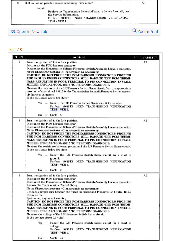

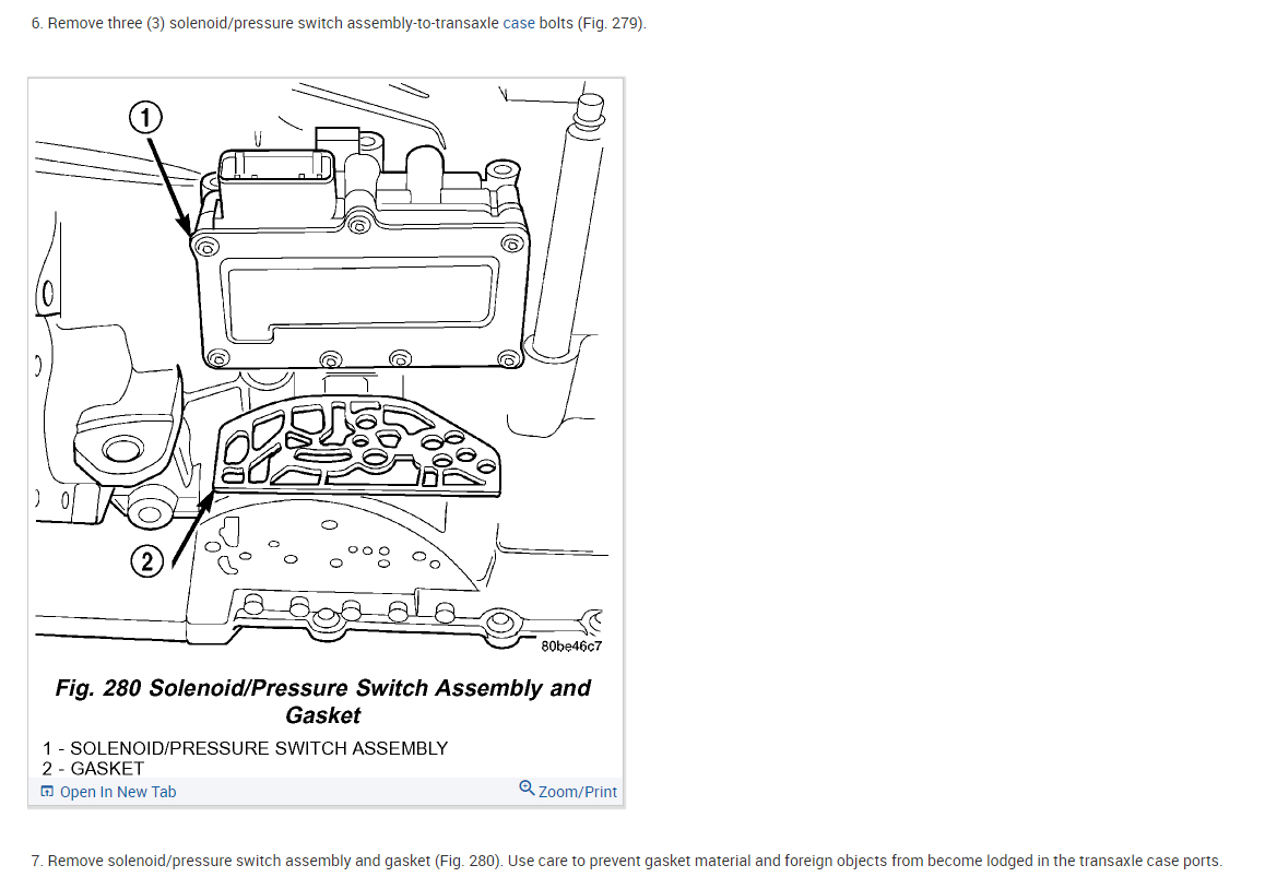

Okay, I attached the procedure and location for you below. You will need a scan tool that can access the transmission and see if you can command the solenoid on and off.
Jul 23, 2021 at 9:01 PM

I have checked the wires before using multimeter and factory diagram to check for resistance and there was continuity on the circuit, I checked the voltage on the 2-4 pressure switch circuit, the reading was above 0.5volts but Alldata stated if the voltage is above 0.5v, repair 2-4 circuit for short to voltage, then how can I repair the circuit?
Jul 25, 2021 at 7:02 AM
That is a wiring harness issue. You will need to uncover the wiring and check for damaged wires. Short to voltage means the power wire and the ground are shorted together somewhere in the harness.
Jul 25, 2021 at 7:14 AM

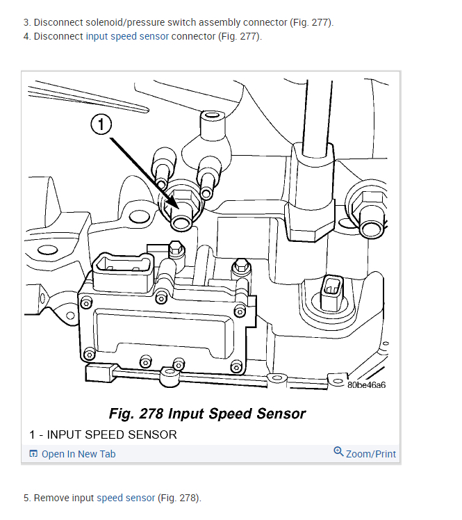

MALLYBOY
  • 329 POSTS

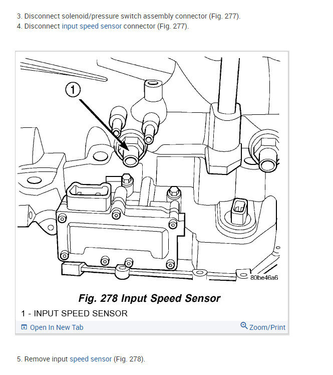

1. How do I measure voltage on solenoid pack/switch assembly connector?
2. If Transmission Range Sensor is faulty, can it cause this kind of thing?
Jul 25, 2021 at 8:05 AM

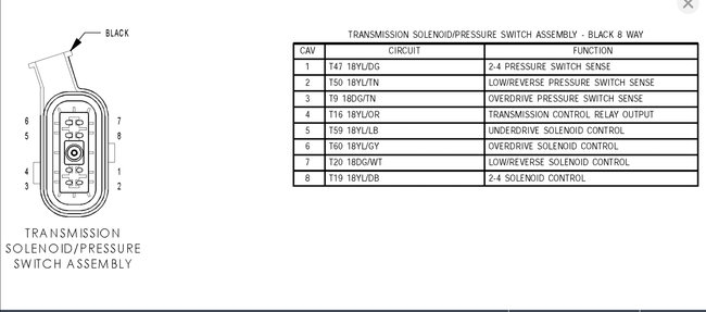

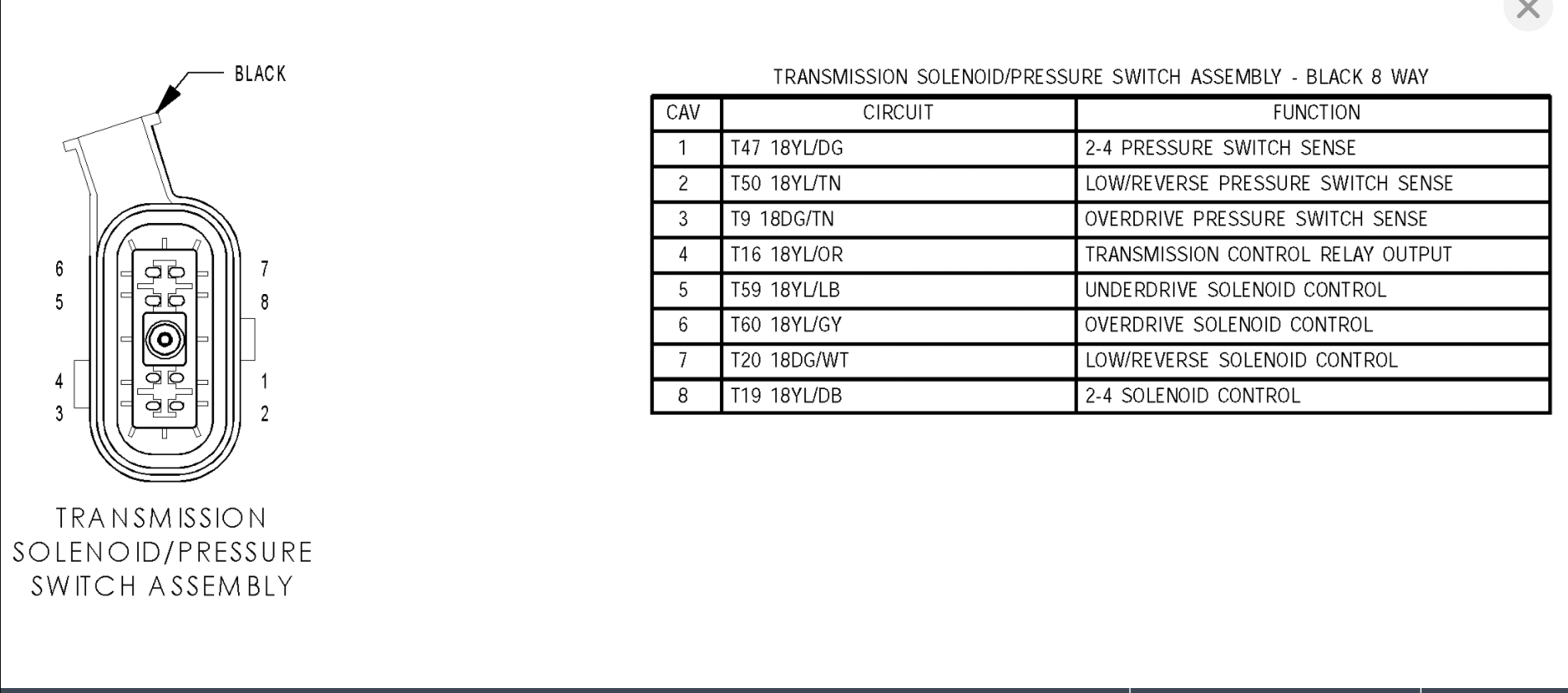

I attached the diagram for you.
Put your red lead on the 2-4 solenoid pin and the black lead on the return wire.
Jul 25, 2021 at 8:12 AM

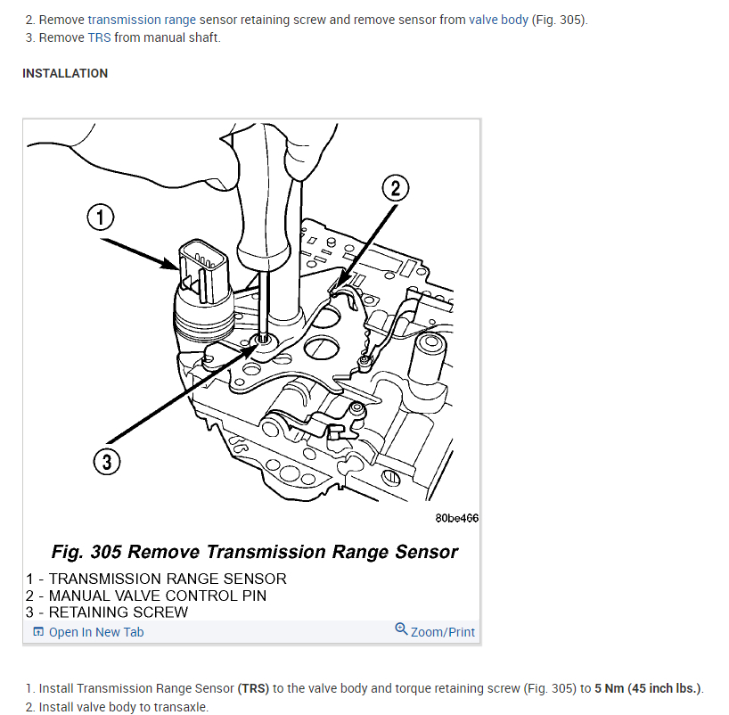

MALLYBOY
  • 329 POSTS

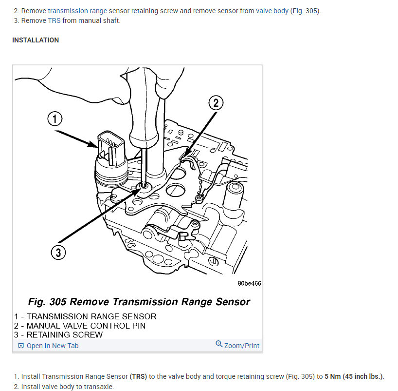

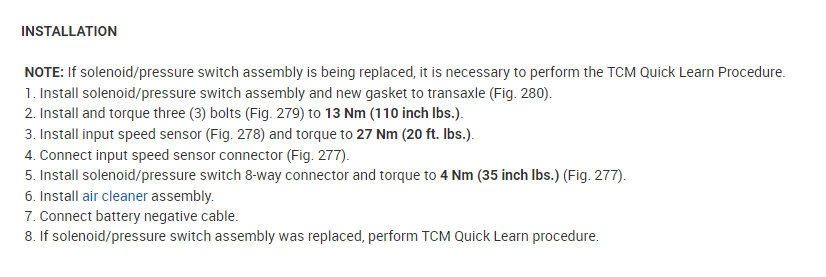

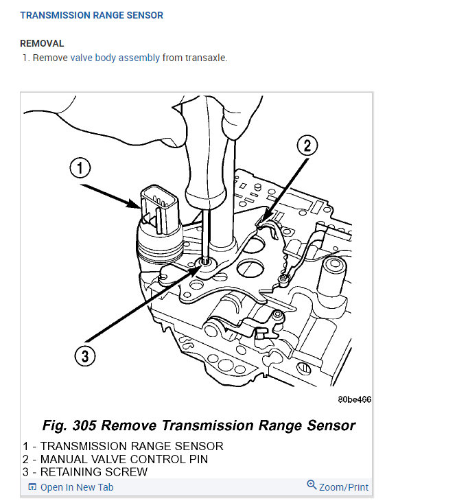

Why I asked is that, when I shift the gear lever from P -R, the Indicator light will work well but if I want to Shift from N -D, the indicator light will go back on reverse and now jump to drive.
Jul 25, 2021 at 7:00 PM

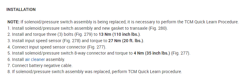

Okay, I would replace the position switch for that issue but It will not affect the shifting issue with the transmission.
I attached the procedure for you below.
Jul 25, 2021 at 7:12 PM

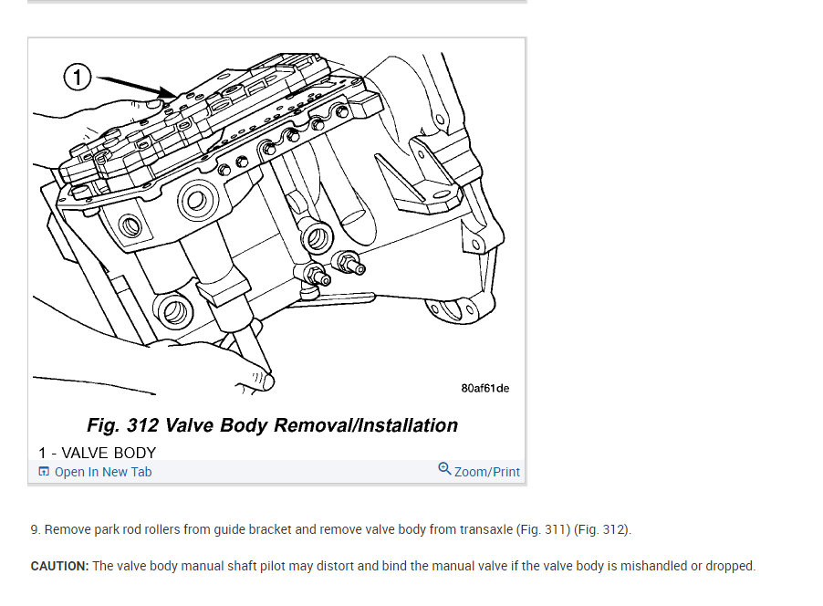

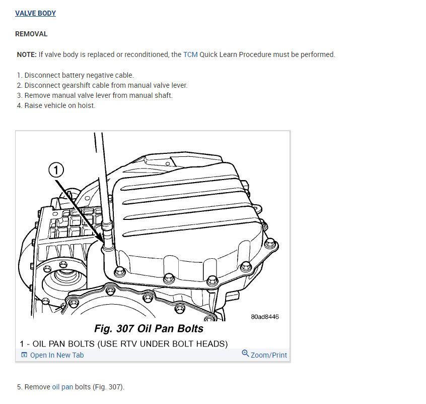

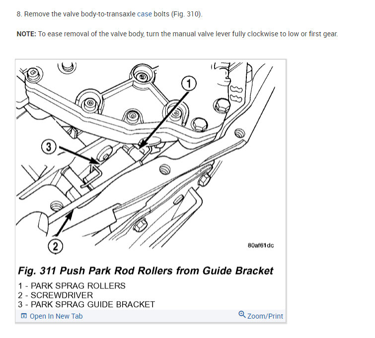

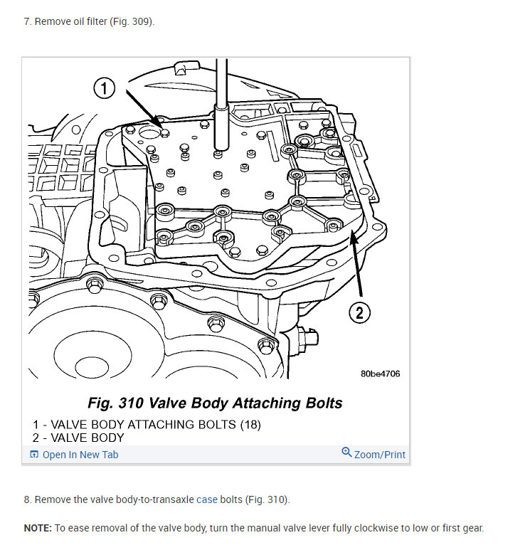

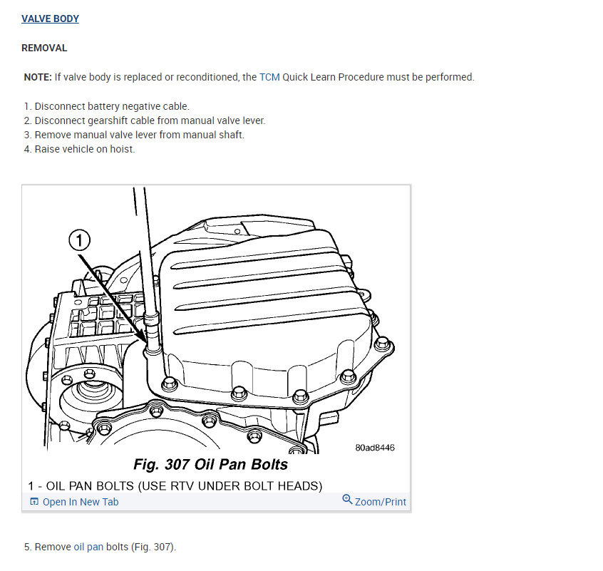

I want to drop the Valve Body and service it and see if it can solve any stuck valve.
Jul 25, 2021 at 7:56 PM
While you are there, you can replace the switch. That is the procedure for the switch.

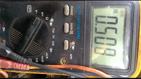

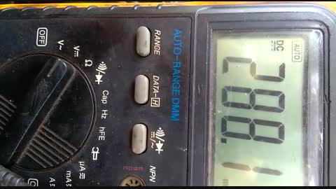

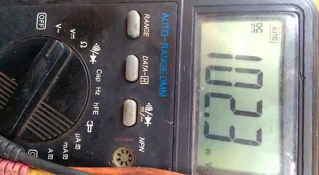

Good morning! I started the short to voltage test as you directed:put your red lead on the 2-4 solenoid pin and the black lead on the return wire.
1.when i put the red lead on the l/r pressure switch pin2 and the black lead on the return wire it reads:0.4 to 0.5volts.
Jul 26, 2021 at 9:05 PM

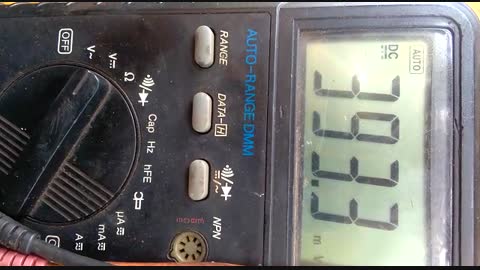

MALLYBOY
  • 329 POSTS
1. When i put the red lead on the 2/4 pressure switch pin1 and the black lead on the return wire, look at the readings on this video .
Jul 26, 2021 at 9:22 PM

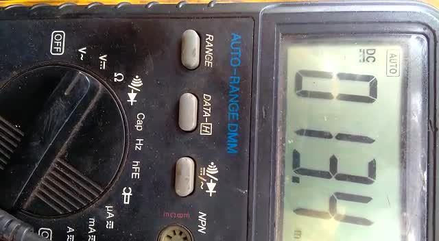

MALLYBOY
  • 329 POSTS
When i put the red lead on the o/d pressure switch pin3 and the black lead on the return wire, look at the readings on this video.
Jul 26, 2021 at 9:28 PM

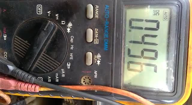

MALLYBOY
  • 329 POSTS
What can you say about this situation? Because I said let me do the test first before proceeding to body valve if it pass the test?
Jul 26, 2021 at 9:33 PM
Okay, it should be 12 volts. There is an issue feeding the solenoids.
Jul 27, 2021 at 5:48 AM
MALLYBOY
  • 329 POSTS
Which one supposed to be 12volts, Is it the pin 1,2and3?
Note: the procedure says:
Turn ignition to lock position
Disconnect PCm harness connector
Disconnect solenoid/pressure switch connector
Remove transmission control relay
Connect a jumper wire between B+ and control relay output circuit,
Turn ignition on, engine not running
Measure the voltage of 2-4 pressure switch circuit.
Is the voltage above 0.5volts?
If Yes: repair 2-4 pressure circuit for short to voltage
If No:Go to next
Jul 27, 2021 at 8:20 AM
Check and see if any of the wires have 12 volts.
Those 3 are sensor wires not feed wires.
Jul 27, 2021 at 8:23 AM
MALLYBOY
  • 329 POSTS
Check and see if any of the wires have 12 volts: the return wire pin4 has 12 volts.
How many volts does the 3 sensor wire supposed to have?
Jul 27, 2021 at 8:32 AM
MALLYBOY
  • 329 POSTS
Red lead into pin4 and black lead to pin 1. Tell me the voltage.
Jul 27, 2021 at 9:21 AM
That indicates an open circuit on the 2-4 sense wire. That is ghost voltage as it is not constant voltage. That indicates an open circuit.
Jul 27, 2021 at 9:38 AM
MALLYBOY
  • 329 POSTS
That indicates an open circuit on the 2-4 sense wire. That is ghost voltage as it is not constant voltage. This indicates an open circuit .thank you very much. It is the same way on O/D sense wire, except L/R sense wire(Red lead into pin4 and black lead to pin2) reads 0.4 to 0.5volts and this could be the reason why only first gear works on the vehicle. So i need to uncover the wire harness and repair 2-4 and O/D sense wire?
Jul 27, 2021 at 11:56 AM
Correct. There is either a broken wore or corrosion in the harness.
Jul 27, 2021 at 6:49 PM
MALLYBOY
  • 329 POSTS
Good evening! Correct. There is either a broken worn or corrosion in the harness: I disconnected PCM connector and Solenoid/Pressure Switch Assembly, I check resistance on each pin. there was continuity and I removed transmission control relay and used jumper wire to connect fused B+ and transmission control relay output, as I put the red lead on pin1 and black lead on pin4 to measure voltage, it reads 10.16 volts on all the pin1(2-4 pressure switch) =10.16volts, pin2(L/R)=10.16 volts and pin3(O/D)=10.16 volts, so I guess the 3-sensor wires are short to voltage. Am I correct?
Jul 28, 2021 at 5:04 AM
With your results, that is what it appears to be, yes.
Jul 28, 2021 at 5:19 AM

Hello! Good evening sir!
I am getting more confused about this situation. I remove the feedwire from the C3(5) on the IPM and Pin4 of solenoid connector and put another wire, I connect the jumper wire between B+ and the return wire in the IPM. I put red lead on the Pin1 and black lead on pin4, it reads 1.9volts, the pin2 and pin3 readings are between 1.9.... to 2....volts. I am totally confused now. Please help.
Jul 29, 2021 at 4:51 AM
MALLYBOY
  • 329 POSTS
How do I measure resistance between ground and the 2/4 pressure switch sense circuit?
Jul 29, 2021 at 4:37 PM
You have a wire harness failure somewhere. when there is no power to the solenoid or return to the ECM, the solenoid will not work.
You are going to need to uncover a lot of the harness and inspect for failure. It will show as frayed or the insulation is open somewhere.
Jul 29, 2021 at 7:41 PM
MALLYBOY
  • 329 POSTS
Is it not better that I replace ECM and check since I have changed 3-different solenoid packs and it was still doing the same thing?
Jul 30, 2021 at 2:04 AM
It is not a component problem. It is a wiring harness issue.
Jul 30, 2021 at 3:17 AM
MALLYBOY
  • 329 POSTS
It is not a component problem. It is a wiring harness issue: yes i have now agree with you because i disconnected the transmission control module connector c4 and i set my multimeter on resistance mode, i place the red lead on c4(38)(28)(19) transmission control relay output feedwire(y/or) and black lead on c4(13)(14) transmission ground wire(bk/lg), the multimeter began to beep showing that the feedwire and ground are shorted together somewhere in the harness.
Jul 30, 2021 at 3:58 AM
