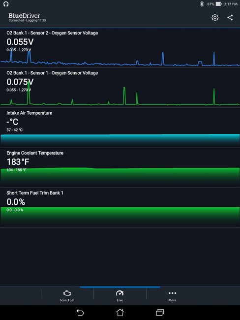

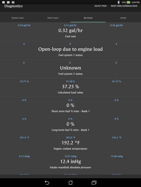

MALLYBOY
  • 329 POSTS
What I suspect is happening is the EGR is stuck open or closed and this is causing the PCM to alter the air fuel which makes it bog.
One way to confirm this is to monitor the o2 sensor data when this is happening. I bet they are getting rich and it causes it to bog. I have checked O2 sensor data, I attached the picture of the live data below. There was no O2 activity from short term fuel trim to long term.

That is due to a scan tool or PCM/sensor issue. If this was a PCM/sensor issue then you should have codes pointing to the o2 sensors.
So that means I suspect you have a scan tool issue that is not able to monitor that data. That is pretty common on generic scan tools. Do you see something in there that says o2 sensor voltage?
If you have the voltage we can get the same info. Basically the o2 sensor will tell the PCM a voltage between .01 and .1 volts. Based on this voltage we can tell if it is rich or lean.
Most all scan tools can get that voltage so let us know about this and we can figure that part of it out. Thanks

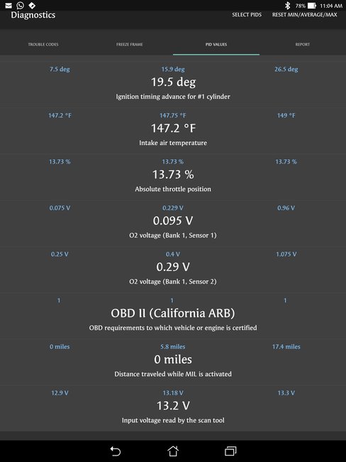

MALLYBOY
  • 329 POSTS
To answer your question about seeing something in there that says o2 sensor voltage?
Yes, I saw it. I attached the picture below.
Sep 4, 2021 at 8:05 PM
Yep. I think you are right. More than likely that EGR is stuck open. This shows that the mixture is lean. The lower the voltage the leaner the mixture. If it is close to .2 that is lean. Then .9 volts is rich.
The odd thing in this though is that your upstream sensor is lower then the downstream sensor. That tells me we may have an issue with the sensors as well. Basically that is telling us that there is more fuel after the converter then before it. The point of the converter is to reduce the emissions so I am surprised that we don't have a cat inefficiency code as well. The fact that we don't makes me concerned this is a scan tool issue as well.

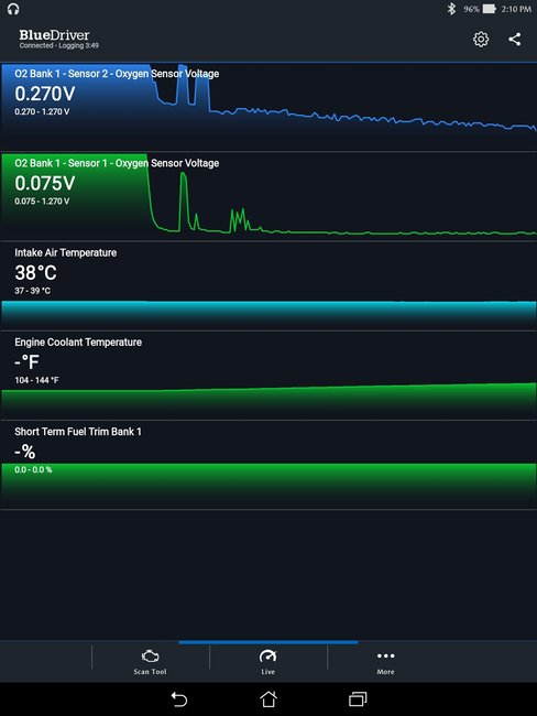

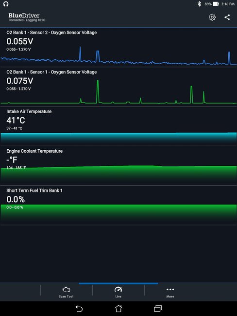

MALLYBOY
  • 329 POSTS
I used another Scan tool Bluedriver to read the O2 sensor voltage. I notice that as the engine temperature increases, the readings get lower. I attached the pictures below.
Sep 5, 2021 at 11:36 PM
Okay. That is better. However, they are very low showing a lean condition. So we have additional air getting into the system or a fuel issue but with this EGR issue, I suspect you were correct that it is stuck open just dumping exhaust back into the intake leaning it out.
