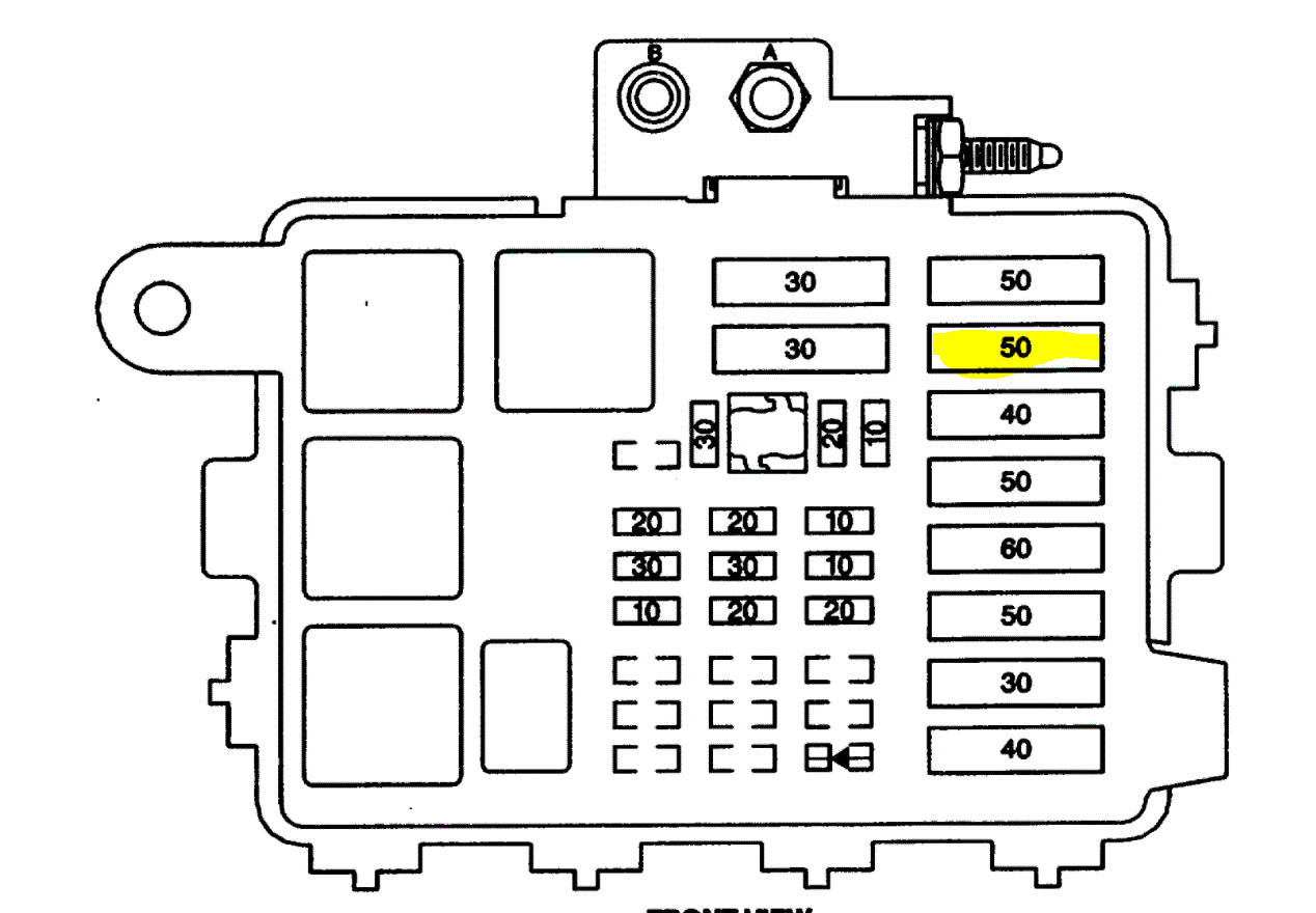

My truck will not start or no starter. No power to half of my fuse paneling in the inside and under the hood.
Aug 15, 2021 at 6:32 AM
  • 110,251 POSTS
If you are not getting power to the box under the hood, there could be an issue with the box itself.

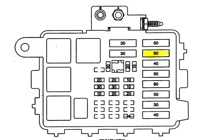

I attached a pic of the under hood box and highlighted a fuse (Batt). It is one of the mega fuses. Make sure it is good and check it for power to and from. Also, inspect the other mega fuses as well.
See pic below.
