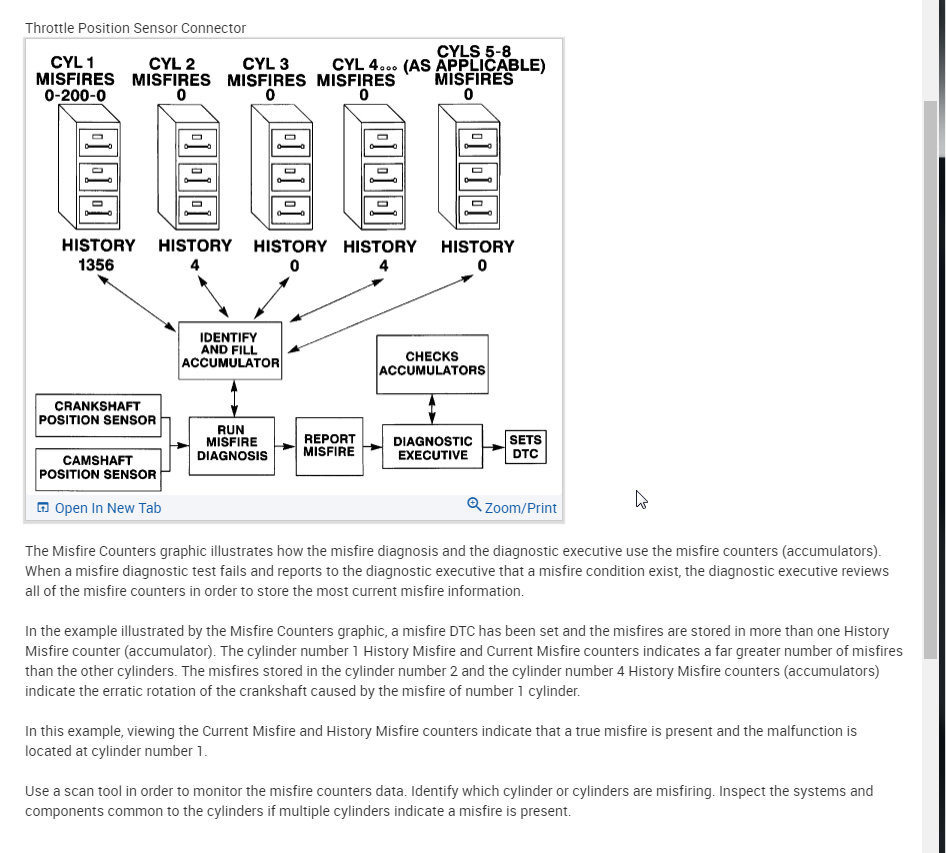

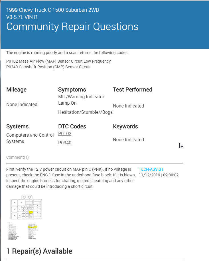

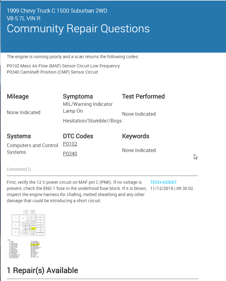

Did they pull the codes while you were there? It would be helpful to know if you have multiple cylinders misfiring or even an sensor issue that could cause this issue.
The fact that you smell fuel is an indication that it is running rich but that may just be a symptom of an mass air flow sensor. If the amount of air coming in is not accurate then the PCM will not add the correct amount of fuel.
Let's start with the codes and go from there. Thanks.
