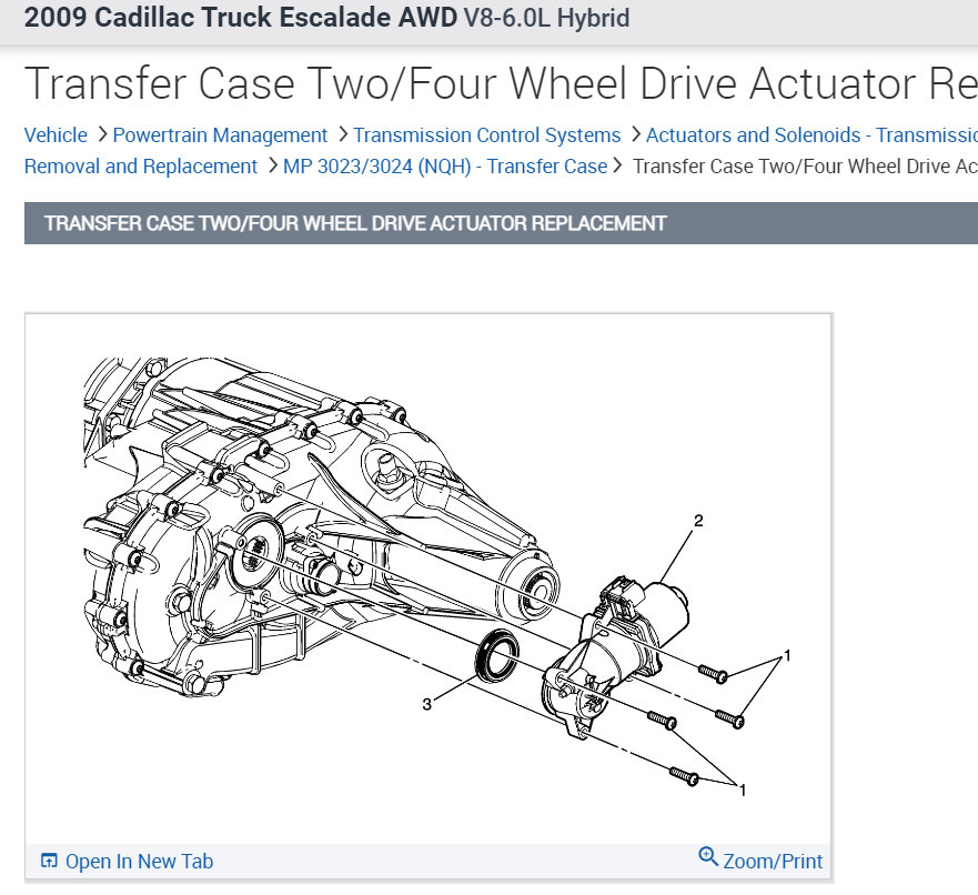

My truck is stuck in 4-wheel high and will not come out. the usual fixes, put in neutral, start and re-start, drive in reverse, etc., are not working. help please.

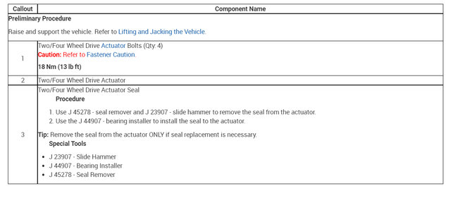

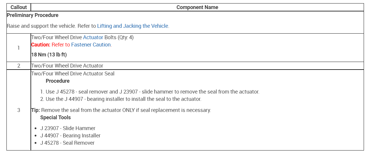

Yep, this happens 9 times out of 10 the transfer case actuator motor has failed but we should run the codes to see what comes up, I also have included the actuators' location so you can replace it in the diagrams below.
