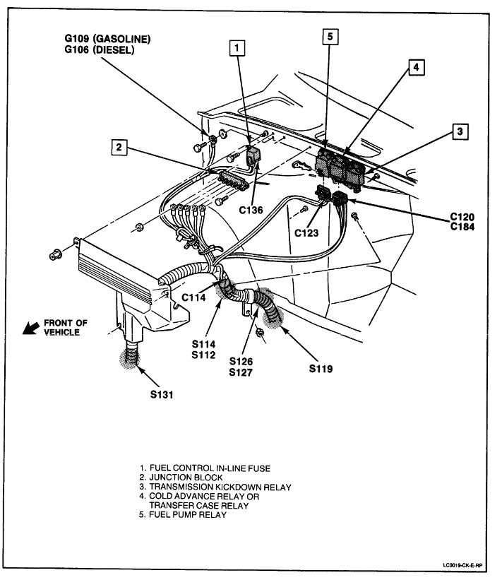

i was out at our farm and was driving back to our driveway and i went through some area we were grading and i hit a very large bump that i did not foresee, my truck just conked out right there. i towed it back to the house and i have done a number of tests but i still can't get it started. I recently replaced the cap and rotor, it has a new transmission, the plugs are new, the plug wires are new, and the fuel and oil filters are new. I know it is getting air, and I watched, and it is getting fuel in what looks like the normal amount when i crank it over. i pulled a plug wire and i am getting spark. What else should i do?

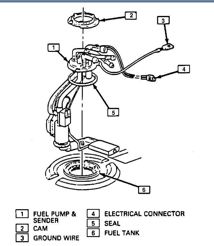

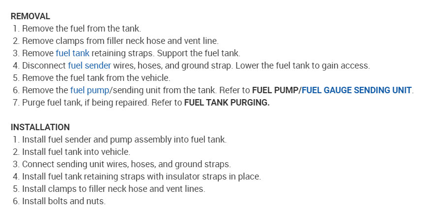

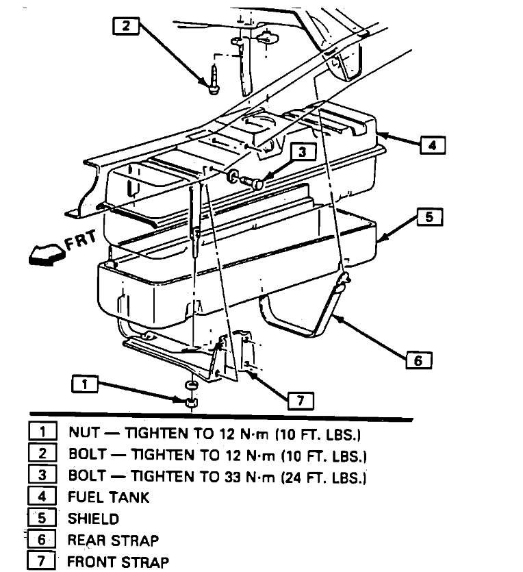

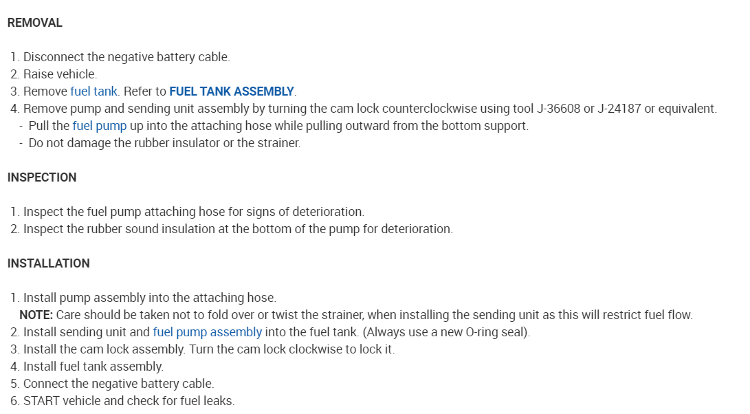

It sounds like the fuel pump went out which is common, can you see if the engine will run on starting fluid? if so see if you can hear the pump run in the tank after you turn the key on without cranking the engine over, if not here is how to change the pump out and I would swap out the fuel pump relay as well, please go over this guide which can help us fix the problem.
https://www.2carpros.com/articles/car-not-running-advanced
Check out the images (below). Please let us know how it goes

The fuel pump is functioning, it's spraying fuel out the injectors. Is there a possibility that it is only part way working?
