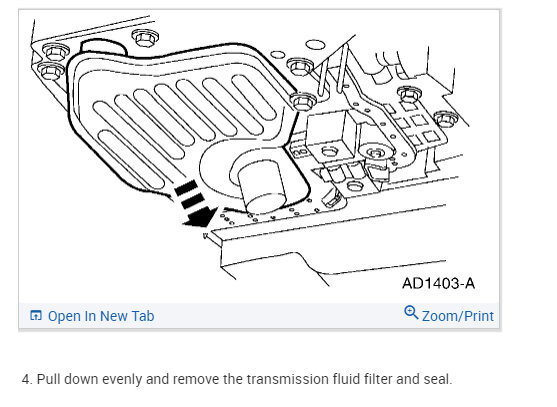

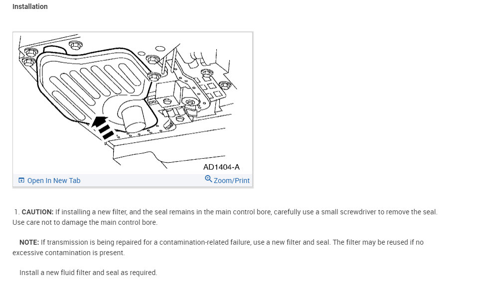

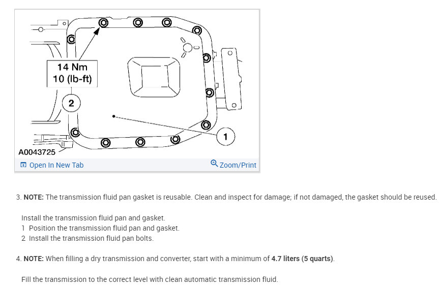

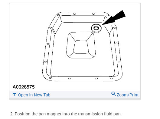

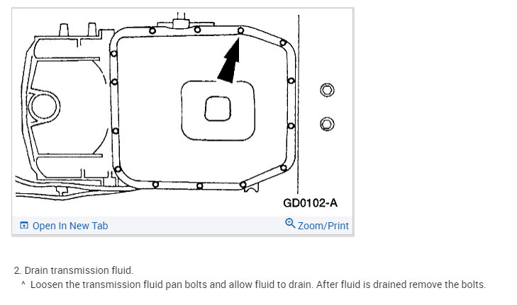

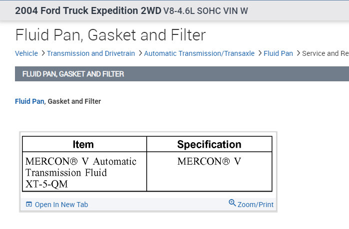

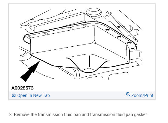

If it is black/brown and smells burnt, the next thing to do would be the removal of the transmission pan to inspect if there are indications of metal shavings, excessive clutch material, and so on. Also, you will be able to see the filter for inspections as well.
I attached the directions below to access the filter. If you remove the pan and see debris, take a few pictures of it and upload them for me to see before cleaning.

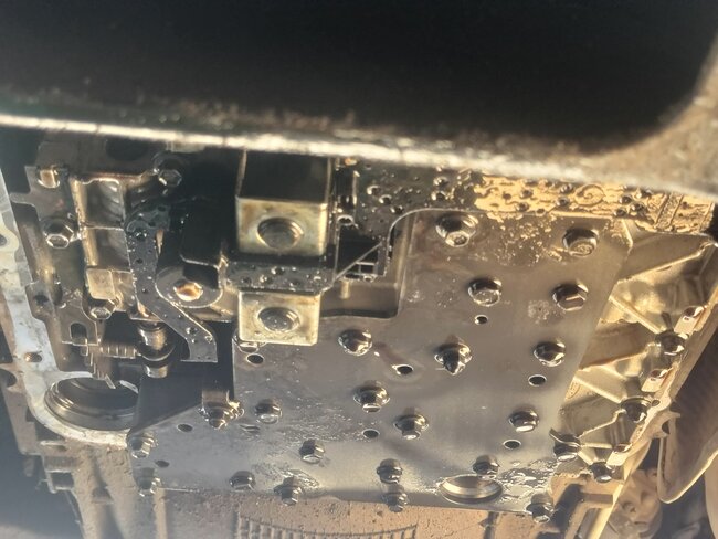

This some.
Apr 22, 2023 at 1:30 AM
  • 110,194 POSTS

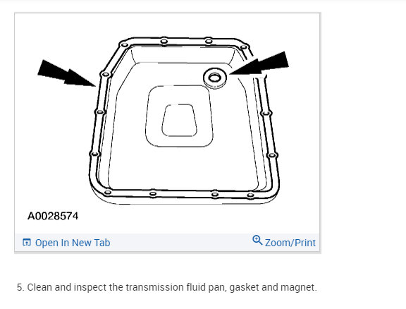

By chance, do you have a pic of the pan itself especially where the magnet sits in it? Did you notice any metal shavings in the pan? Also, looking at your pic, I see places where it appears to be dark color dirt build up. Am I correct? If so, I have a feeling that is clutch material.

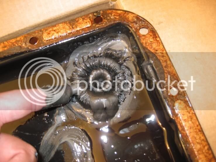

It kind of look like this.
Apr 22, 2023 at 7:57 PM
  • 110,194 POSTS
Is that from your vehicle? That is a mess. If that is clutch material, I feel it likely needs to be rebuilt.

No, that is not my car.
