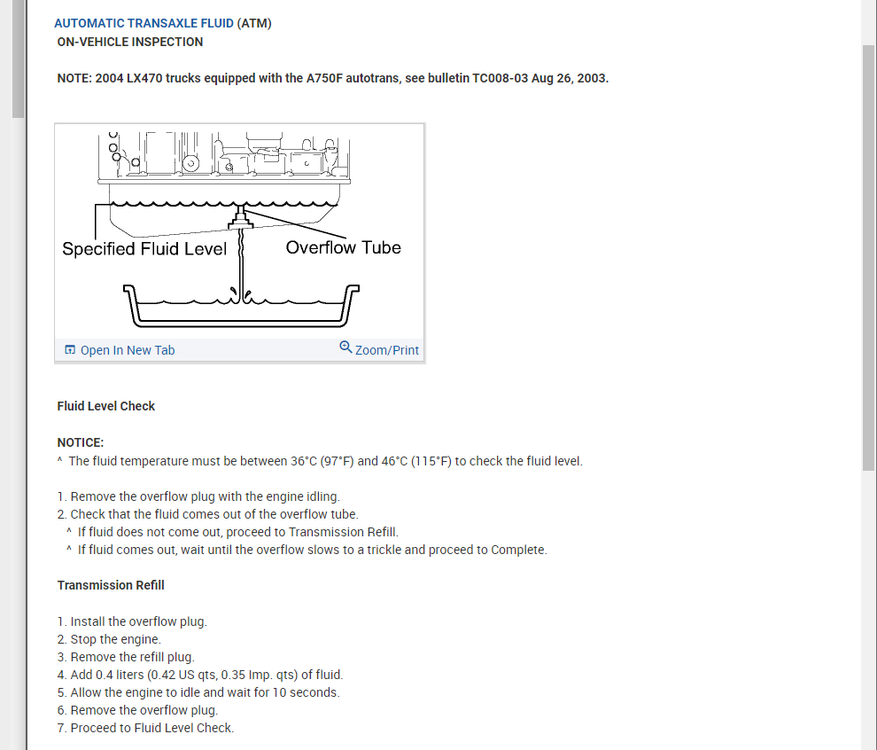

Here is a guide that will help with changing the fluid which will give good info:

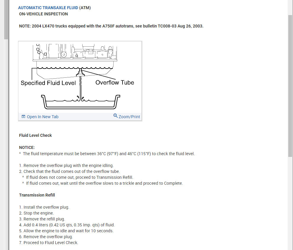

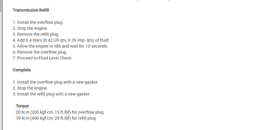

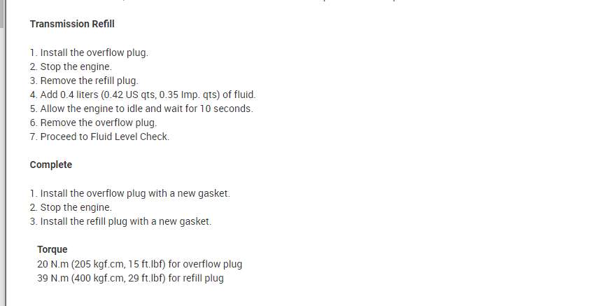

Below you will find the process on how to check the fluid level. You do not have a dipstick so you basically remove this plug in the pan and if the fluid is not running out then it is either low or perfectly filled. So you need to add fluid to it until it runs out of the plug. Then let it stop and replace the plug.
Take a look at the info below and let us know if you have questions and what you find. Thanks
