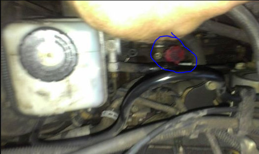

DANNY L
  • 5,648 POSTS
Hello again.
Yes, after draining the transmission fluid it should hold about 6.9 quarts. Yes, your transmission has a fill plug.Look for the red transmission fill cap located in front of the power steering reservoir. I've attached a picture below of its description/location and circled in blue. Let me know after filling to the correct fluid level if the symptom persists.Hope this helps and thanks again for using 2CarPros.

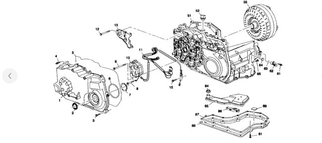

TOUGHDIVER
  • 226 POSTS
Here is something you can try if you are good with a wrench. Know guarantees and its a long shot but it might work. Remove the side cover of transmission it is cast aluminum and just for your info it is GM 4T40-E transmission.
Using GM Brake Clean, or equivalent, in a safe and clean environment (clean aluminum pan) clean the valve body and dry it with compressed air. Now with Clean Dexron 3 squirt the valve body and all other internal parts of the transmission.This may free up a stuck
control valves if there is not to much damage from driving without fluid. Note: do not remove the valve body unless you have a certified Transmission expert to help you! Use appropriate eye protection please.I am including a schematic of the transmission below. Let us know if this helped you and if it fixed it.
Thank you,
Joe Terwilliger
