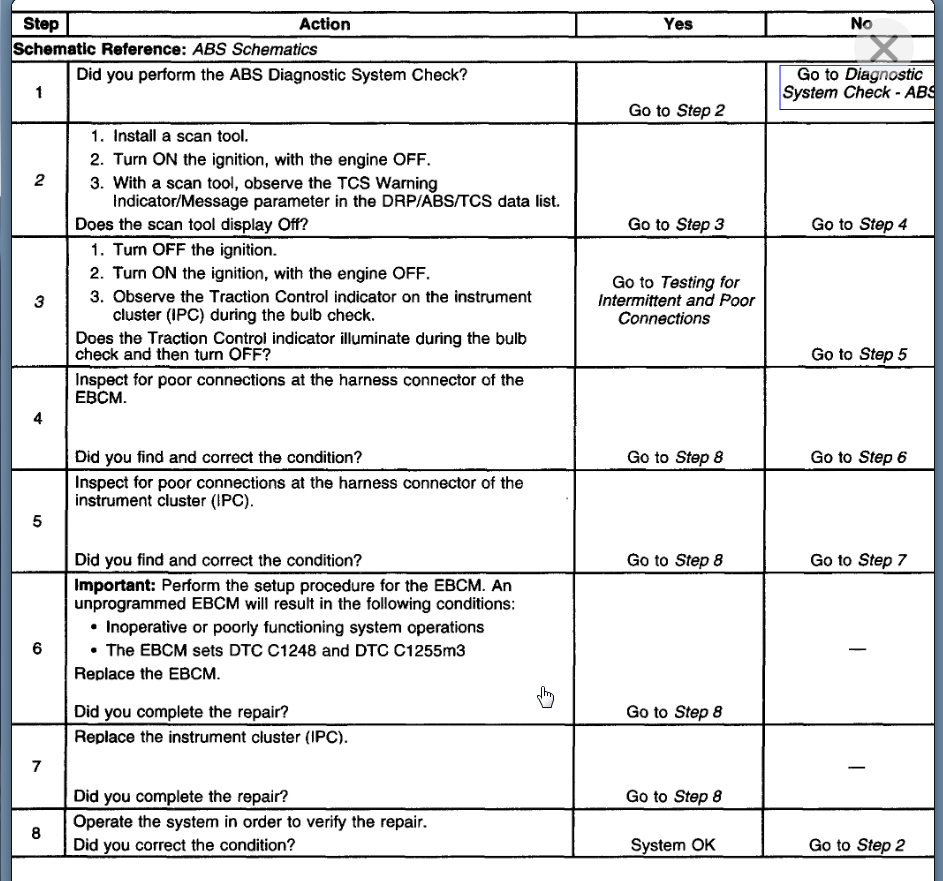

My traction control light stays on.
Apr 9, 2020 at 11:01 AM
This could be a number of things but the only way to know for sure is to get the codes that are part of that system. If you can't pull codes then just stop by a parts store as most of them pull them free of charge. Once we know the code we will have a better idea as to what the issue is and can start testing.

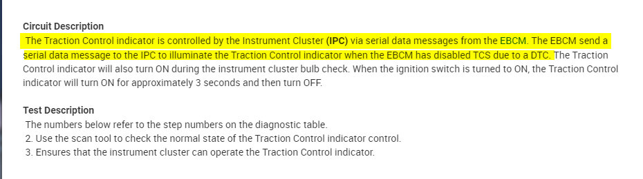

I attached the information about this system. The fact that he found no codes is odd. As you can see in this description, the traction control light remaining on is indicating the system is disabled due to a DTC.
Were there any DTCs in the system? Any for the ABS system?
