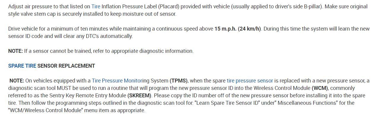

How to reset tire pressure light?
2006 JEEP COMMANDER
114,263 MILES
ABEL ANGEL DOMINGUEZ
Tire pressure light reset.
Jun 26, 2021 at 5:23 AM
Good evening,
I attached a guide for you of the procedure for resetting the light below.
https://www.2carpros.com/articles/low-tire-indicator-warning-light
There are sensors inside each wheel. They can get damaged if tire work was done and care was not taken when removing the tire from the wheel.
I attached the procedure from Jeep as well for you to review.
