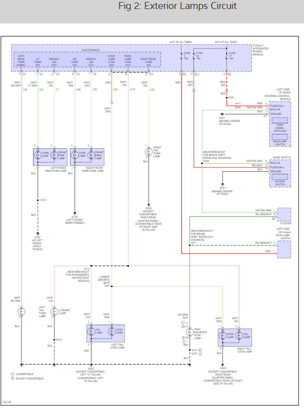

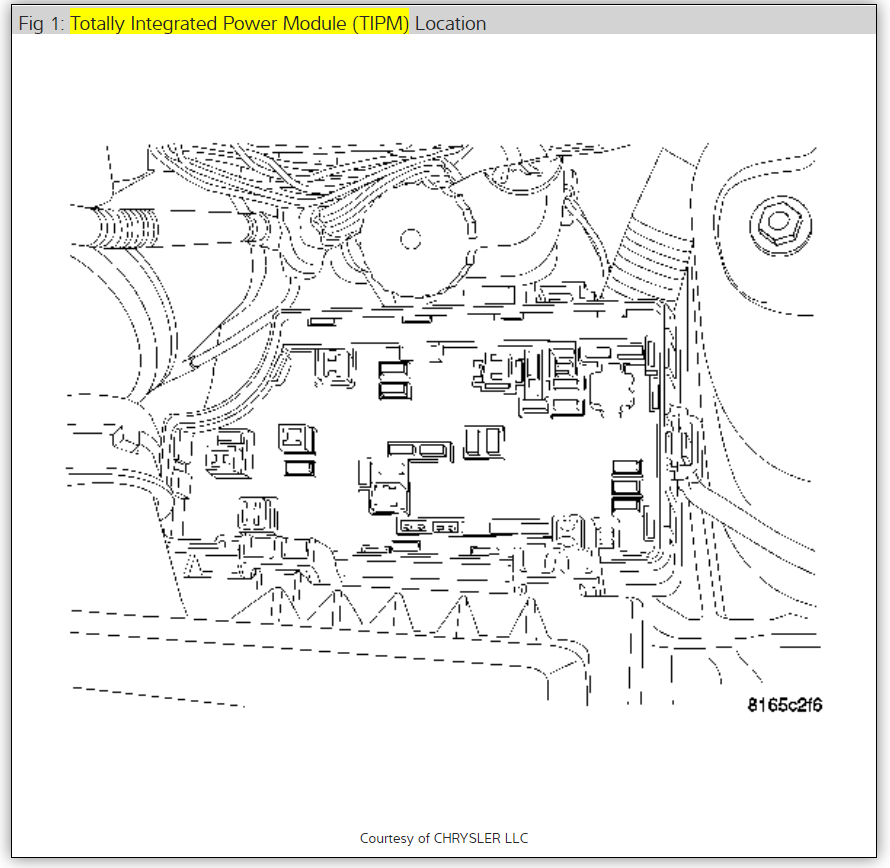

changed everything bulbs, socket's, fuses, nothing worked yet.
Mar 23, 2018 at 3:51 AM
Experienced Mechanic
55,676 POSTS

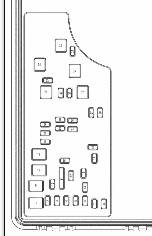

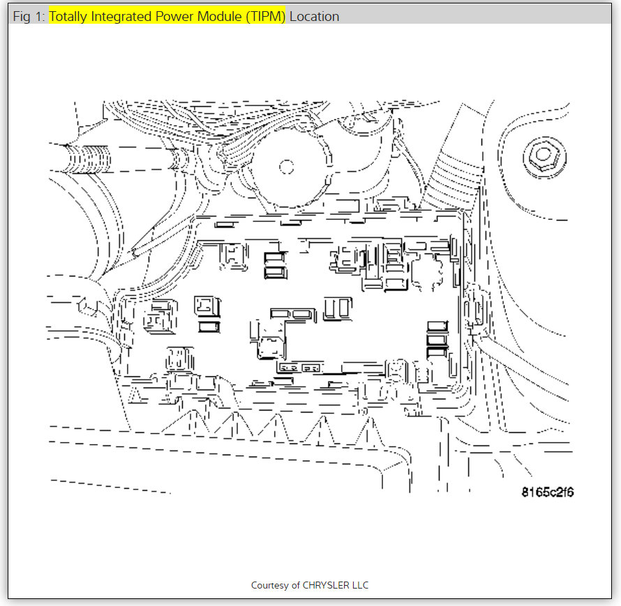

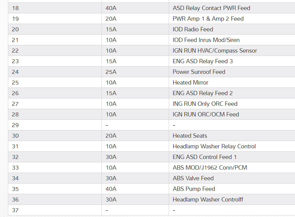

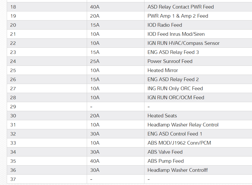

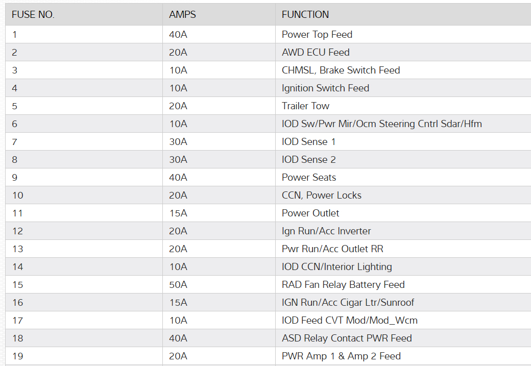

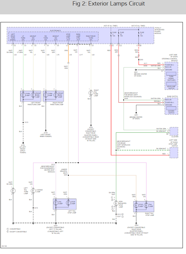

It sounds like the TIPM is out, but to be sure lets test for power and the fuses that run the system. Here is a guide to help you run the tests:
Check fuse 3, 30, and 17.
Check out the tail light wiring diagram (below). Please run some tests and get back to us.

Thank you for this post, I had the same problem and it turned out to be the TIPM I got a new one for $232.00. All fixed, I love this site
