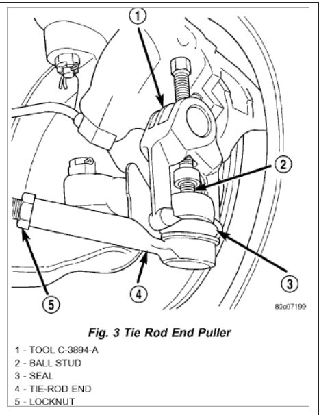

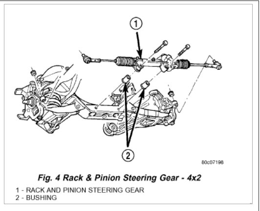

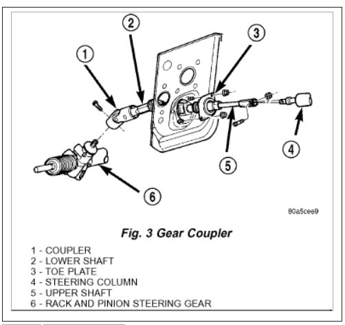

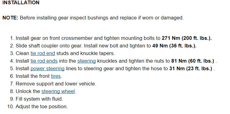

my steering wheel wont turn right!
2004 DODGE DAKOTA
13,000 MILES • V6 • RWD • AUTOMATIC
ALYSSAC98
My steering wheel doesn't let me turn right. It becomes tight and I have to turn with all my strength. My belt is tight and its full of power steering fluid. What else could be wrong???
Dec 8, 2015 at 12:54 AM
  • 55,423 POSTS
It sounds like the steering rack has gone out and needs to be replaced. Here is a video to show you what you are in for when doing the job.
https://youtu.be/KKeFqHLuRQ0
Not the same car and its a box but you get the idea of what it do.
Check out the diagrams (Below) of how it is done on your car
Feb 2, 2018 at 9:52 AM
ALYSSAC98
thank you that did the trick you guys are great!
