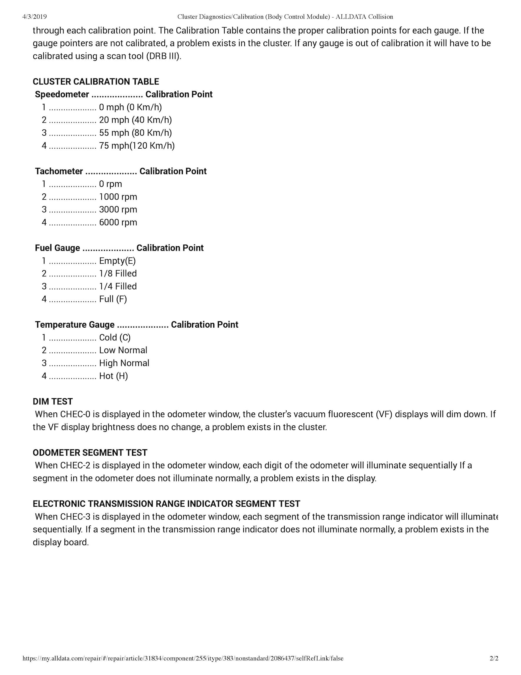

My speedometer stops at 25 mph when at rest. is there way to fix it? do I have to replace a certain part such as a sensor or do I have to adjust something?

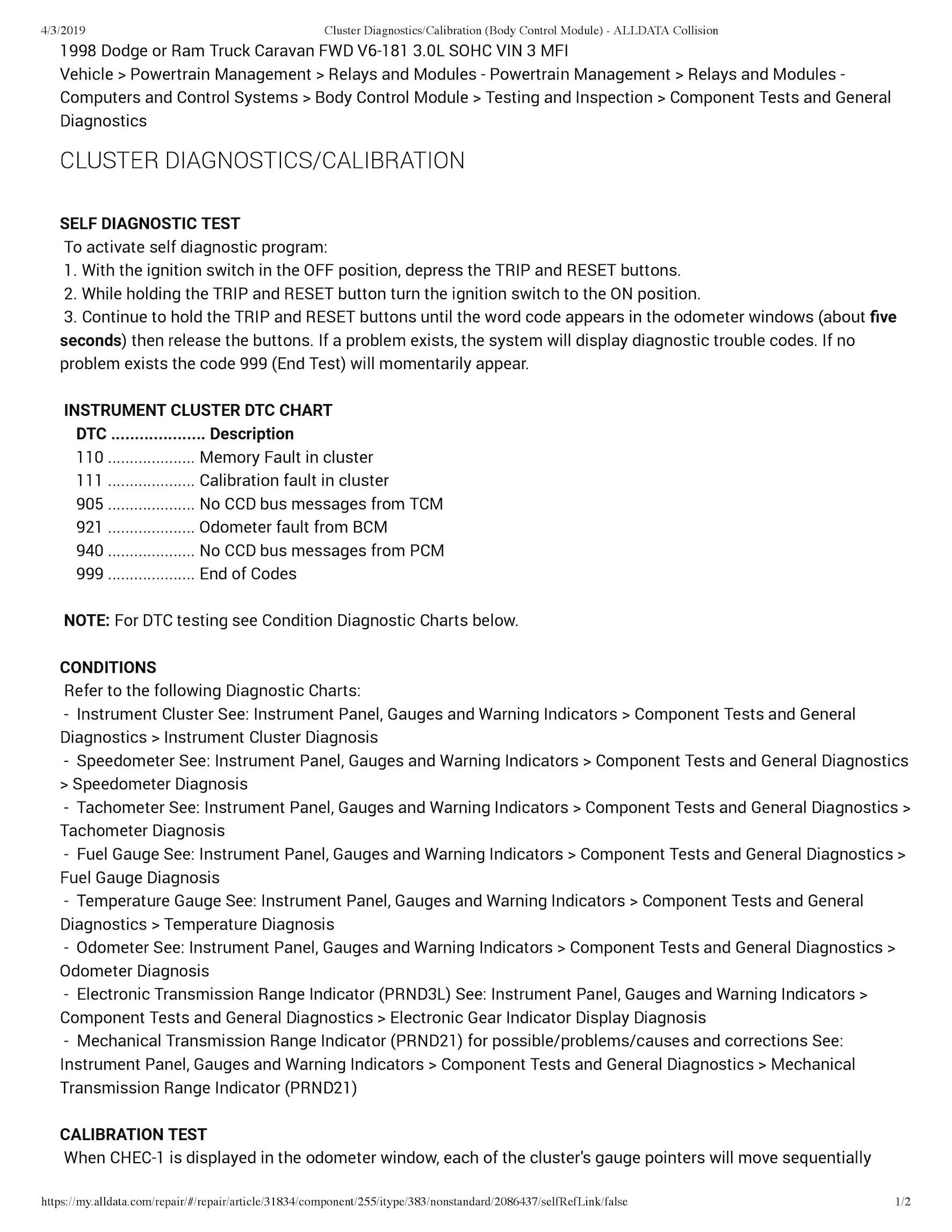

Please find instructions below to carry out a cluster test. The calibration test should run the needle through a sweep of positions from 0mph to the end of the gauge travel.
If you run this test does the speedometer run all the way through the sweep?
