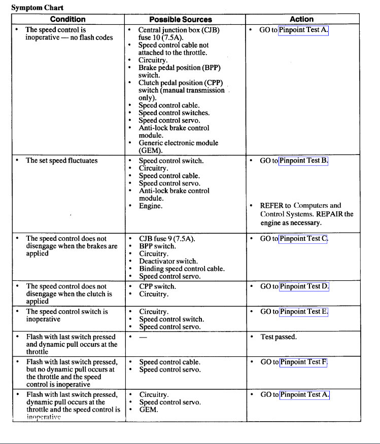

Speed cont light blinks while driving
179,000 MILES
RUBY COLVIN
I don't know why the speed cont light blinks when car is on.
Feb 11, 2019 at 12:23 AM
SCGRANTURISMO
  • 4,897 POSTS

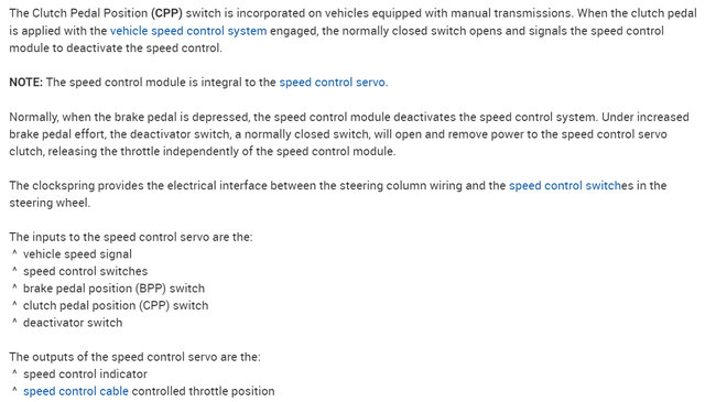

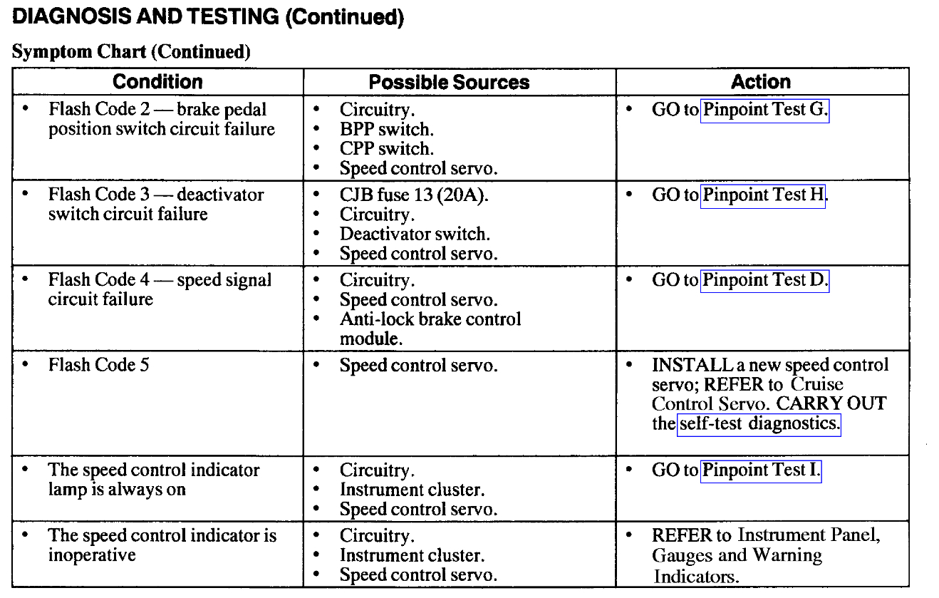

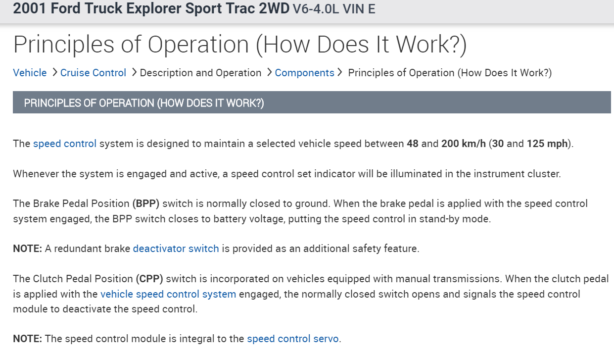

This could be a problem with the brake switch. To be sure though, I have included in the diagrams below, a description of your vehicle's cruise control system and how it works, as well as a troubleshooting chart. Please go through the troubleshooting chart and let me know which of the symptoms listed on it your vehicle is doing. Get back to us with your answer, and we will give you the specific remedy on how to fix it.
