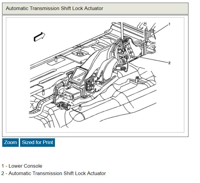

My shifter not going to P sometimes, same times get stuck on P some mechanics say I have to change the shift stick solenoid, this is true ?
Where I can find new?
Aug 27, 2014 at 4:19 AM
HMAC300
  • 48,601 POSTS
he means the shift interlock solenoid needs replacement here is a diagram showing what he is talking about. Their is no adjustment to the shift cable
You can buy one for about $55.00 from the dealer.
