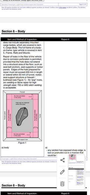

I need my vehicle to pass a safety. Everything is in working order but rocker panel on the drivers side is starting to go on it. Will it still pass a safety because it has a frame and is not unibody?

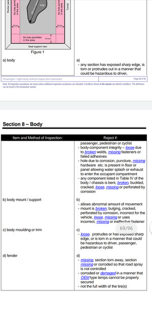

Here is what it say, how would you interpret it? To me it sounds like it's okay.
May 30, 2021 at 9:12 AM
Can you post some pictures?
From the wording, if the rocker is bad with a hole, it is no good.
May 30, 2021 at 9:17 AM
ENVOYOWNER
A portion of the pinch weld underneath has broken. No hole and no fume intrusion inside.
May 30, 2021 at 9:39 AM
Then you should be good.
There has to be a hole that allows gases into the passenger compartment for it to fail.
