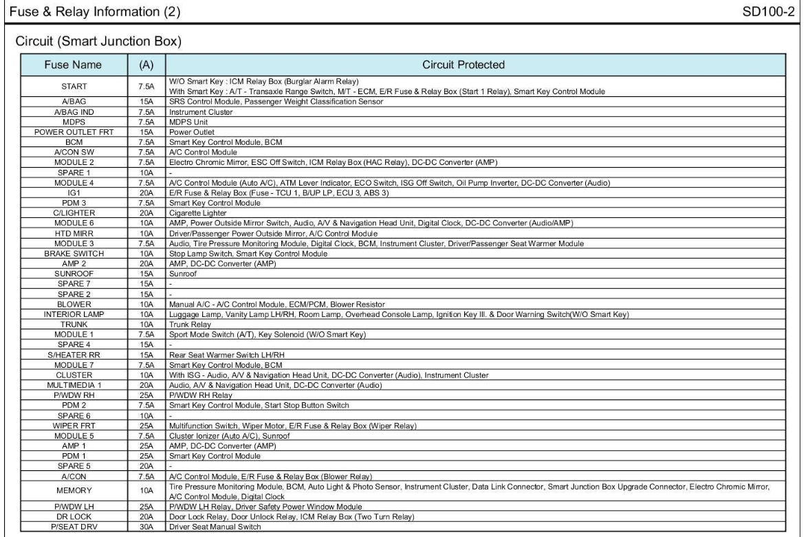

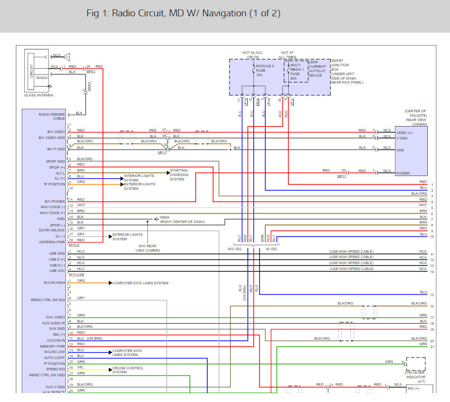

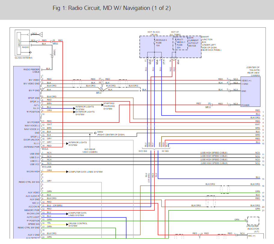

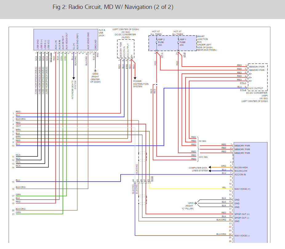

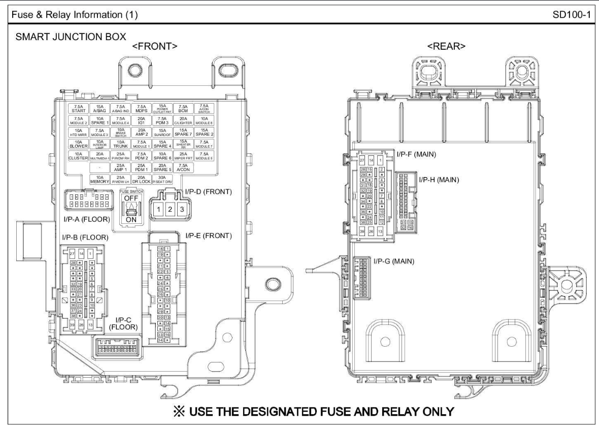

My radio started going on and off at random times and now it’s completely out and won’t come on.
Mar 8, 2019 at 4:07 AM
  • 55,433 POSTS

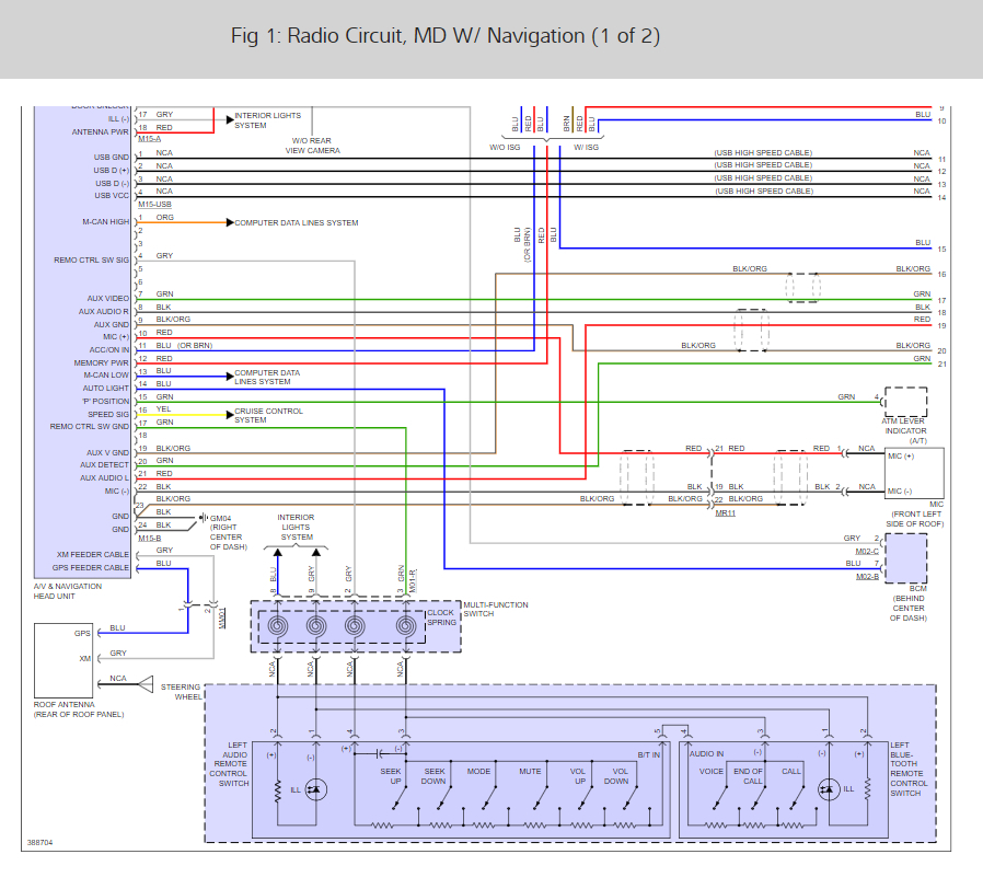

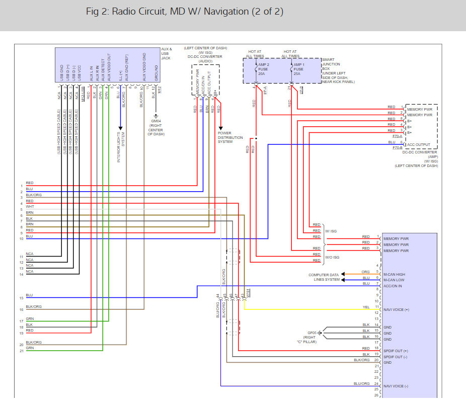

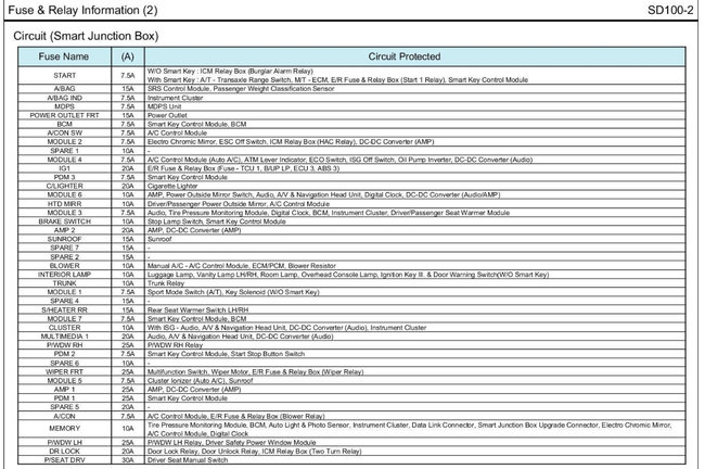

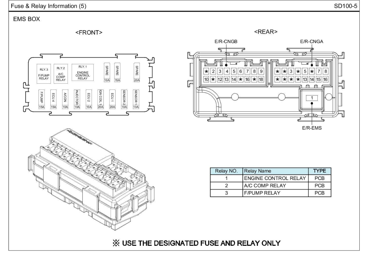

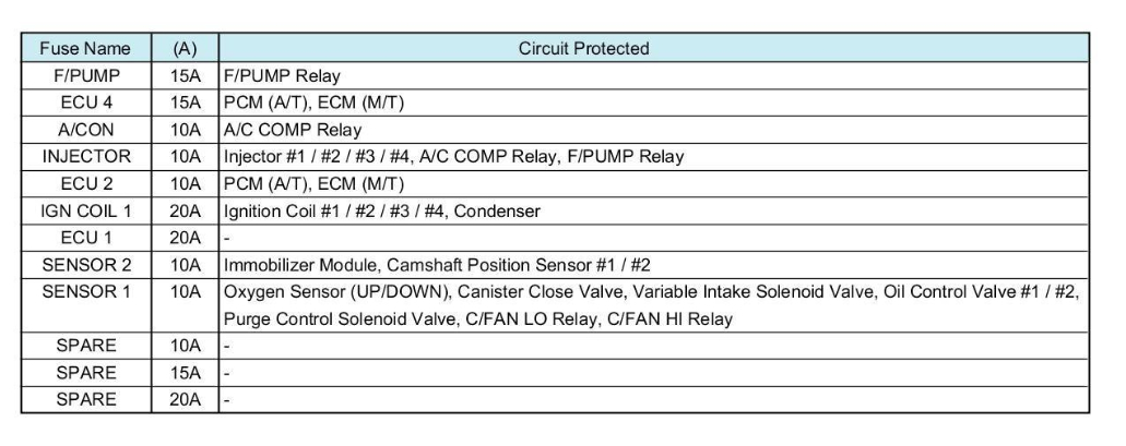

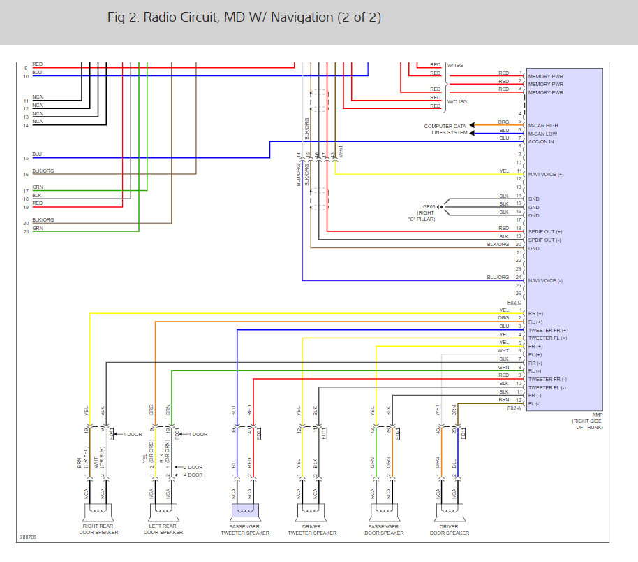

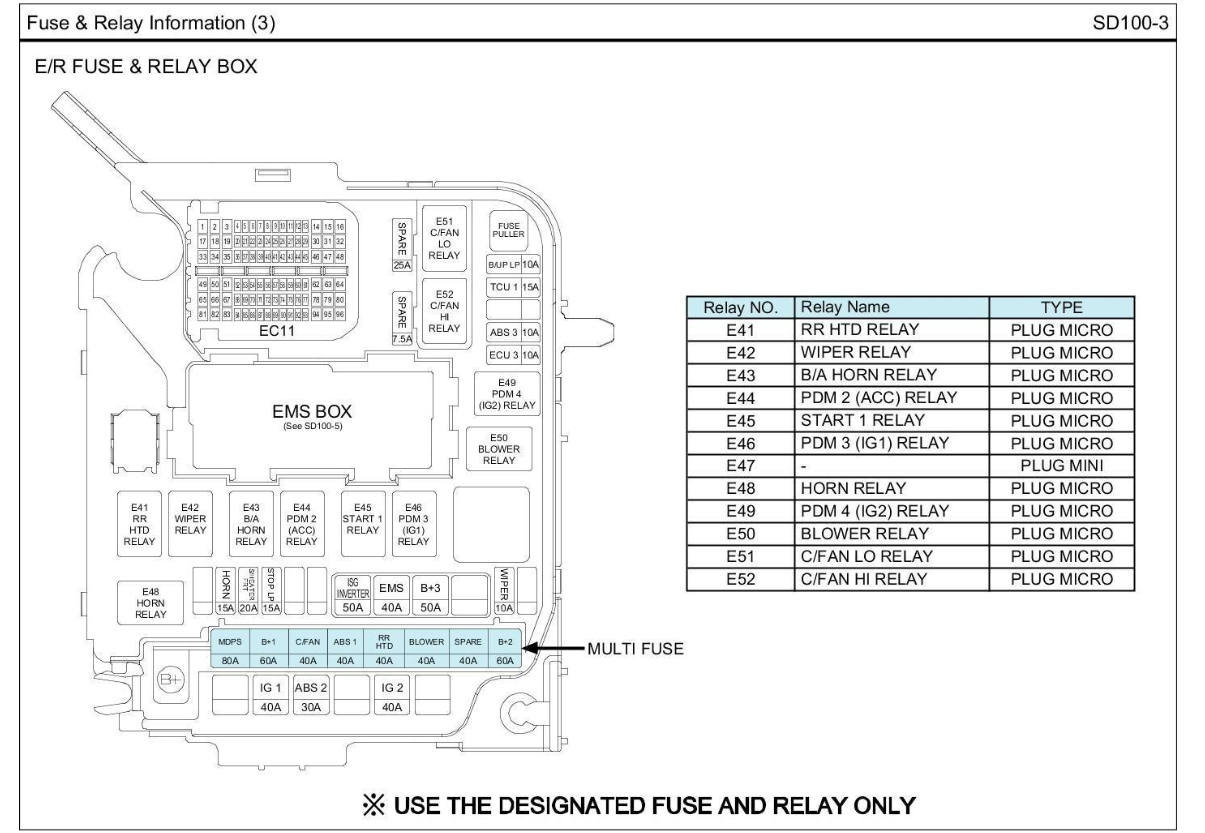

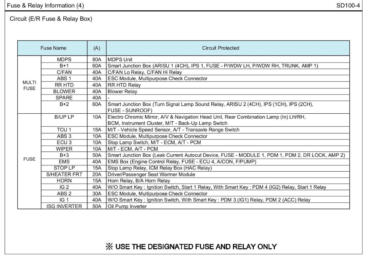

It sounds like the radio receiver has gone out. but to be sure lets check for power at the Module 6 and Multimedia 1 fuses. here is a guide to help as and the fuse location with the radio wiring as well so you can see how the system works:
