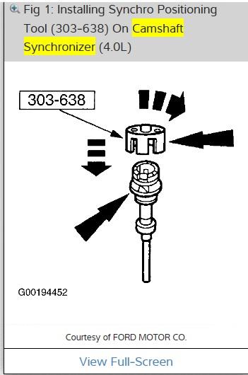

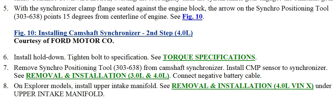

Hi, 2000 Ford Ranger 4L V6 220,000 miles MY VIN: 1FTZR15X3YPC03525
I am installing a new Camshaft Synchronizer Position Sensor
and I am still getting "bucking" and engine stalling AFTER the engine
computer RE-LEARNS, after about 40 miles of new driving. (old codes cleared)
Here are the details about my question:
http://www.discovermoneysecrets.com/camsync.htm
My question is: 0 TDC at the pointer OR 26 degree ATDC at the pointer? Thanks!

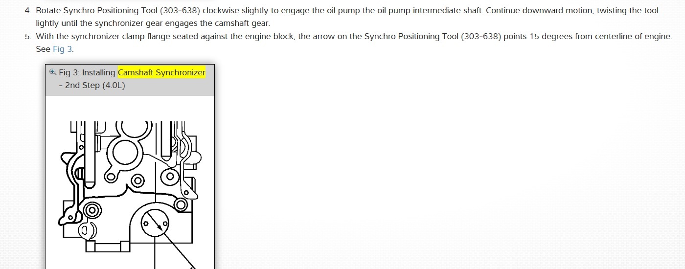

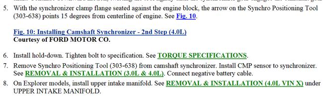

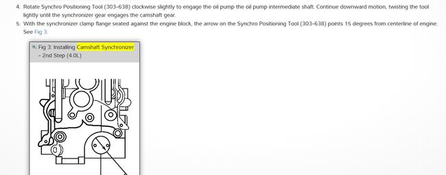

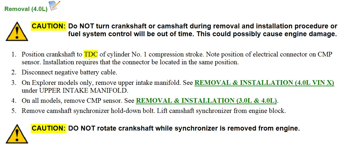

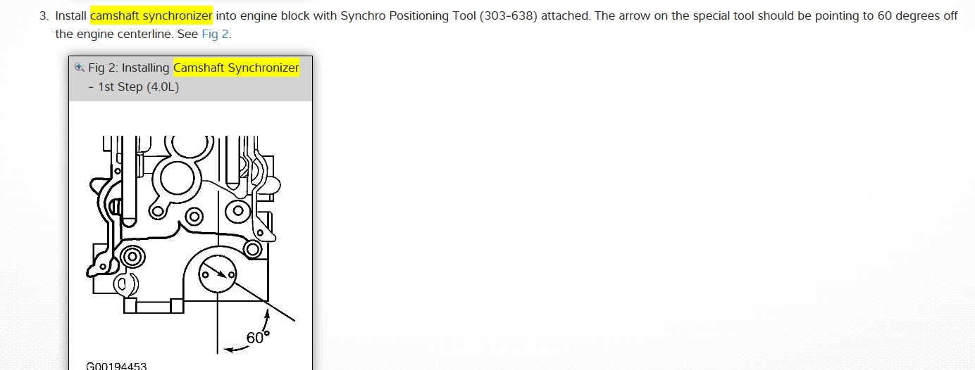

HMAC300
  • 48,601 POSTS

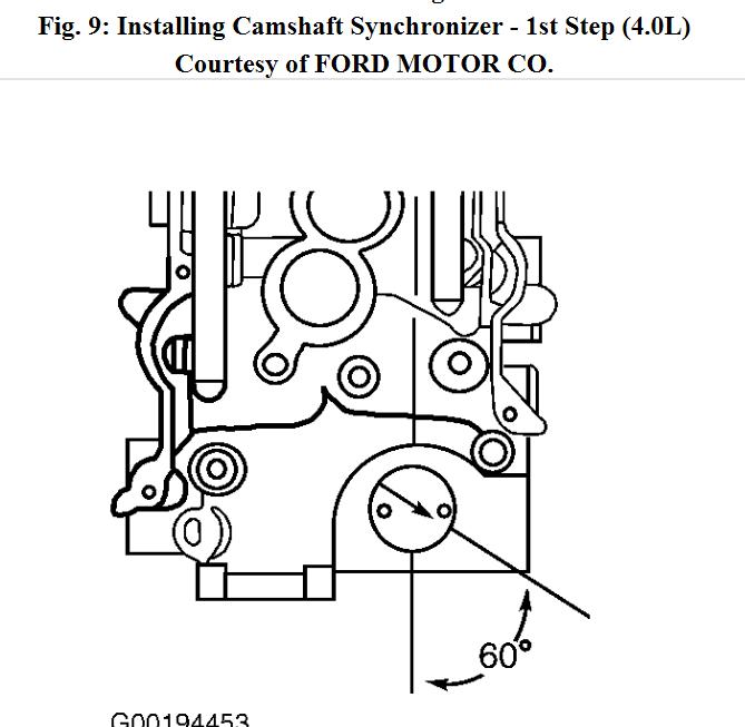

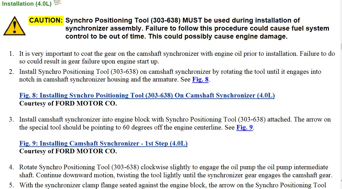

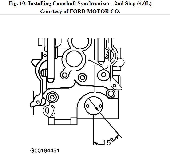

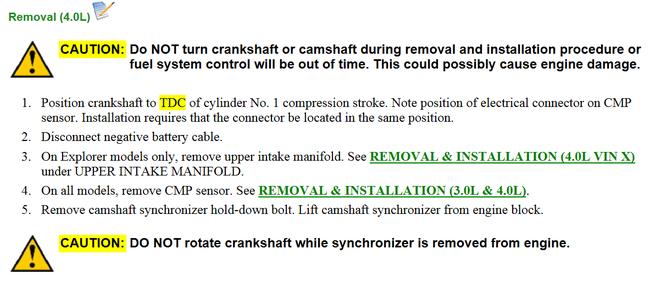

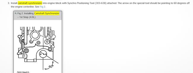

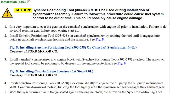

See if these pics will help you out. We are given no indication of where tdc is on this engine not even from ford but if you bring #1 to compression that mark on balancer can be brought up to tdc and should be it. Pics show complete instructions however they are small andi can't reproduce them any larger.

MICHAEL44A
  • 5 POSTS
Thank You for all the research. And the added effort. Here is my question: Before I install the camshaft synchronizer, do I place the engine at 0 TDC mark | at the index pointer OR at the 26 degree ATDC spot at the pointer(of the crankshaft)? Thanks!
Wednesday, September 17th, 2014 AT 11:36 AM
HMAC300
  • 48,601 POSTS
F you read the instructions that I sent it says to place engine at TDC #1 compression stroke. It's in the very first pic I sent in last reply. Use the mark that comes up on balancer
Wednesday, September 17th, 2014 AT 12:31 PM
MICHAEL44A
  • 5 POSTS
Your correct1 I missed that! My bad! Sorry! Thanks for the help!
