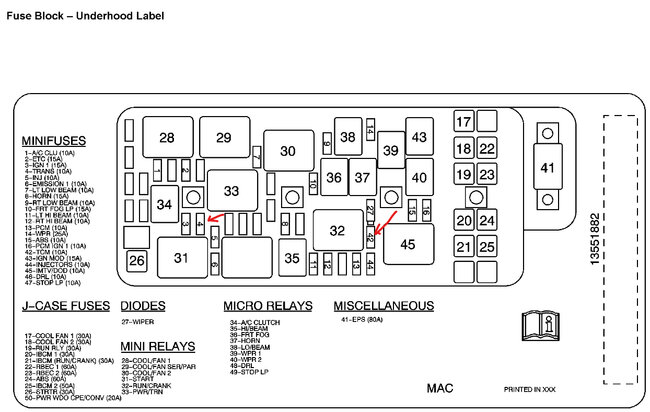

The car will start but the transmission doesn't want to change out put a code reader on it, it pulled up code u0101 and also codes p0013 and code p0016 it's saying error on my speedometer and the radio is saying power steering I have no idea what I need to do the last coat time I put the code reader on it pulled them three codes up plus p0010 and p0017 can anybody please help me I can't afford to take it to a mechanic and running out of things to try.

It looks like you have two problems with this car, please repost the code issues for the camshaft.
U0101: Lost Communication with TCM (Transmission Control Module)
P0013: B Camshaft Position Actuator Circuit (Bank 1)
P0016: Crankshaft Position - Camshaft Position Correlation (Bank 1 Sensor A)
P0017: Crankshaft Position - Camshaft Position Correlation (Bank 1 Sensor B)
We will handle the "Lost Communication" code on this thread. The TCM is powered by the fuses #4 and #42 in the fuse panel under the hood, here is a guide to help test the fuse and how to check for power at the fuse.
Here are the fuse locations as well. Check out the images (below). Please let us know what happens.
