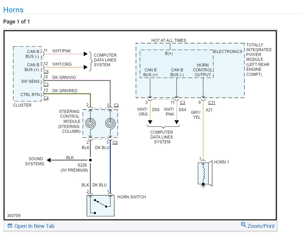

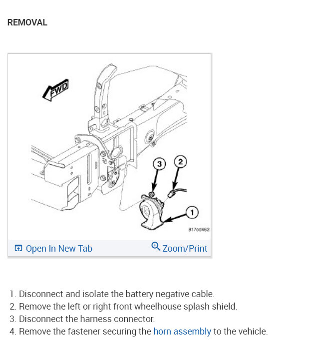

My car is parked in the driveway and locked. All of a sudden, it starts honking on its own. Sometimes it's long horn sounds, but for the most part it's multiple short horn sounds. It happened a few weeks ago, but then stopped. It started again this morning, this time while I was driving my car. I'm taking it into the dealership tomorrow morning because my mechanic couldn't figure it out. However, I need to know how to disconnect the horn. Please help!
Jun 25, 2023 at 10:27 AM
  • 54,840 POSTS

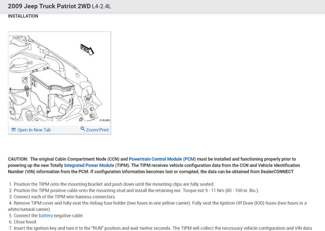

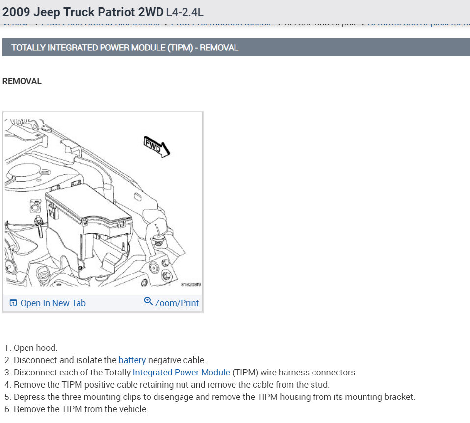

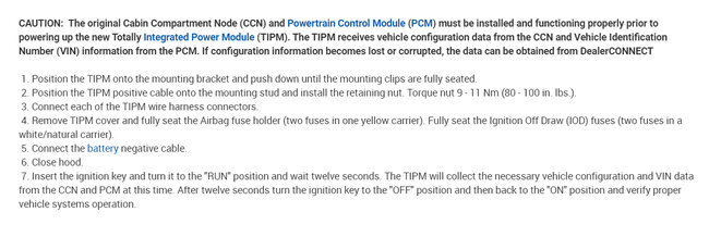

It will probably be the TIPM which goes out all the time in these cars, it is easy to replace because it-self learns. here are the wiring diagrams for the horn so you can see how the system works and the horn location as well. I also have included how to replace the TIPM. To confirm the failure, we should do a CAN scan, you can get a CAN scanner (Controller Area Network) which will work on most cars from Amazon.
