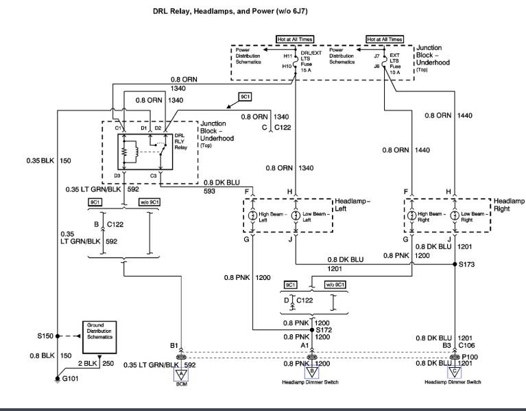

I turn my high beams on and my passenger side high beam not working.

Verify the fuses have power on both sides for the headlights. I attached a diagram for you to view.
Then go to the connector on the lights not working and verify power to the connector. If you do, then check your grounds. If you do not, you have a wiring harness issue.
