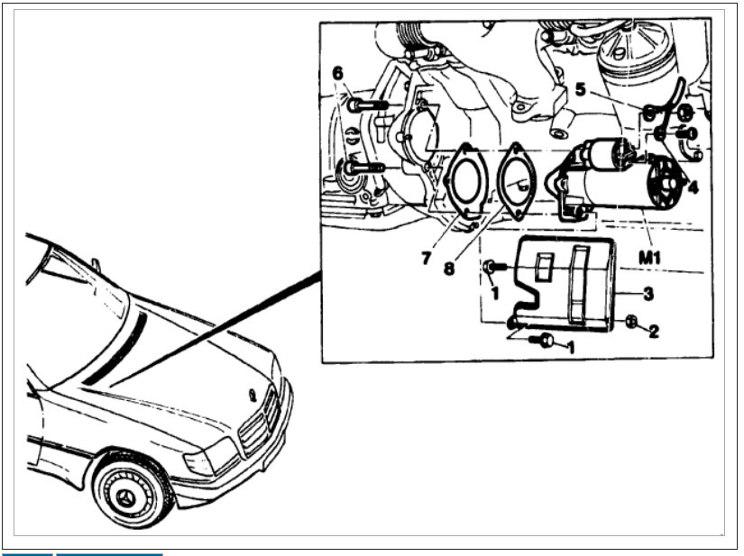

(E300td model) It just turns and turns but does not start. Watch my video: https://youtu.be/eS_lwfVFvCA to help me solve this problem. Thank you in advance

O boy that doesn't sounds good at all. You can upload videos here BTW. Is the battery new it sounds weak or the starter is bad. Here is a guide to help you test the battery.
Please run down this guide and report back

The battery is about 2years now so I didnt think that was the problem. I have no idea about the age of tge starter motor. I had it towed to the nearest mechanic and they couldnt figure out the problem, but when I got it back they had taken a bunch of fuses and drained the coolant. It didnt sound like that at all before it was at the mechanic

It sounds like the engine is hurt or the starter motor is bad.
Here is a guide that will show you what you are in for when changing he starter motor out.
Here is diagrams to help you see what it will be like on your car.
