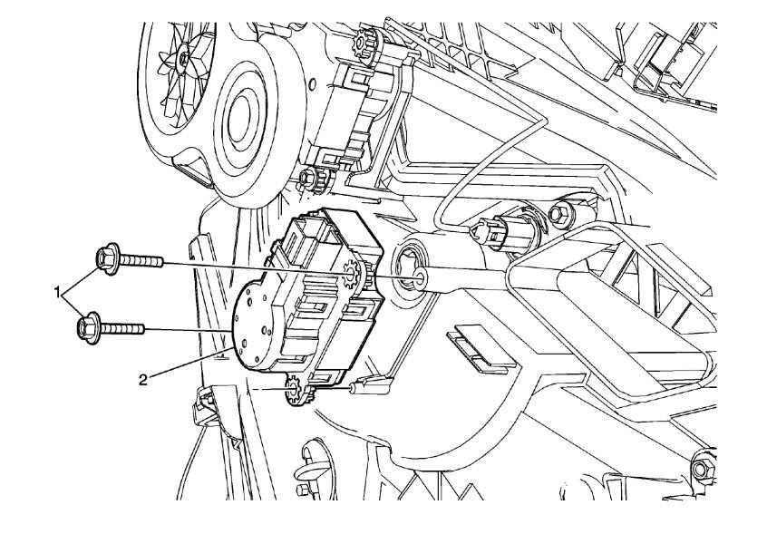

My mechanic fixed a relay on my fan in my car and now my drivers side A/C is blowing out hot air only. It was working just fine before he had to put a new relay to the fan in my car in. What could be the problem with the A/C on drivers side? Thank you.
Jul 10, 2020 at 9:48 PM
Good morning,

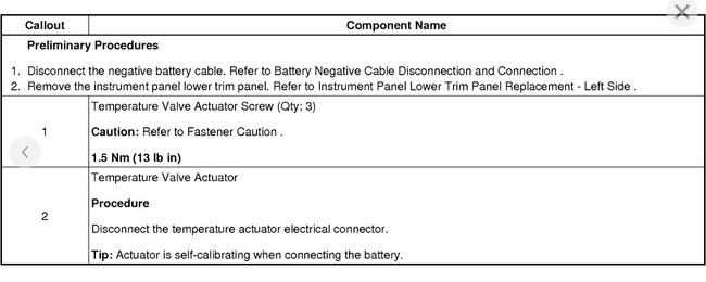

It looks like the blend door actuator is not working. I attached the location and the procedure for you for the replacement.
