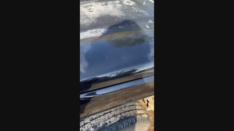

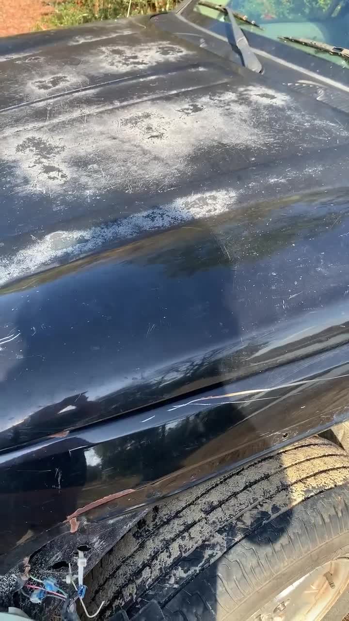

Yesterday as I was driving my vehicle started to run hot and so I pulled over to the side of the road and shut off the engine. I waited for the engine to cool down so that I could add water since I was out of coolant. I proceeded to wait an extra hour and then tried to crank it and it would not turn over. The battery is new and has not drained all the lights and stuff inside the vehicle work. I have been told by several different people that my vehicle is either vapor locked or that the timing chain has broken.

Yep, it sounds like the timing chain is broken or the engine was severely overheated, and it has lost compression, thanks for the video it really helps us see what's wrong. In either case it will be best if you get a new engine with that many miles on it. Here are the instructions on how to do the job and I have included a video of an engine being removed in a similar vehicle so you can get an idea of what needs to be done.
