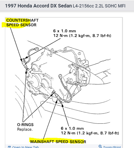

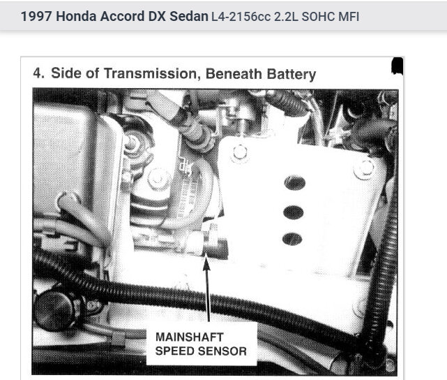

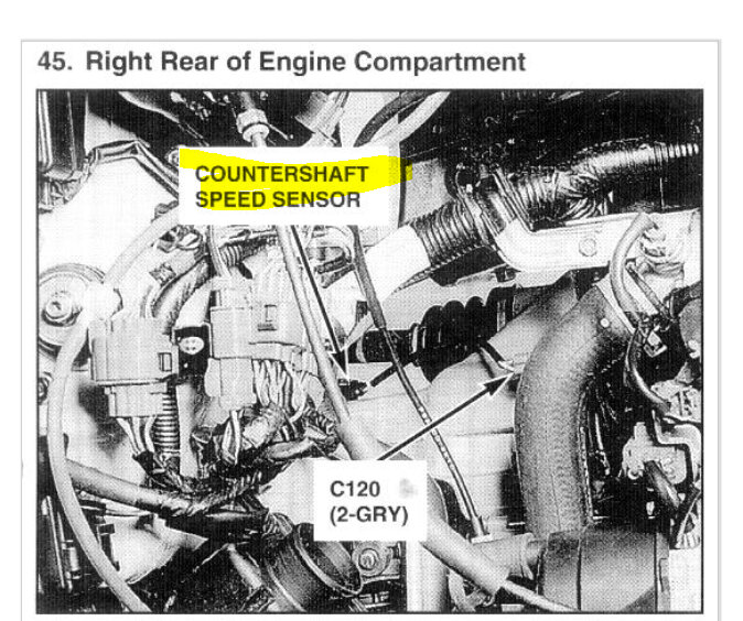

There are two, a main speed sensor and a countershaft speed sensor. I attached pics below showing them and their locations.
Which of these was replaced? Also, do you have the code?

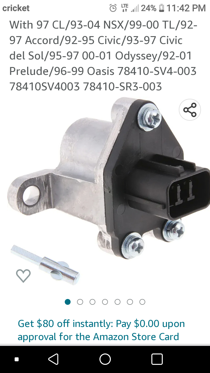

I think the one code was for the has sensor I sent picture of. It probably just wasn't ever erased.
May 25, 2023 at 1:46 PM
  • 110,240 POSTS
That is very possible. Is everything working correctly now?
