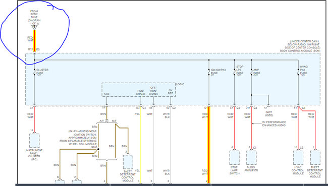

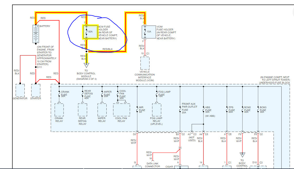

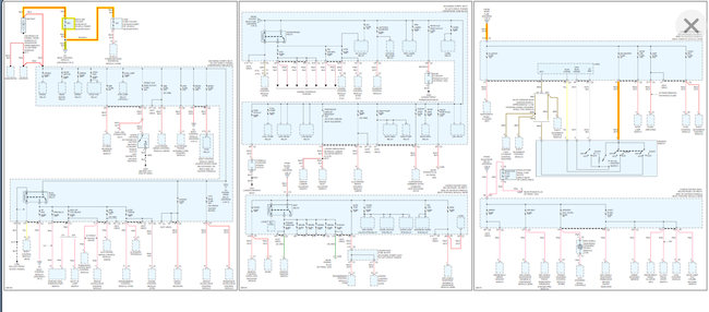

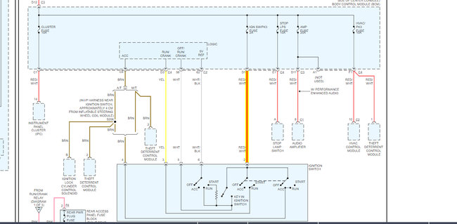

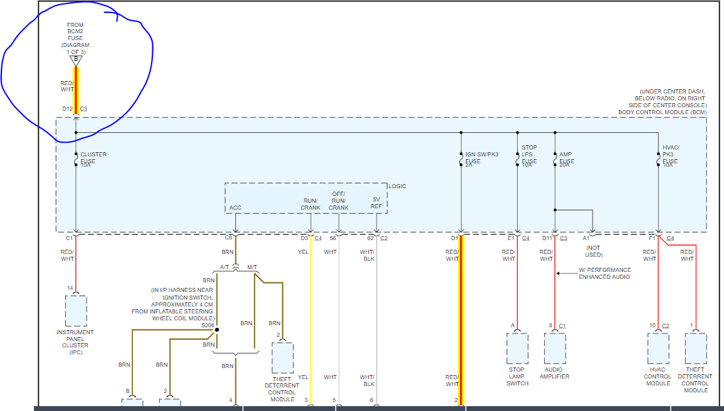

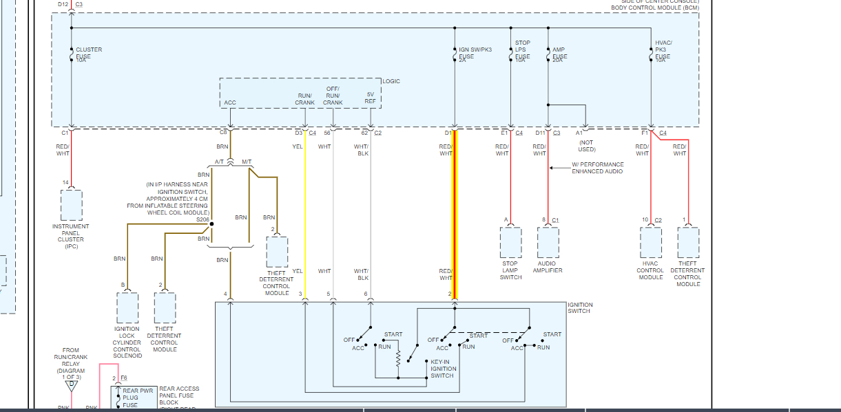

Can you test for voltage to the ignition switch? I need to know if power is getting there.
I also attached some checks for the power. Check the 50 amp fuse at the battery for power on both sides which feeds the BCM.
