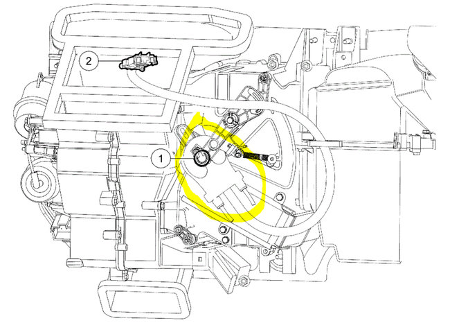

Heater Core Temperature Sensor location. Cannot find the location?
Mar 5, 2021 at 4:59 PM
  • 110,194 POSTS
I don't believe this vehicle has a heater core temperature sensor. I have a feeling you are looking for what is called the blend air door (aka temperature blend door actuator). That is what controls the air temperature entering the vehicle.
The actuator is under the dash on the passenger side. See pic 1 below.
Here is a link that shows in general how one is replaced:
Here are the directions specific to your vehicle for replacement. The remaining pics correlate with the directions.

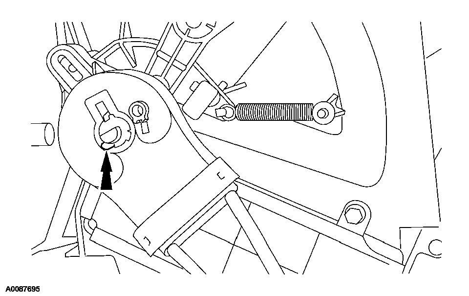

pic 2
Removal and Installation
1. Lower the glove compartment door.
2. Turn the temperature selector to the full cold position.

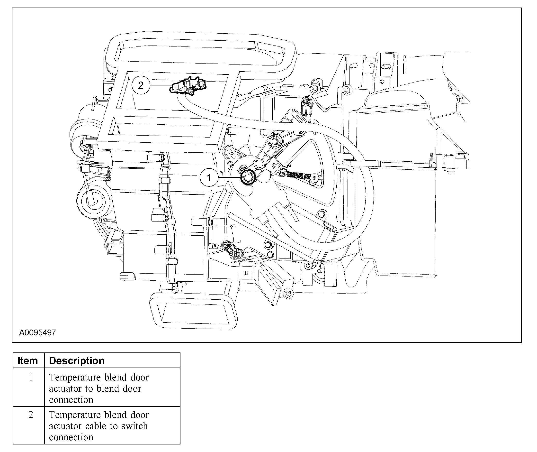

pic 3
3. Release the locking tab and remove the temperature blend door actuator from the blend door shaft.
4. Remove the instrument panel center finish panel.
5. Remove the temperature blend door actuator.
6. To install, reverse the removal procedure.
