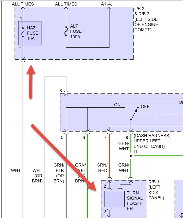

My hazards and blinkers wont work
1998 TOYOTA CELICA
1.8L • 4 CYL • FWD • MANUAL
SCOOBYLOU
MEMBER
1 POST
They just stop working there is no noise at all
Oct 7, 2015 at 1:59 AM
HMAC300
Experienced Mechanic
48,601 POSTS
check items in pic then have multi function switch checked as it may be bad.
