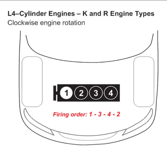

Danny, what is the firing order or cylinder order on my vehicle please?

Hello again.
Here is the information attached below. Hope this helps.
Danny-
