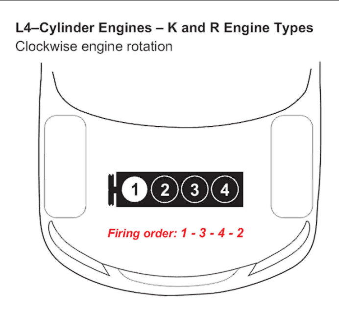

Danny, what is the firing order or cylinder order on my vehicle please?
Jul 10, 2019 at 6:33 PM
DANNY L
  • CAR REPAIR CONTRIBUTOR
  • 5,648 POSTS
Hello again.
Here is the information attached below. Hope this helps.
Danny-
