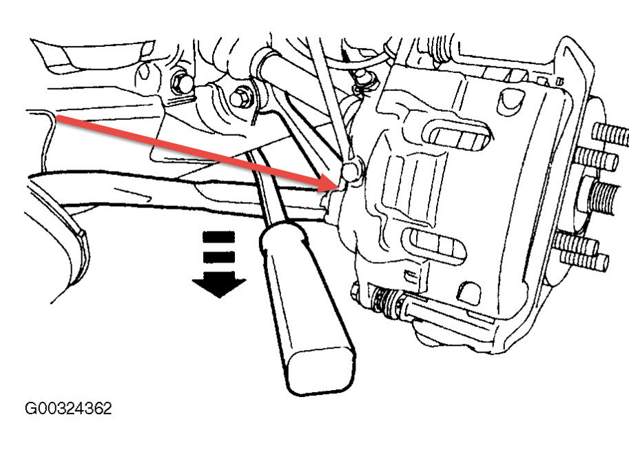

My front right wheel looks cambered positive.
2002 FORD WINDSTAR
250,000 MILES • 6 CYL • 2WD • AUTOMATIC
SERG1224
I was driving home when suddenly I hear a pop noise and then another one, my car starts bouncing and the steering wheel doesent shake but turns back and forth without me grabbing it I manage to get home I park and then get down to look it looks straight but I back up the car a bit and get off again and the front right wheel it looks to be like its cambered but really really positive what broke?

more than likely the ball joint is broken and is NOT DRIVEABLE. have it towed to a garage see pic.
