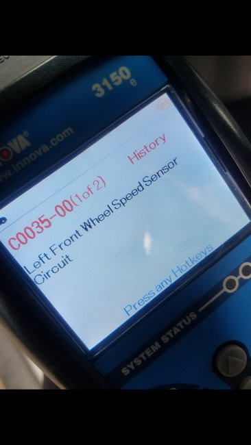

When I stop and step on my brakes I hear a noise and my pedal jumps, like it does not want me to step on it to stop. I got the left brake sensor and bearing changed. Can that be the problem? Please Help.

When the brake pedal jumps do you here a noise like a large clock winding? This would be the ABS kicking in due to a bad sensor which can be caused by a bearing hub going out.

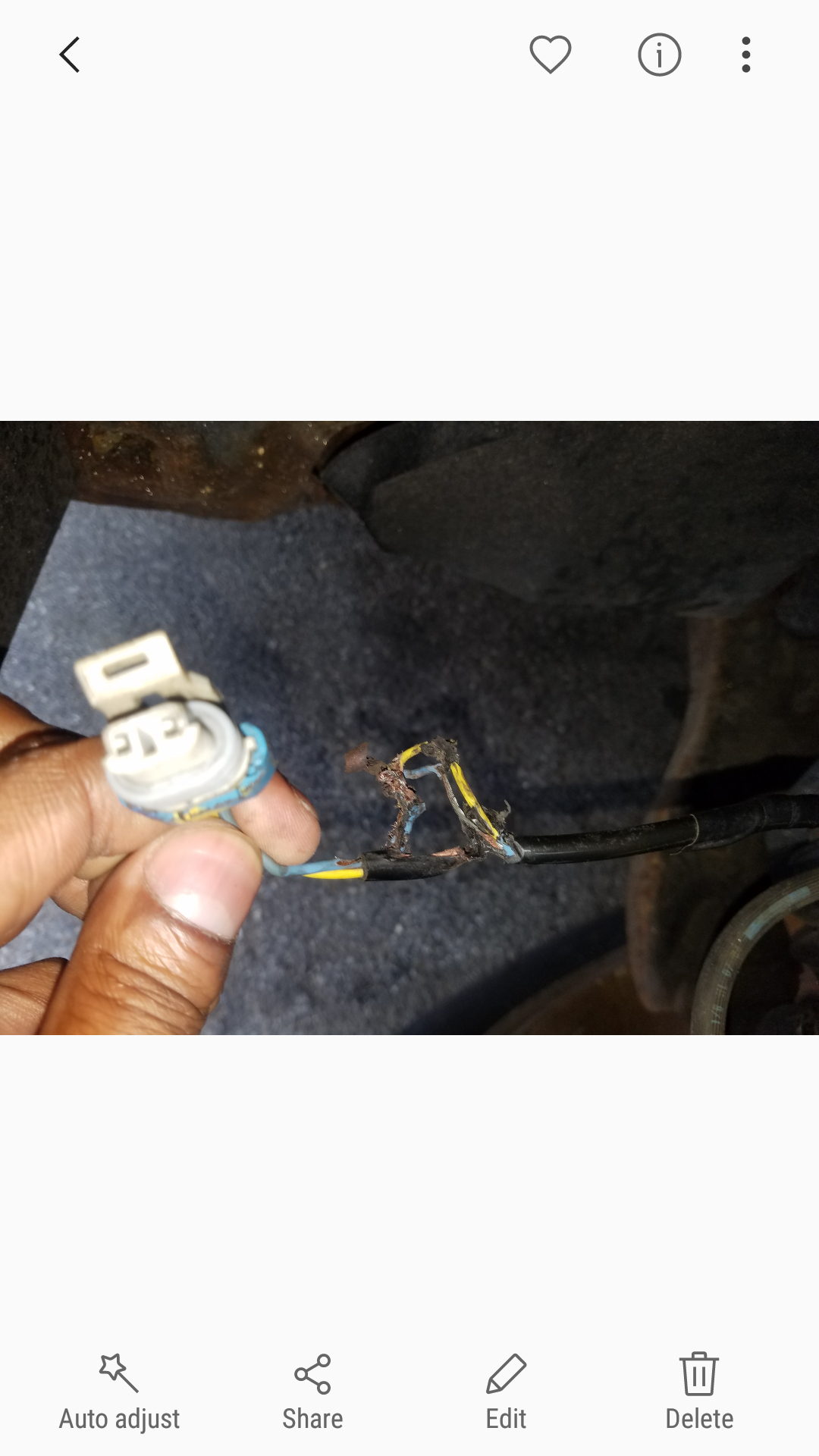

Ken, I think I found out what it is. The mechanics failed to tell me or his work from before when they change the bearing and sensor that my wire was burnt. I have to take back to them I think this is the problem.
Apr 12, 2021 at 11:00 AM
GR52VEY
  • 9 POSTS
And I think this was the problem from the beginning Ken and I paid for a whole new bearing and sensor because it said this.
  • 55,748 POSTS
Yep, you found the problem, nice work. Use 2CarPros anytime, we are here to help. Please tell a friend.
