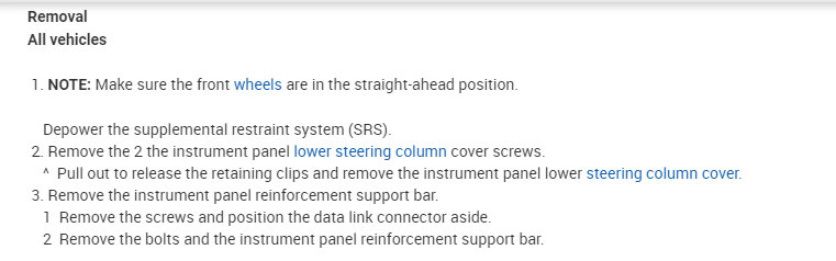

I just put a steering column and a new starter in my car. The lights in the horn and everything is working but it's not starting, it's not clicking it's not doing anything.

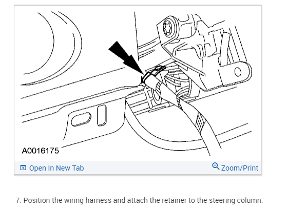

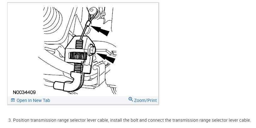

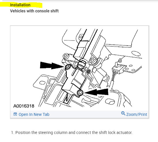

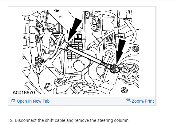

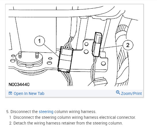

When you place it in park, does the gear indicator show the correct position? Have you tried to see if it will start in neutral?

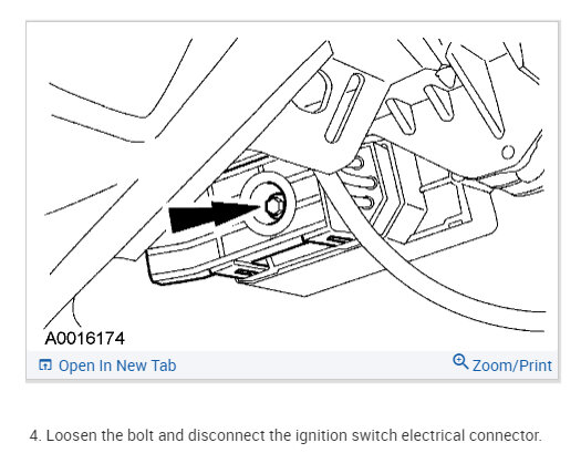

If I had to guess, either something isn't fully connected at the ignition switch or maybe even a pin was bent when you connected it.
When you turn the key on, do the dash lights turn on normally?

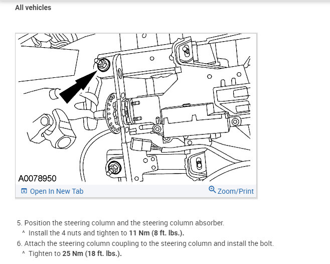

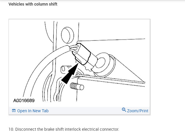

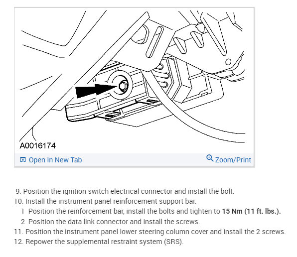

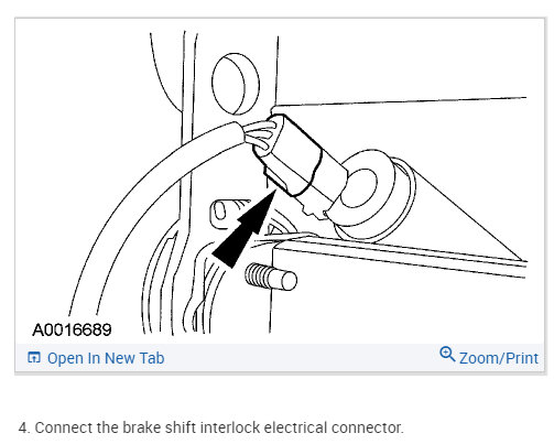

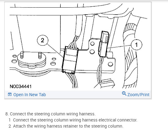

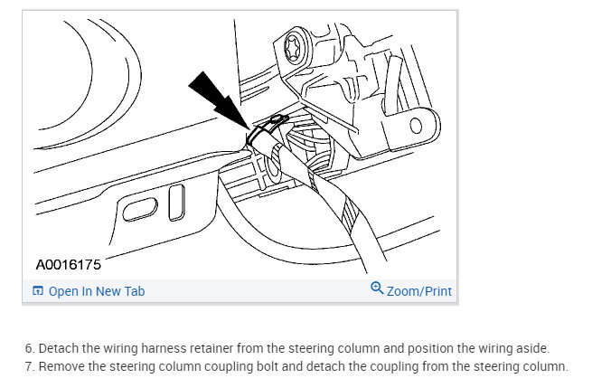

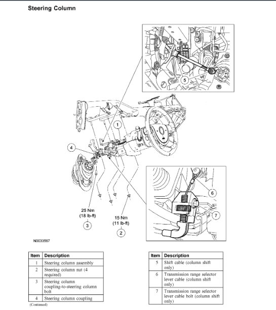

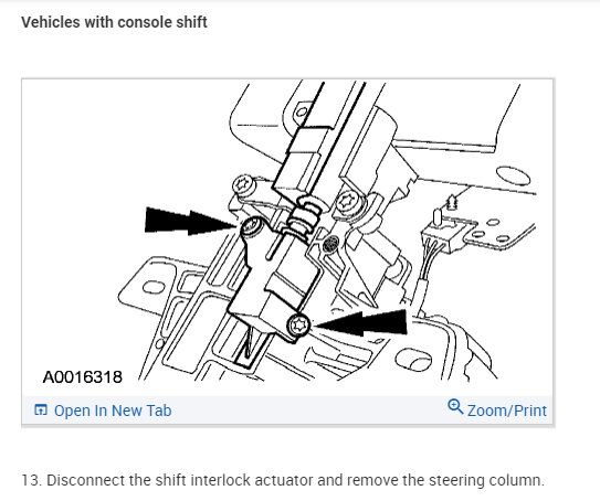

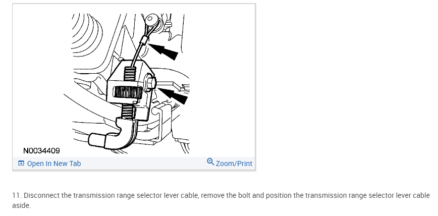

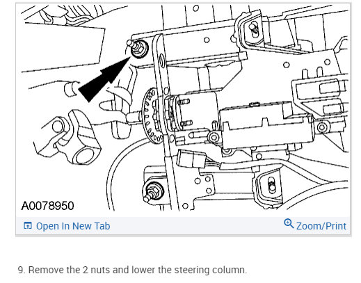

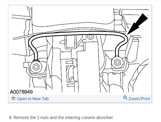

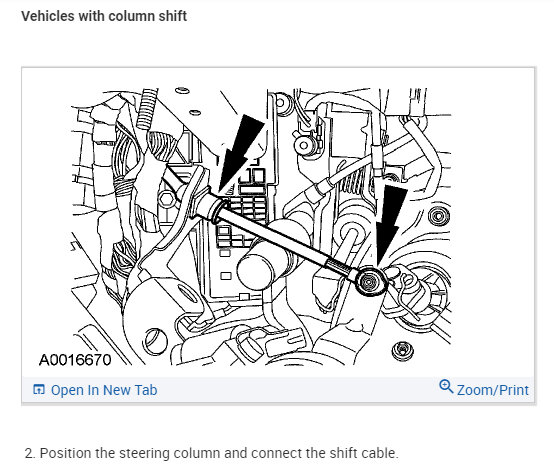

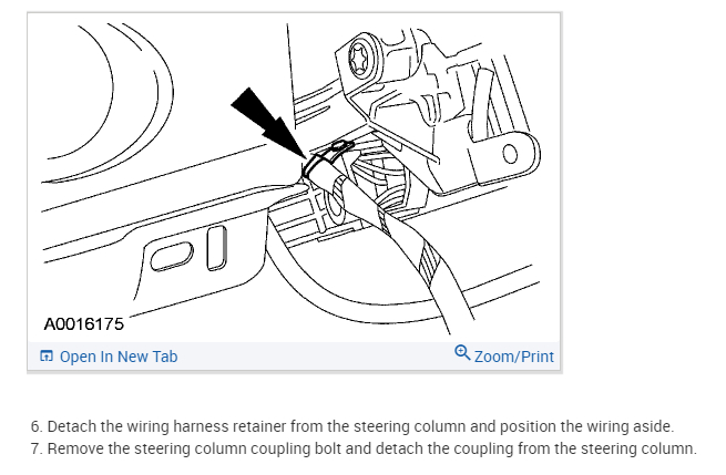

Do me a favor. I attached the directions for the removal and installation of the steering column. There were two different designs, floor mount shifter and column mount. Both are included. Take a look through the directions and see if there is anything you may have missed.
Let me know what you find.

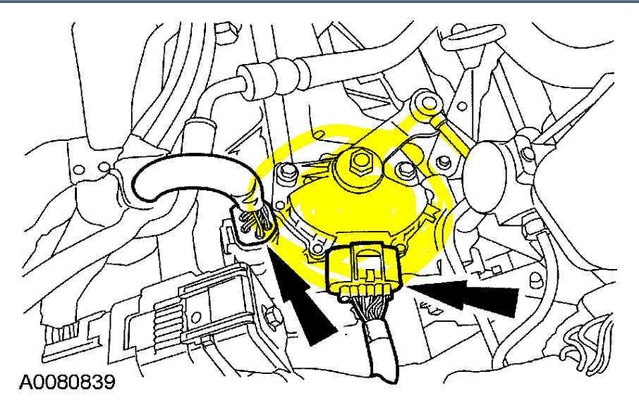

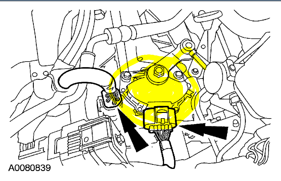

It really sounds like the shift linkage is off. I need you to try something for me.
Open the hood. Under the battery/battery tray is where the transmission range sensor is located. Have a helper shift through the gears while you watch to make sure that it is moving.
I attached a pic and highlighted the trans range sensor to help locate it.
See pic below.
