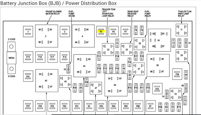

When you turn the A/C on, does the engine cooling fan turn on as well? It should. Pay attention to that first.

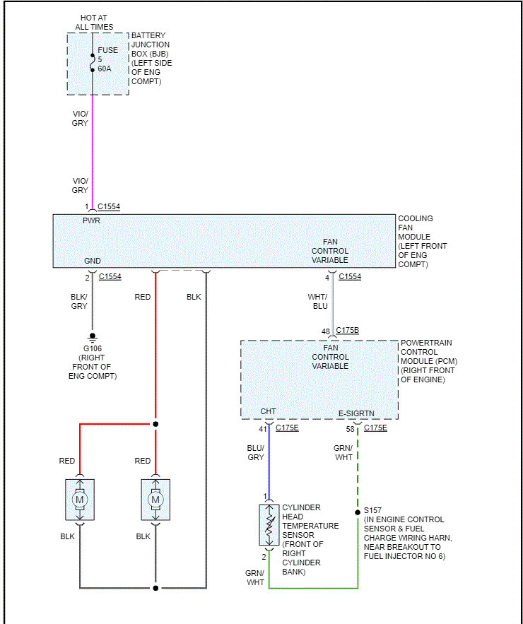

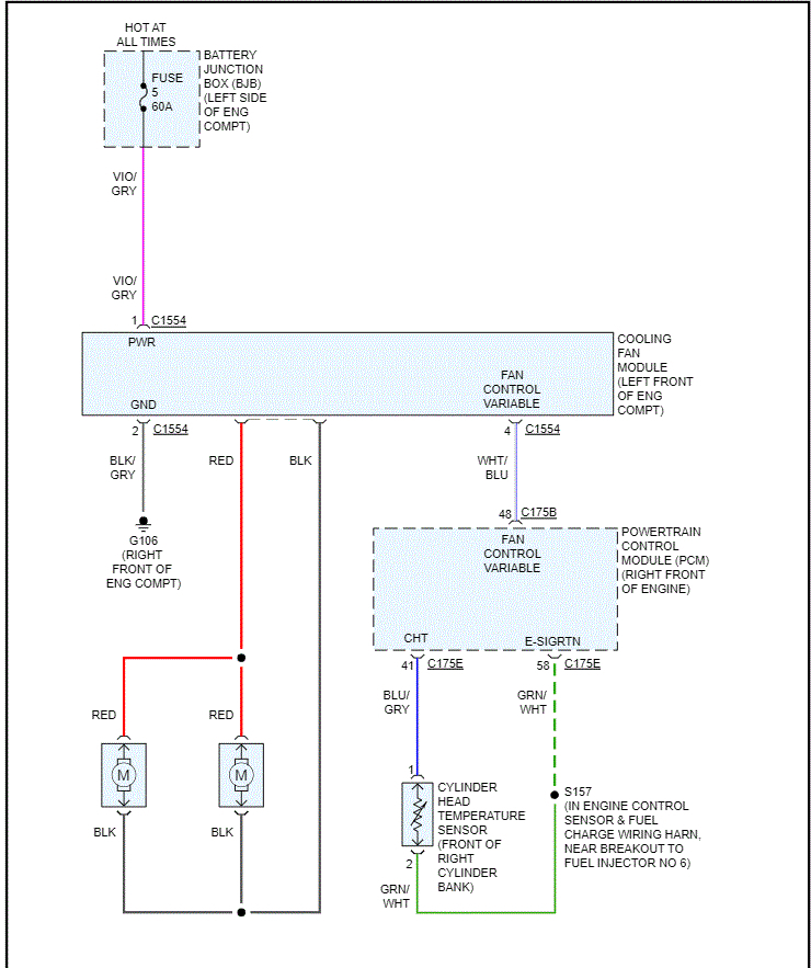

Also, I attached the wiring schematic below of the radiator cooling fans. If they aren't working, check fuse 5 in the under-hood fuse box.

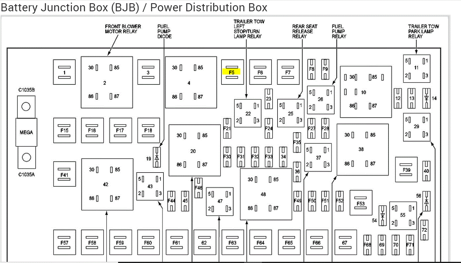

Pic 2 shows the fuse to check. In addition to checking the fuse, confirm there is power to and from it. Here is a link you may find helpful:
Let me know what you find. Also, let me know if the engine overheats while operating at highway speeds.

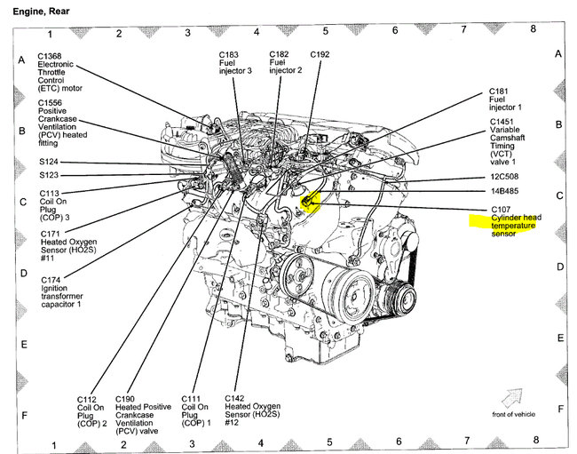

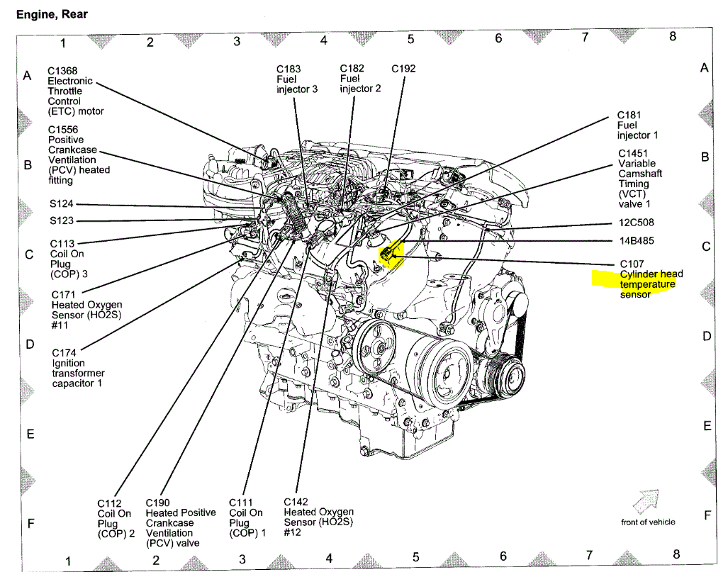

When it overheats, if you were to pull over and check it, do you hear coolant boiling or see steam from the radiator or reservoir? Also, have you replaced the cylinder head temperature sensor (CHT)?
Let me know. Years ago, this type of overheating could have been caused by an ignition timing issue. If it was over-advanced too far, it could overheat. But your vehicle's timing is controlled by the powertrain control module (PCM).
I'm starting to question if it could be an electrical issue causing a voltage change from the sensor when the A/C is turned on. It's only a theory at this point but is certainly a possibility. That is why I'm asking if there is true evidence of the engine overheating and not just the temperature gauge showing a high temperature.
I attached a pic below showing the location of the sensor. Disconnect it and inspect the connectors. Make sure there is nothing that can cause a problem such as a damaged pin, corrosion, or the plug is loose.
See pic below.
