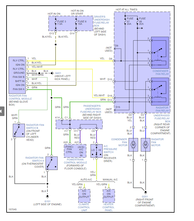

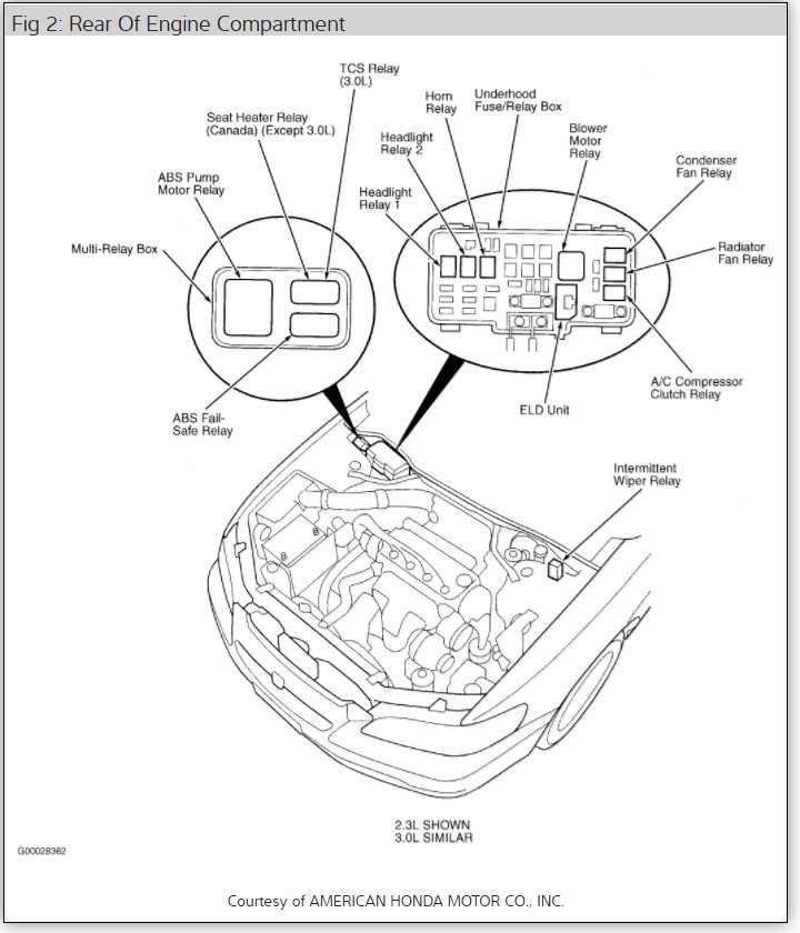

When I turn the switch my fans turn on but one I crank it up the fans stop. I bought new fans and radiator.
Jul 29, 2022 at 9:38 AM
  • 55,273 POSTS

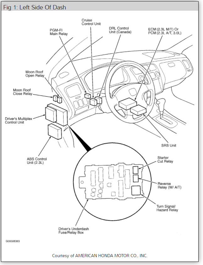

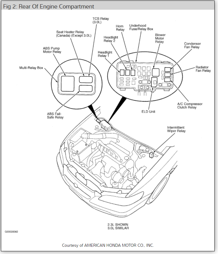

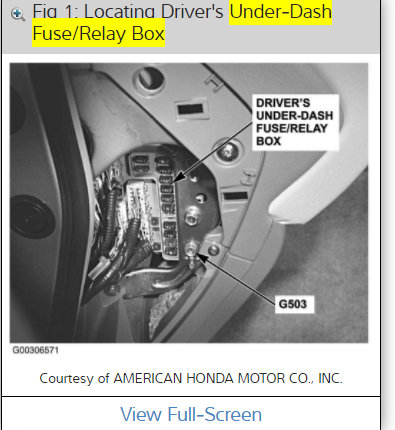

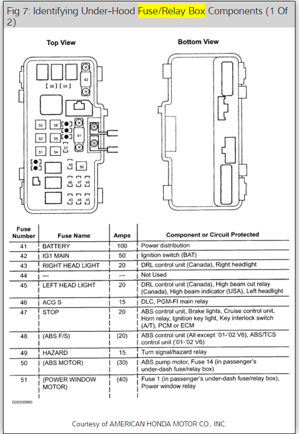

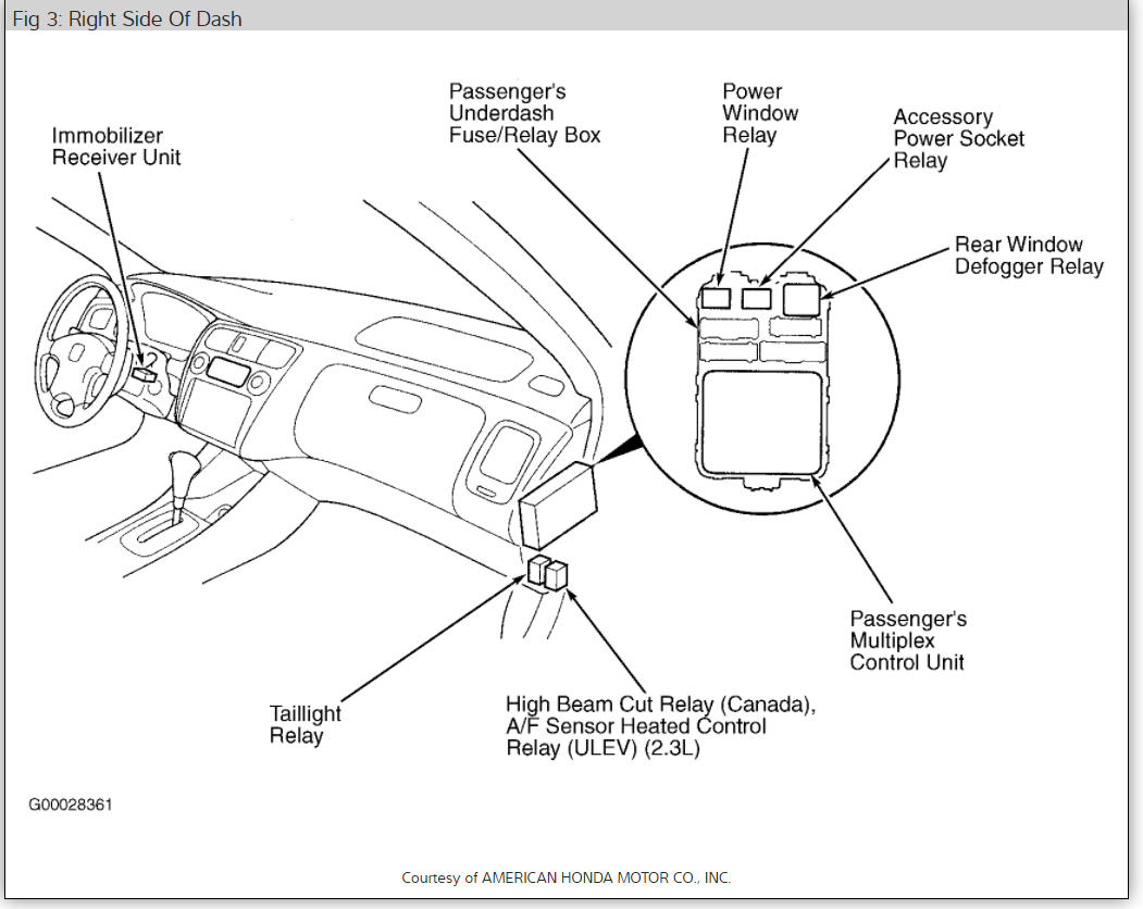

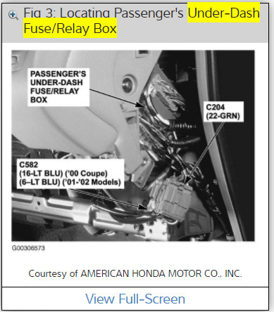

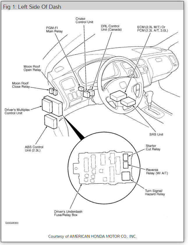

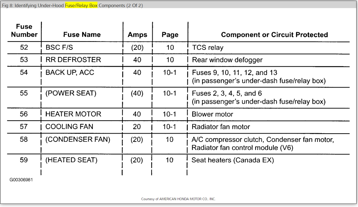

Do the fans come on with the air conditioner? The fans will run when the key is on and then shut off if the engine is not up to operating temperature at which point, they will cycle to maintain the correct temperature. But we should check the system fuses #3 and #6 in the under-dash fuse panel and fuse# 57 and # 58 i the under-hood panel to make sure everything is okay. Here is a guide and the fuse locations in the diagrams below:
Also, I have included the fan wiring diagrams so you can see how the system works. Check out the diagrams (below). Please let us know what you find. We are interested to see what it is.
